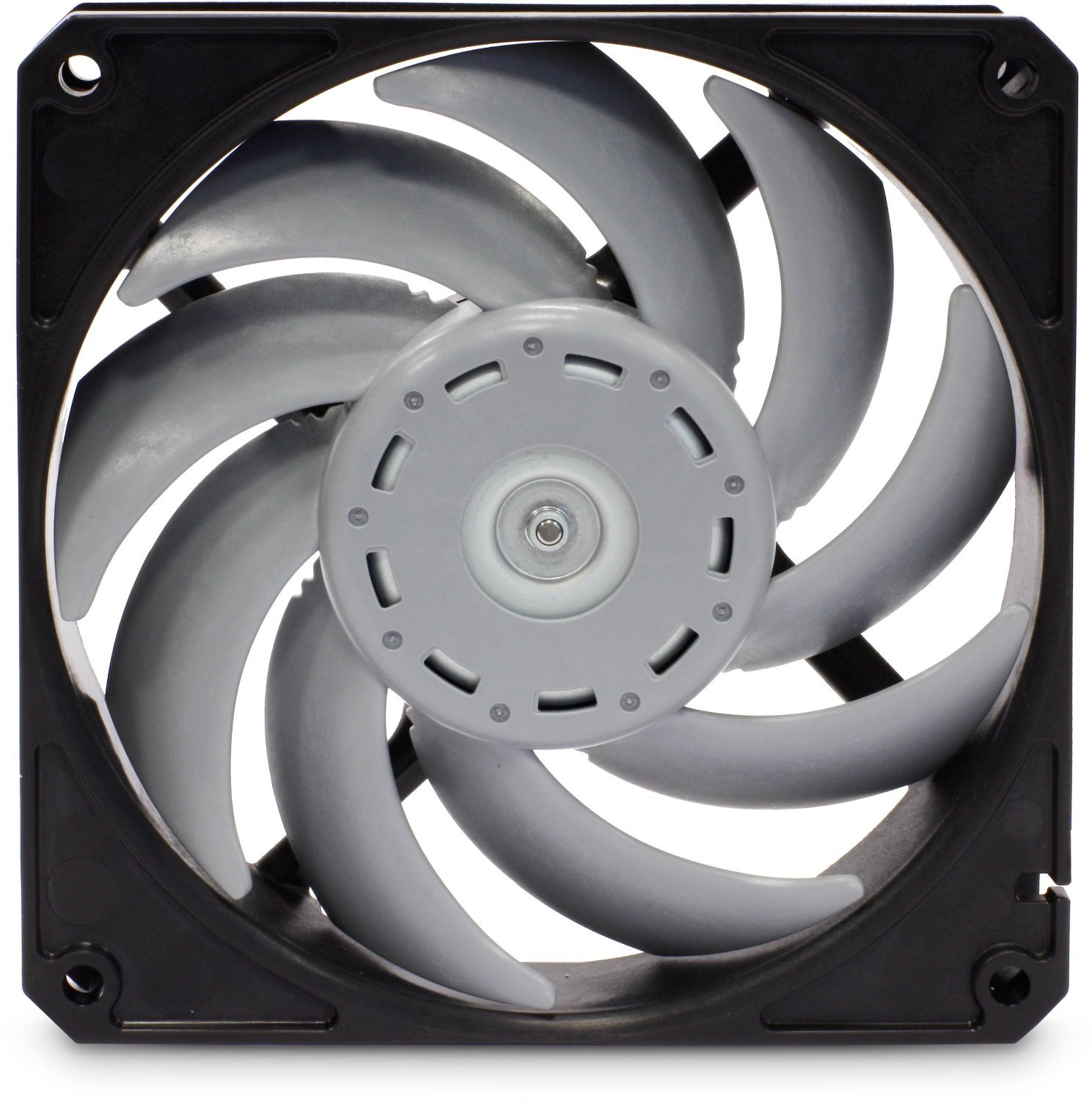

Curious as to how those BioniX fans compare to my Noctua in the sound department. It is always hard to tell pitch from review videos.
Just got them. Horrible quality. When I spun the fan, you could see it slightly wobble in the carriage. The carriage is so thin and flimsy you can bend it with very slight finger pressure all teh way to the fan blades. The F140 case fan's emblem was even off center.
I jsut got a return ticket for Amazon, and those POSs are going right back to Arctic. I'm glad I didn't buy their cooler either. I can;t beleive they are asking that much for those cheap ass fans. Grrrrr.

I bought them on Amazon. I also have the 140mm ReduxNoctua fan, several Niec Servo Gentle Typhoons, Gelid 120s, Corsair fans, and many others, and these felt and wobbled like cheap Chinese 4 buck chuck knock offs. If you go to Amazon, there is a review that has pictures about how flimsy the fan carriage is and two broken blades due to them hitting the carriage at full speed. They really are cheaply built. They were expensive too.
Average $17.00 each.
I was thinking about just running them, but when I spun the fan blades and watched the fan itself wabble back and forth, I just couldn't keep them for that price. My old Nidec Servo GTs and the Gelid Solutions fan, all over 7 years old, the fans run true in their carriage. The Noctua Redux is miles ahead of them all and when I spin the fan, it spins and spins and spins and feel thick and tight and spins true as ever. Aaanother reviewer said they make nise at low speeds. Seriously, those fans are worth about 5 bucks.

There's something about the heft, feel and fit of a Nidec Servo GT that simply exudes confidence. The motorhub alone feels like it would be more at home in a main battle tank rather than in a PC. :D
Just wish they came in a 140mm size as well...
The Noctua fans move more air with a higher static pressure than the GTs and do it with less noise:

GTs are old school - lol.

LOL, you're reading the wrong specs! The 1.65 value for the GT 1850 isn't for mm/H20, it's the airflow shown as m3/min.
The number/spec you want to look at is the "0.081" which is the static pressure value shown as inches H2O. Converted to mmH2O, that's 2.06. Granted, the specs for that Noctua are slightly better, but not much by "old school" standards. :-p Wasn't trying to harsh on the Nocs, they really are great fans, just suggesting that the GT 1850s aren't a bad choice either and get the job done. :D
Yep, I messed that up. Good catch on the conversion. Changed. I knew something was wrong because they couldn't have been that much better. :) However, looking at CFM and pressure, the Redux seem much better. Unless I screwed up the specs, the Redux is a lot better.

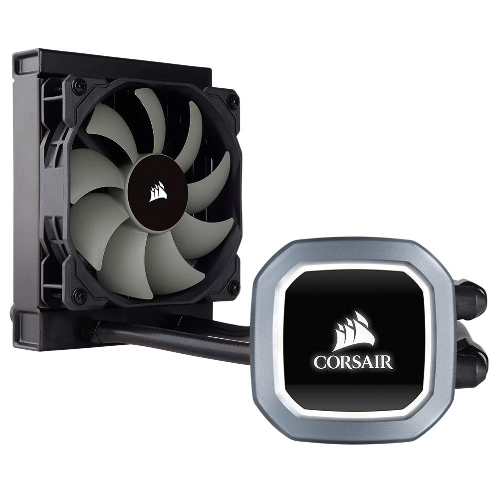

Does the H60 come in the new flavor? Which Corsair AIO uses the CoolIT pump?

I was under the impression that only the newer Platinum and XTs were the CoolIT pumps. But I may be wrong.
I did find a review on the H60(2018) from guru3d and they eluded to the fact that the patent was licensed to Asetek. "Inside is the pump as well 1+1 is a patent, ergo this unit is licensed from Asetek." Link to the article should you care to read it.
They have some charts on there to give you an idea of the performance compared to other AIOs and even air coolers.

i could be wrong but every asetek ive ever seen/used and every one on their site now are round.
edit: h60(2018) and all current are coolit:
https://www.coolitsystems.com/enthusiast/
Just read that and saw the cabling for the AIO pump. Corsair can't even sleeve their AIO pump wire?

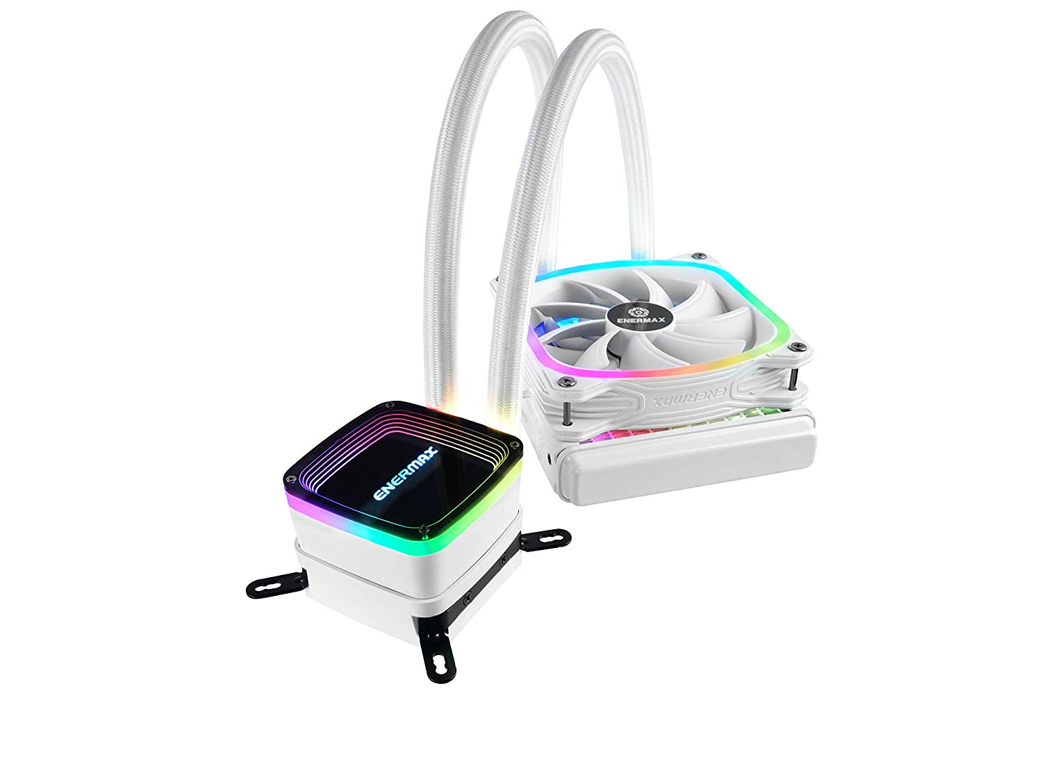

Well, well, well, here we go, as long as Enermax is quality, I think I found my cooler - have to read reviews first.
And, sleeved wires, like it should be CORSAIR.
But I still see some bare plastic wire funk coming out of the water block, too. White hoses and water block though.

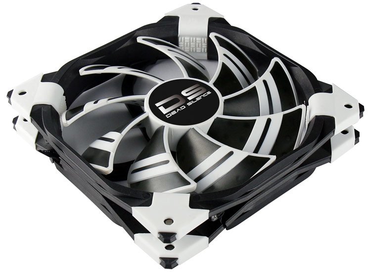

aerocool-ds-140mm-white-dual-layered-blades-with-noise-and-shock-reduction-frame-66.jpg
I've been using these fans in my cases for a while now. They move a lot of air, and keep my Corsair h100i as cool as I could expect. Aerocool DS fans.
Does anybody else have experience with these?
I don't, but most fans are built with cheaper, lightweight plastics and the fan blades break off, as a result, with any contact with a hard surface when spinning. Generally, not a problem, but I had a Rosewill 140mm fan, which was lightweight and "plasticky" feeling break a fan blade like that. Others on Amazon have pictures of the ARCTIC bionix fans breaking fan blades and flexible frames. I initially bought a 140mm to see what it was like, and I sent it back. The fan wobbled in the frame and they felt cheap as hell, the frame bends when you lightly squeeze it, plus when I'd spin them, they would spin down very fast:
I have around 20 of these fans doing various things around my computer equipment, but today i thought it was high time to write a review about it. Of the 20ish or so I have, now 3 failed, with a 4th showing signs of dying within the first year of use. Yes, they move massive amounts of air, but I believe the issue stems from having a way too weak frame, so any sort of outside pressure may distort that frame and eventually cause blade interference. If you have one of these fans you can gently squeeze around the ring and watch how easily it flexes. Unfortunately this means if you don't have your mounting points exactly square, you will see the exact same kind of fan failures as I'm experiencing. Hopefully Arctic remedies this in the future, but for now, buyer beware. . https://www.amazon.com/gp/customer-...iewpnt?ie=UTF8&ASIN=B082TSQP9M#R1QAKKGLINFDW3
Conversely, the Noctua fans, if you spin them with a finger, keep spinning and spinning and spinning, and the fan blades don't wobble. Plus, the plastic they use is really dense, tough (not brittle), and solid feeling. The only other fan I've used that feels like that is the old school Gentle Typhoon by Nidec Servo.
The Bionix fans come in all sorts of colors, and Noctua has stated they can't just change colors and keep their quality plastic the way it is. Plus, the Arctic fans are more expensive than the Noc fans Redux fans. It took them a long time to come out with the Noctua Redux line in shares of grey. I wish they would come out with an all white or at least a white blade version of the Redux models.
Buy a Noctua 120/140 fan and just hold it and spin it and look it over really well. You'll see what I mean about quality.
Now, if the Arctic Bionix had been half the price of the Noc fans, I'd have probably gone with them anyway. Right now the Arctic Bionix 140 is 17.00 USD compared to 15.00 for the Noc 1200RPM Redux model. I'm not spending more on a shittier fan just for color.
