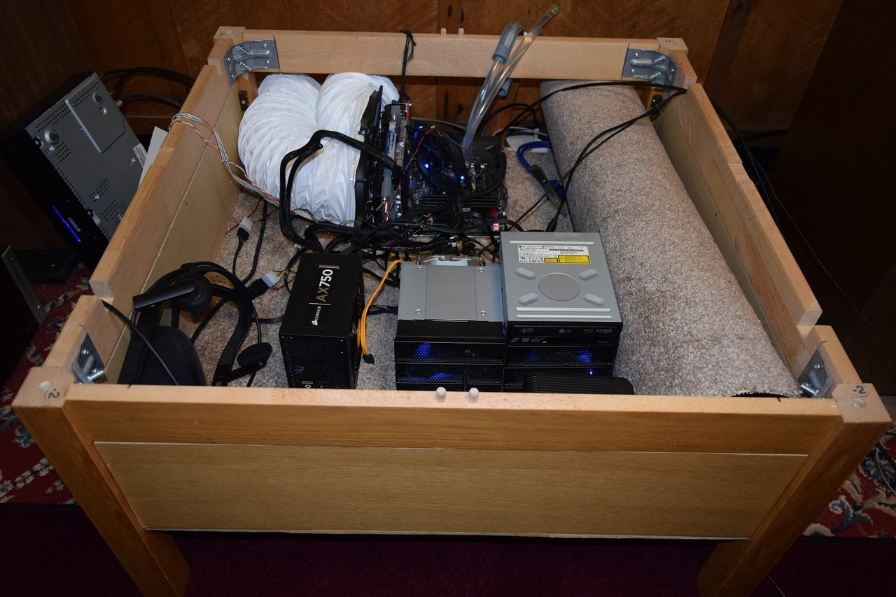

dat static inducing carpet and plastic air ducts
The motherboard is on a metal tray.
No electronic component is mounted directly on the carpet except the PSU.
Its been running for 3 years with no problem.
because static does not ark. kinda playing with fire, can't believe it lasted that long.

I guess you havent seen this type of ducting before, it has a metal wire running through it.
It cannot build up enough charge to arc.
Carpet will not generate static if nothing rubs against it.
Even if static was building up, it would discharge near anything metal.
ie anything that has electronics on/in it with my build
