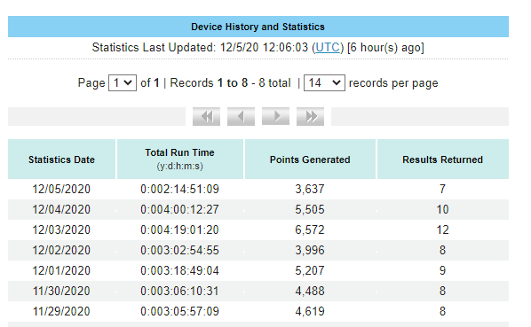

These are the results from the Rock Pi X. Can't say I'm incredibly impressed with the performance. This is running a standard Linux Mint install, would it be likely to boost the PPD if I installed a Linux distro without a GUI? If so, any suggestions on what distro? I was thinking of throwing on Ubuntu Server(last time I used it, it didn't come with a GUI by default) and see what happens.
Endgame
Jan 10, 2007
845
Performance looks similar to a raspberry pi 4
I found OS and OS tweaks made more of a difference with Rosetta that WCG OP. Rosetta at times needs more ram than a pi can provide, so shaving 200+mb off of memory footprint can make a decent difference (+5% or so). Now, you’ll probably save some cpu by getting rid of background tasks, but while I can point you in the direction, I’m not 100% sure how portable my raspbian tweaks are to Ubuntu.
how much power is that Rock Pi using for those points?
Icecold
Jul 21, 2013
301
4.7-4.8 watts according to my Killawatt. That's with a random USB C phone charger I had sitting around so I have no idea what the efficiency of that power adapter is.

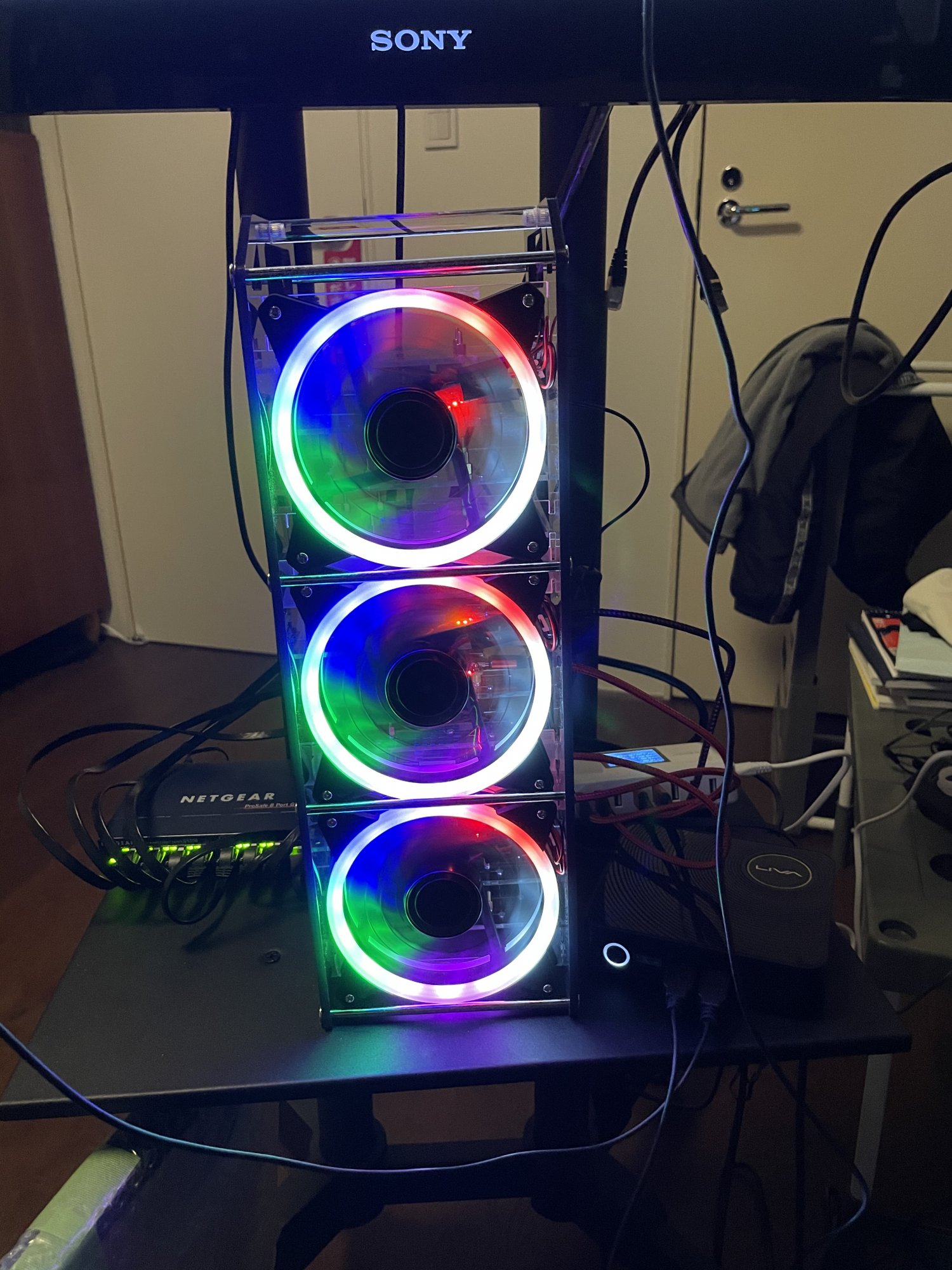

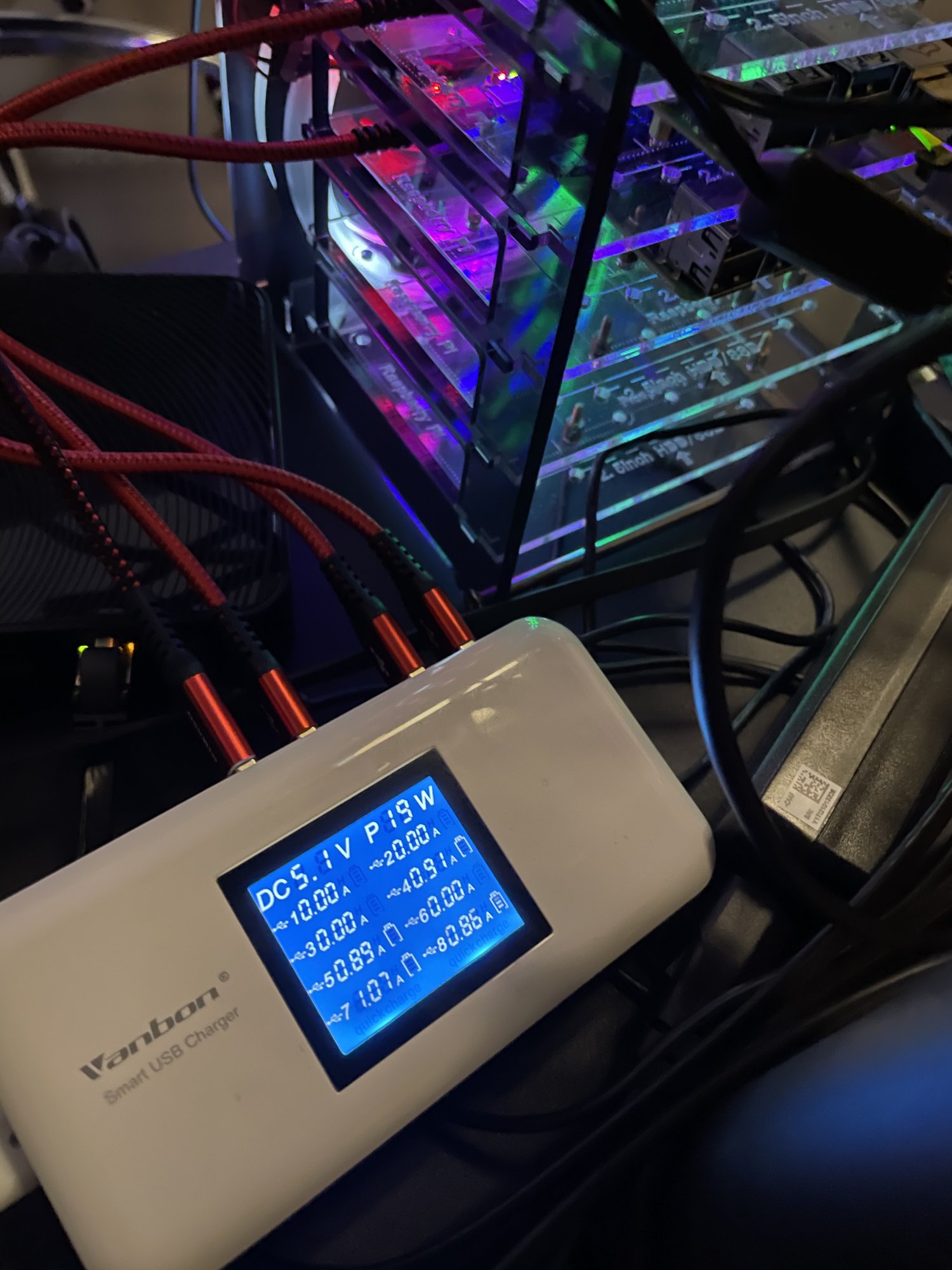

Settled for a new rack and power supply
the cooling is quite good with those big fans; much better compared the little one in the simpler cases or racks.
And better visibility on power consumption
Running out of USB A to C cables

Is that a 12 stack pi frame, or can you attach a 8 with a 4 stack? Have you done any power optimizations on the pis?
ChristianVirtual
[H]ard DCOTM x3
Feb 23, 2013
2,561
It’s a 12slot pi frame, half used. And not yet any optimization done like turn off wifi etc. but with 1A under full computational load I’m ok with already. I saw the suggestions made earlier in this thread and might apply some.
right now the 6 PIs draw 33W (1x8GB, 3x4GB, 2x2GB). My server PI has it own power supply with 4A.
