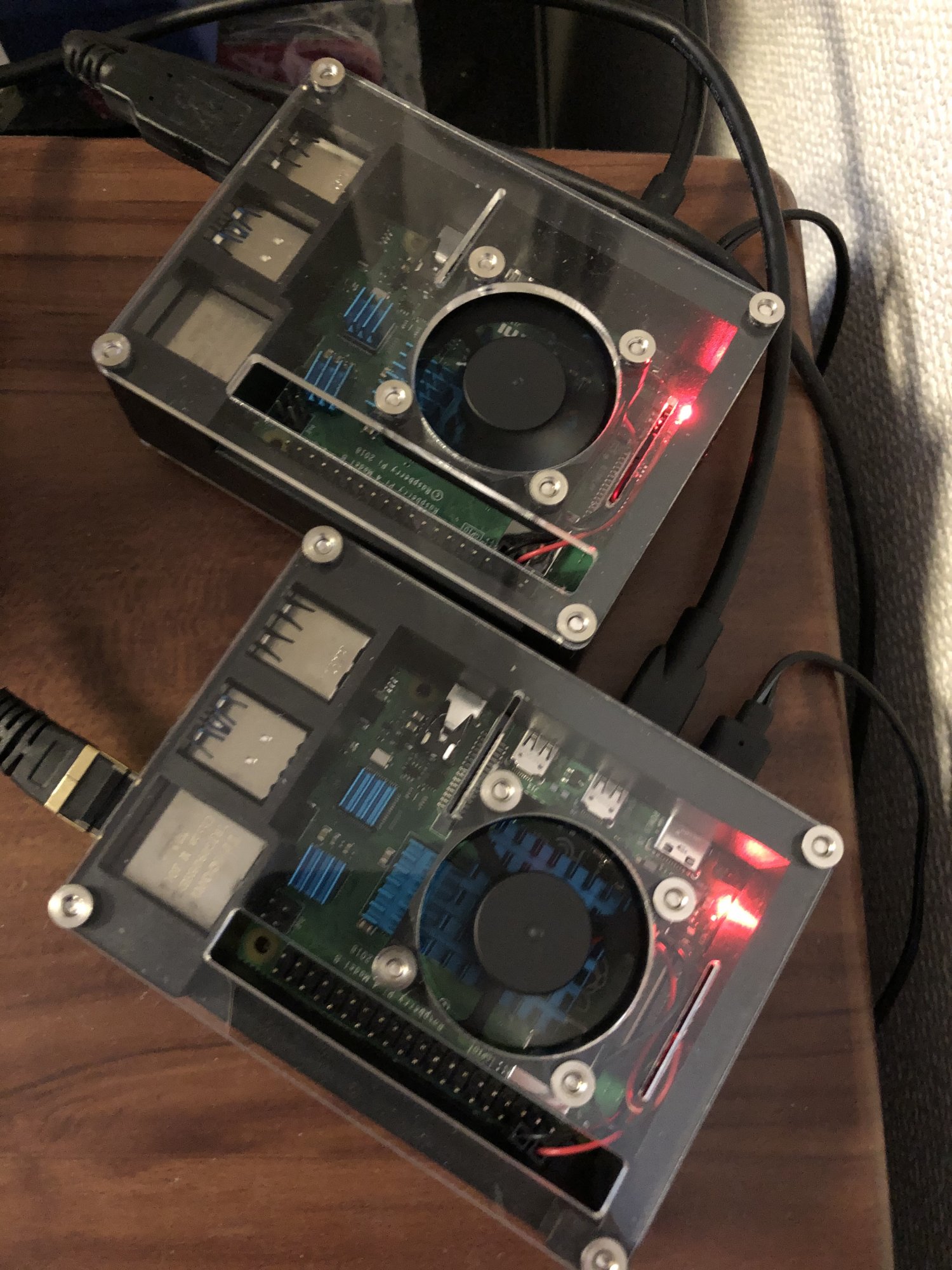

I got myself also a Pi 4 with 8GB RAM. Nice case too. 24/7 on WCG hardly ever over 40 Celsius.
And easy connect to my 5GHz WIFI. Nice little box. Like what I see. 9 Hours is a bit long but why not. One of those fire-and-forget boxen.
Next time I will resinstall with server OS only and save the need to GUI. Waste of CPU cycles.
Or maybe one Pi with UI and three Pi with CLI only ... something like that

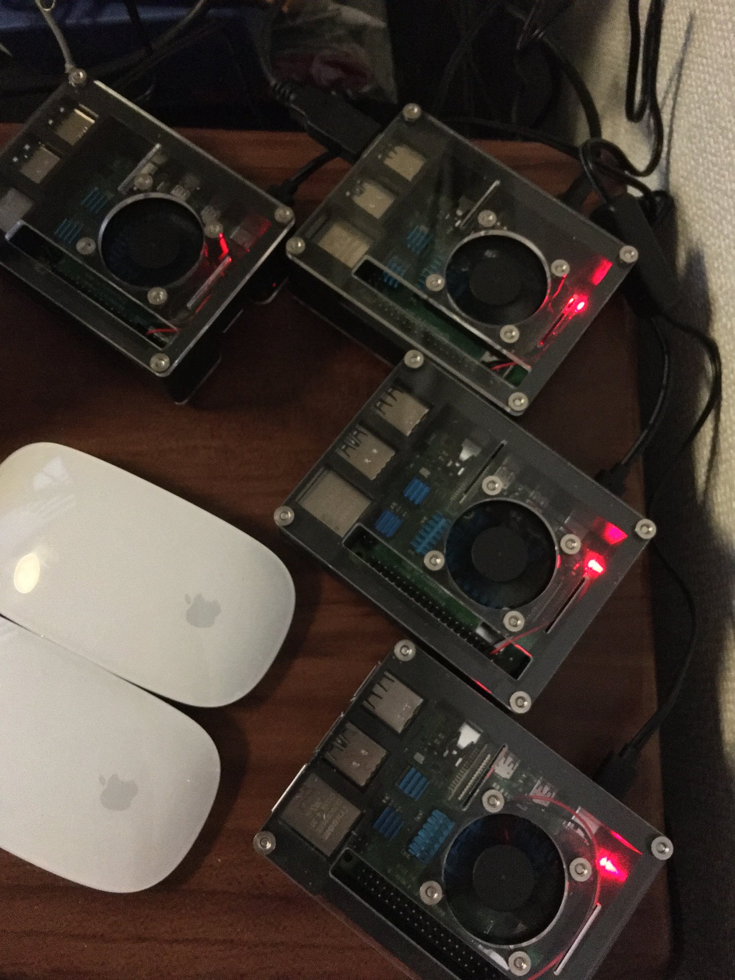

It’s happen again ... I was out shooting my archery competitions over the weekend and when coming home there are more of those ...
This time only 2GB version as it looks like enough RAM for dedicated cruncher on WCG right now; 4GB might have been better but saved a few 1000 Yen this way.
What is the best way to stack those ? And still have active cooling via fan ?
Any experience with booting those from USB / SSD ? Or booting over network ?
I envision one Pi with SSD would serve as bootstrap server for the rest of the pack.

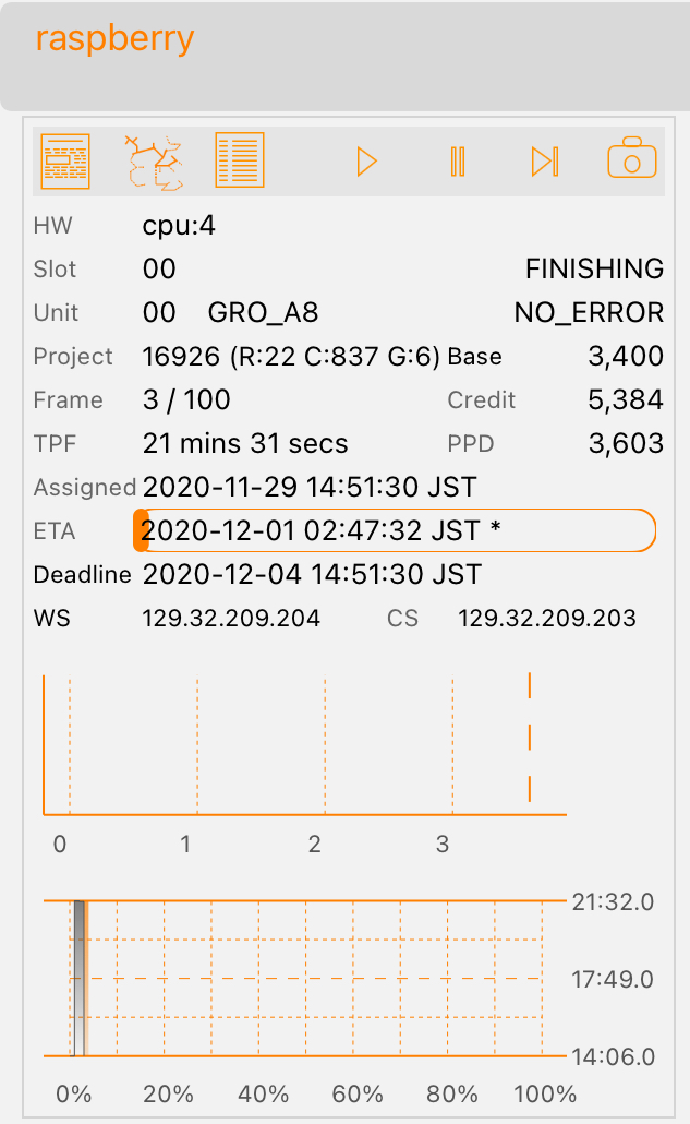

My ESXi plans got stopped with a banality of 5V adapter and something like DC5525 ... dimension of that pin. Not fitting in the board. Back to Amazon and order some converter.
But second part: install FAHClient 7.6
It works but required a arm64 OS; I used Ubuntu 20.10 for this try and actually it is installing and working. Core A8 is doing the magic.
As for PPD its a but too early; lets wait a few frames. Temps with fan above the heatsink around 43C

PPD improved a bit ... but I guess until my 20years OP-badge I will stay on WCG (after this WU)
Is this with 1 cpu or all 4? Thinking about it, Best case is that you’re only using one cpu and that you can get 4x the points with 4cpu which is like 12k ppd. Even a 1080ti would end up 3x more efficient in points per watt in that case, so probably better to keep the pis on WCG or Rosetta.
you would also likely be able to use the 64bit flag in raspbian instead of Ubuntu - that might net a very small perf improvement due to less OS overhead.
ChristianVirtual
[H]ard DCOTM x3
Feb 23, 2013
2,560
It’s 3 cores ... I started the WU with “medium” and the AS didn’t liked me to increase to 4 (“full”). It dialed back to 3.
06:00:16:WARNING:Changed SMP threads from 3 to 4 this can cause some work units to fail
06:00:16:WARNING:AS lowered CPUs from 4 to 3

Pi vs ryzen 3600, 12 core
same project, Ryzen got 10cores assigned, PI running on 3 cores
oh, and I run another one to see if 4 cores are ok, they are but PPD not getting better.
given the concept of quick return bonus also not really a surprise. to be competitive FAH might want to dedicate projects to the ARMs with adjusted base credits. But as proof of concept it’s nice It’s working.
