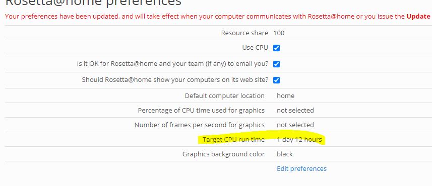

Also guys, when you are posting info about the Rosetta work units, you should include how long you have your target CPU run time set for. Default is 8 hours but you can adjust this anywhere from 2 hours to 1 day 12 hours. This will give people a better idea if their runtimes are on par with yours.
I always use default, and have found no concrete reason to change from the default
I change from the default to reduce the data usage as I have data limits on my cable internet. By setting them for longer work units, it is less data transferred and less strain on project servers.
That would be a good reason then!
