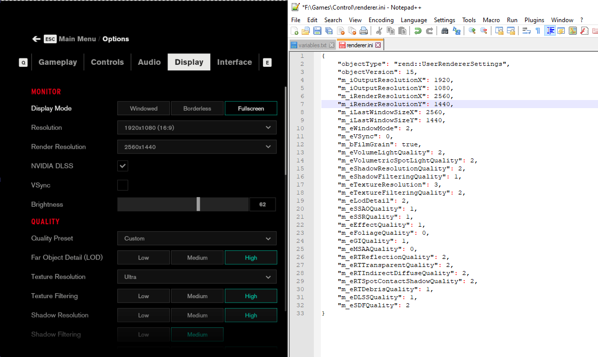

Hello. I have Aorus 2080 Ti Waterforce Xtreme. And monitor 1440P. So using RTX HIGH 1440P i have fps range 35-70fps.But with DLSS i have 80+ but its blurry mess with 960p render. Why DLSS is rendering on 960p? Any tips?
I dont have 4k monitor so DLSS is on 960p:( too bad
In the game folder the render.ini you can change there and use DSR to get a more reasonable output.So Example 1920 x 1080 render at 2560x1440
On my 2080 system, I get really good framerates with ray tracing on high as long as you set volumetric lighting to medium, and MSAA to off (or Volumeteic lighting to Low and MSAA to 2x)
I average above 60fps with dips to about 45 in gun fights but it's very smooth overall, volumetric lighting kills performance going from med to high
this is at 1080p
ok renderer.ini , but can you tell me what change in nvidia panel to use dsr in this game? I mean what i must change to use DLSS above 960P.
dunno if you can force DLSS to render above 960p from the 1440p window resolution, the game is just blurry eve at standard 1440p, ray tracing makes everything look "soft" to me
You can't force DLSS to upscale from another resolution. The method gerardfraser showed doesn't require DSR to be enabled in the driver, as the game is doing it for you. But this is doing downsampling, not upsampling. So you'll get a better image but at the same performance level as 2560x1440. If you want to upscale you want to reverse the steps shown by setting the output resolution to 2560x1440 and the render resolution to 1920x1080.
Hey that makes sense,thanks .

Ok i found out. Resolution 1440P but render resolution 1080P. Looks still nice and fps are decent now. Without DLSS.
Btw. What is difference between RESOLUTION and RENDER RESOLUTION?
resolution is what displays, render resolution is the image the card puts out. it will then stretch or compress the image to fit the resolution. you can possibly make things look better by having render resolution greater, but if it is too small you may get artifacts or blocky textures.
