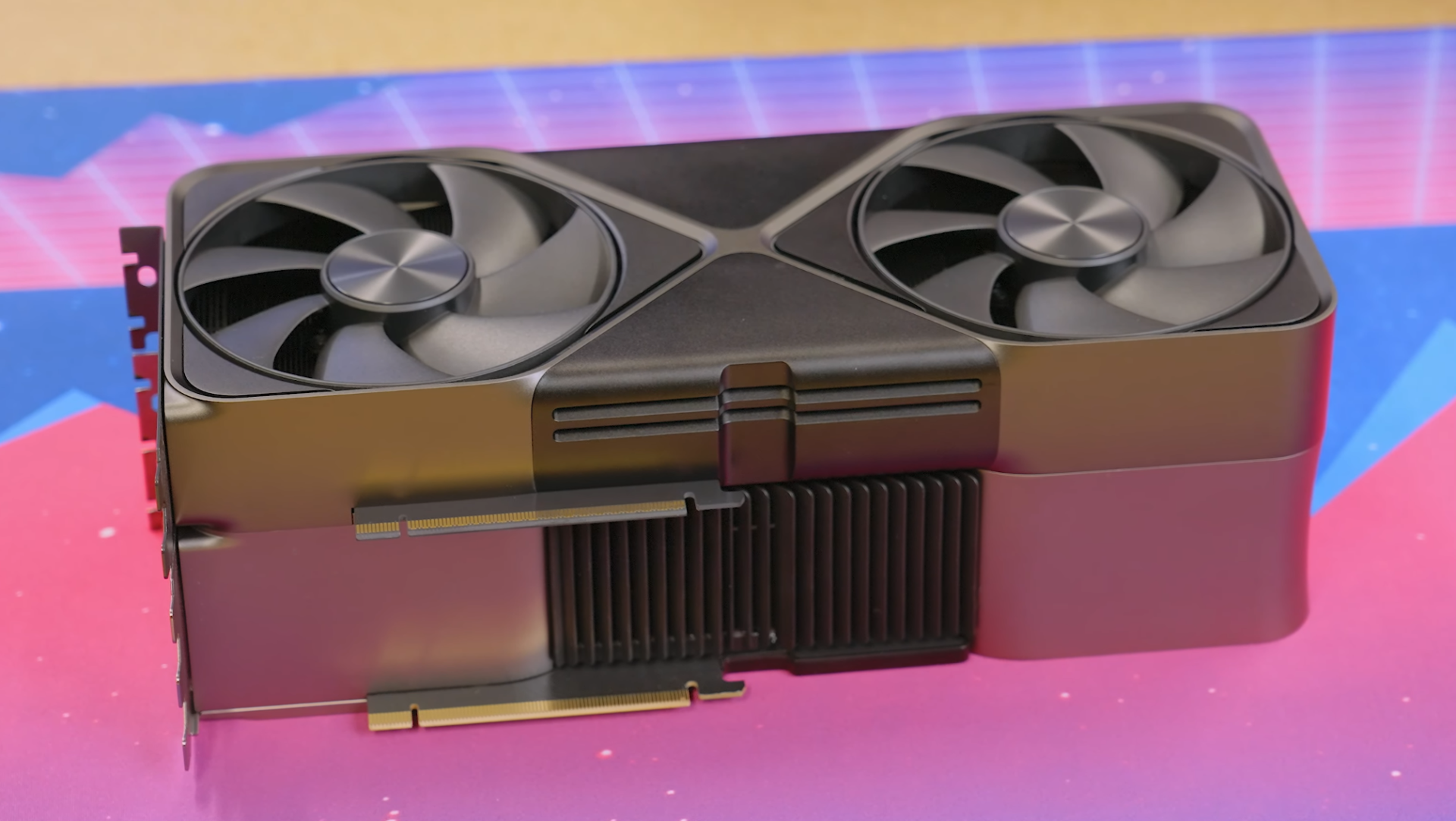

I saw the video but that photo made me think for a second it was one card, lol.
its the 7090 SC Ti Titan, requires two pcie x16 slots AND an external 750w psu! ;)
thought it was a good comparison in size but if you look too quick...
I just watched one video about the Founders Edition. The phrases that stood out was "crazy amount of heat" and "space heater" and "don't use a CPU air cooler". Yikes!
I mean 575 watts is unprecedented for a GPU, closest thing before that was the 295x2 which was 500 watts. My 4090 typically pulls no more than 360 watts since I power limited it to 80% and my previous card before the 4090 was a 3080 Ti FTW3 Ultra which pulled 450 watts consistently. Let me tell you the difference between 360 and 450 watts might not seem that big on paper, but I could absolutely feel that difference in my room temperature over long gaming sessions. Going from 360 watts to 575 watts is gonna be wild.
