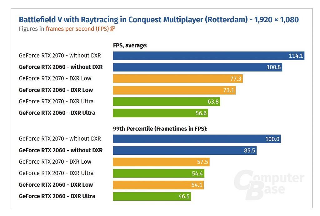

I don"t where your problem is here, but computerbase is getting much higher numbers than this, in the same map, even for the 2060:
https://www.computerbase.de/2019-01...est/5/#abschnitt_battlefield_v_mit_raytracing
My money is that you are still CPU limited on that 7700K. And your CPU testing failed to illustrate that limitation somehow.
Our CPU is not the bottleneck - https://www.hardocp.com/article/2019/01/02/battlefield_v_nvidia_ray_tracing_cpu_testing/
I do not know how computerbase evaluates its performance in that multiplayer map, so I can't comment on that. For all I know they are standing in one place, or moving back and forth in just one area, or testing only 1 minute of gameplay, I do not know.
What I can tell you about how we test is that I play a real-world live 64 player match loaded with 64 players just like a normal gamer. I time it for 5 minutes each run, and do several runs. I make sure to explore not just one area, but all areas of the map that I can, especially in spots I know that are lower in performance since that is the worse case scenario, but also the real-world scenario.
In my experience of Rotterdam with DXR performance can very GREATLY depending on what part of the map you are in, and where you are. I find the lowest performance seems to be right under the train bridge, for the entire length of that area framerates are the lowest. Framerates are also low inside the mansion with the shiny floor. Framerates are typically much higher in indoor environments, and in the area next to the water. The framerates can deviate 15FPS easily between all those spots. So your average framerate can be higher or lower just depending on where you benchmark at in the map. This is also a major point we have to make, the fact that framerate varies so much with DXR is a problem. Someone could easily bias the average framerate in Rotterdam if they specifically stay in one area over another, either higher or lower fps. SO BE CAREFUL with other reviews. Again, I test in all areas to get an average, so now you know how we do it.

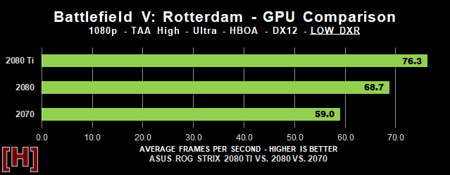

Yes it is, your results don't agree with other sites that use higher CPUs, it doesn't agree with many YouTubers who captured their runs with higher CPUs as well.
Your CPU comparison compared an 8 thread CPU to another 8 thread CPU. DXR in Battlefield requires a minimum of 12 threads CPU, even a Ryzen 1800X can bottleneck the game with DXR as Digitalfoundry found out.
At 1440p low DXR, You have the 2080Ti just 13% faster than a 2080, and the 2080 just 5% faster than the 2070, which is impossible unless you are severely CPU limited.
Your numbers at 1080p are also screwed, showing only 10% between cards, whether at low or ultra DXR, which is another sign that you have a massive CPU bottleneck.
I don't know how you can claim you are not CPU limited while using a CPU that is begged at 90% usage most of the time.

I read it whole, it still doesn't explain the massive inconsistencies you have with your numbers. The differences between the 2070, 2080 and 2080Ti are completely compressed in your testing as a result of a massive CPU bottlneck. And your 2080Ti is bascially doing 2060 level of performance
Also ComputerBase tests a live match in the mansion area of Rotterdam.
It goes considerably up because the ray setup is CPU intensive.
ComputerBase just say they use the Ultra preset with Future Frame Rendering turned on. [H] goes beyond the Ultra preset as detailed here:
If we are CPU limited, then why did we see framerate scaling across the different cards? That said, Brent now has a 9900K in hand to use, and we will be publishing our findings.

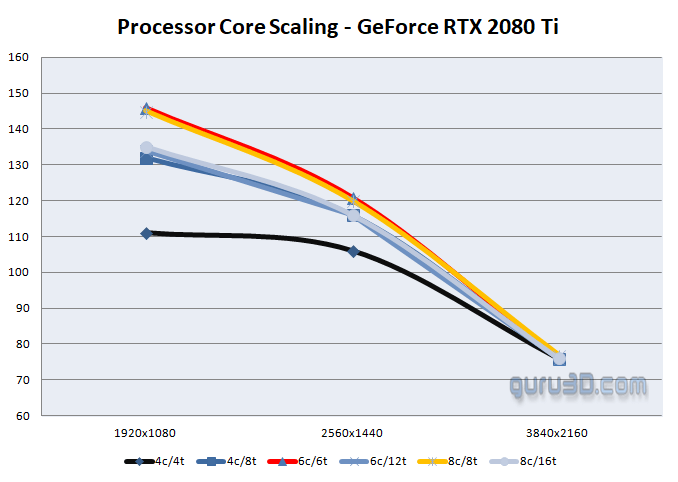

I'm really doubting that BFV requires more than ~6C/T. Game engines traditionally do not scale as well as say, rendering applications, because there are many parts of the game engine that are difficult or hard to multi-thread. I could certainly be wrong, but I can't think of any other games that scale to 8 cores, and none beyond that.
The Cobra
Jun 19, 2003
2,924
BF4, BF1, Forza, GTA V, Assassin's Creed...
Nolan7689
Jun 5, 2015
1,694
I really hope AMD mule kicks NVIDIAs heads out of their collective asses with their upcoming releases. I'd be happy to buy a GTX2080 for ~$500.
I really hope you aren’t rooting for AMD purely in hopes of pushing down Nvidia prices. (Assuming competitive performance) It’s part of the problem to only hope the competitor drives prices into your range. It’s unsustainable for the competitor, which well, if they can’t compete then they can’t compete but if they are actually competing....
Rizen
Jul 16, 2000
9,486
BF4 definitely didn't scale beyond 6 cores:
According to DICE’s Johan Andersson, Battlefield 4’s Frostbite engine is parallelized to run on up to eight CPU cores. However, in a presentation he gave back in 2014, he conceded that it’s not possible to utilize all available CPU cores under the then-current implementations of DirectX and OpenGL.
BF1 doesn't either: https://www.tomshardware.co.uk/battlefield-1-directx-12-benchmark,review-33864-8.html
GTA V doesn't really either, 4 core CPU is a few frames off a 10 core CPU at 1080p and no difference at 1440p: https://www.tomshardware.com/reviews/multi-core-cpu-scaling-directx-11,4768-3.html
Looks like Assassin's Creed Oddysey does, though, which is interesting. https://wccftech.com/assassins-creed-odyssey-pc-performance-explored/
