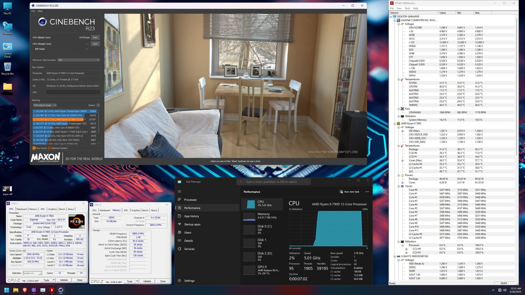

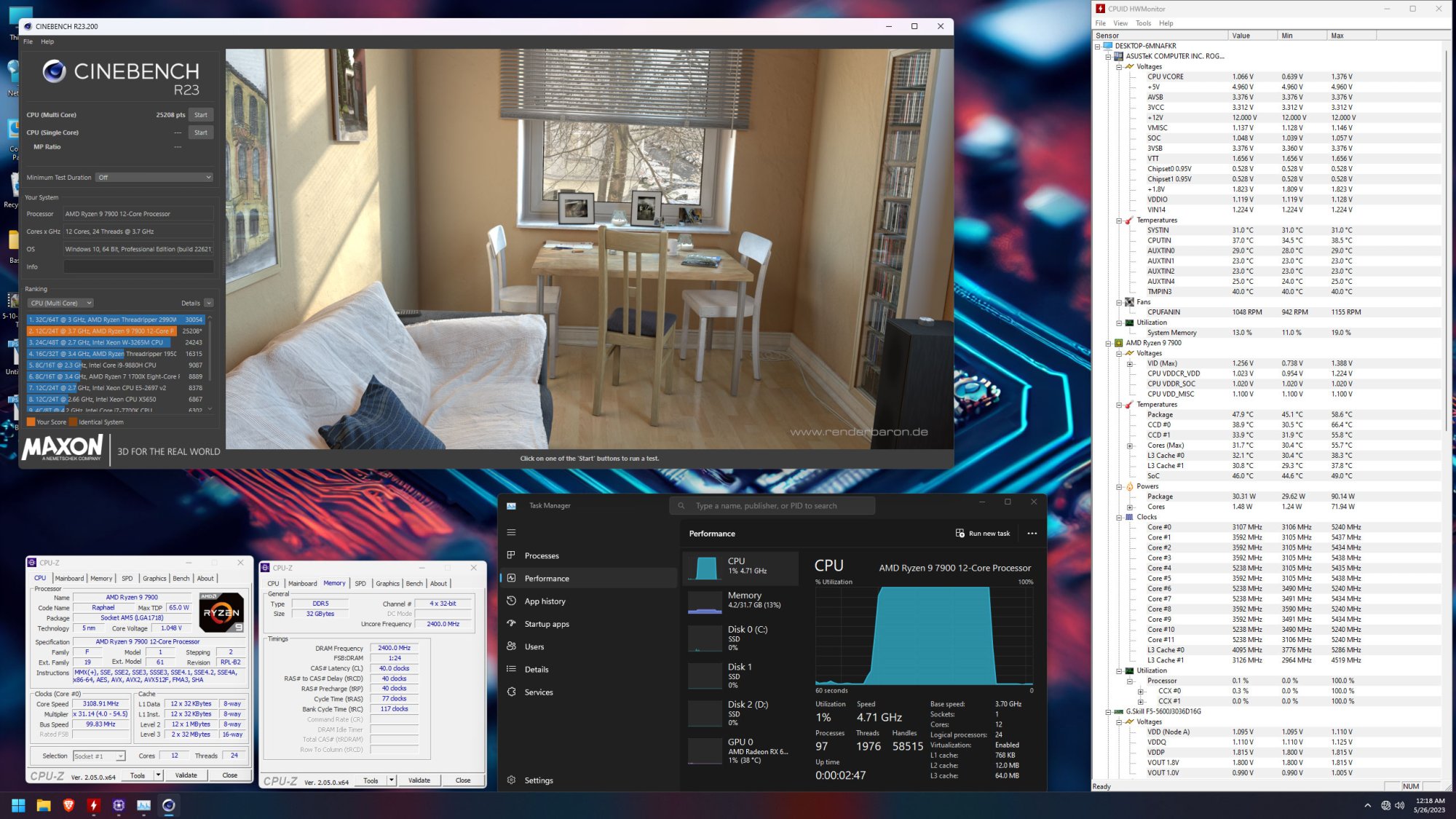

Mega6'er is right the 1416 is pretty stable for me but I am not running expo at all and getting better performance with it off.
with expo on I get about 23500 in CBR23 with expo off I get 25250. I think it is weird as well. I actually tried manual on the mem (timings, voltage) instead of expo and it was lower then with expo being off.
If you want me to run a test with a certain setting let me know Ill take a screen shot and post.
EXPO-ON- 23729
EXPO-OFF- 25208

You're uncore is 2800, it should be 3000. Like I mentioned earlier, you need make sure you set the memory 1:1 uncore:mem. Your Vid on expo is a bit high at 1.48. Dial it back, try for 1.4v.

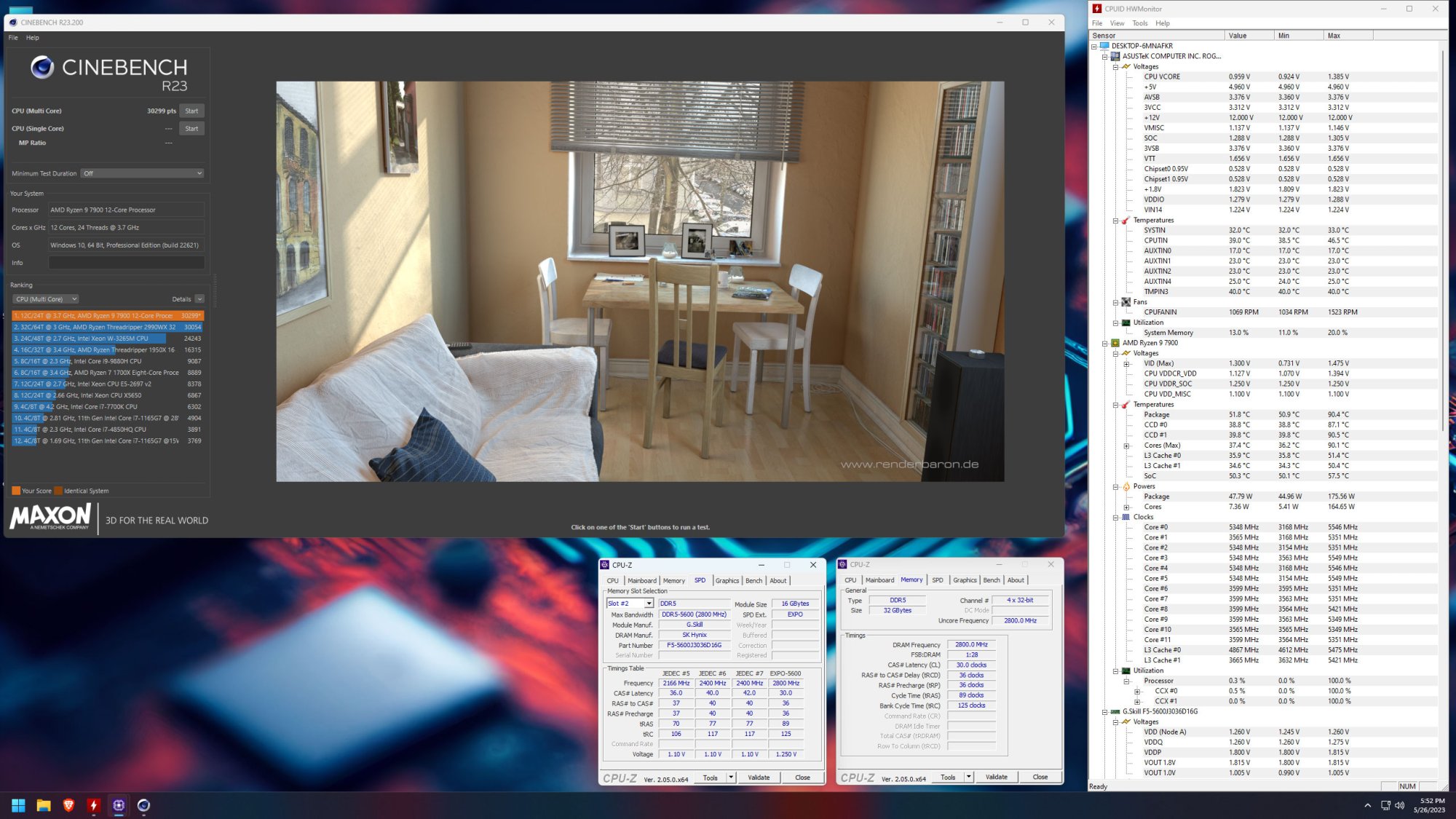

Ok I tried a crap load of stuff, I was pulling so many amps the transformer on the power pole outside was smoking, lol.
i tried straight up manual 6000 and 5800 and it posted and showed in cpuz but the cbr23 scores were crap like 16,000.
Then I tried CBO-auto with expo11 (5600) with Ai optimized with performance mode, everything else auto.
and got this.
and got this.
Now you're cooking.
