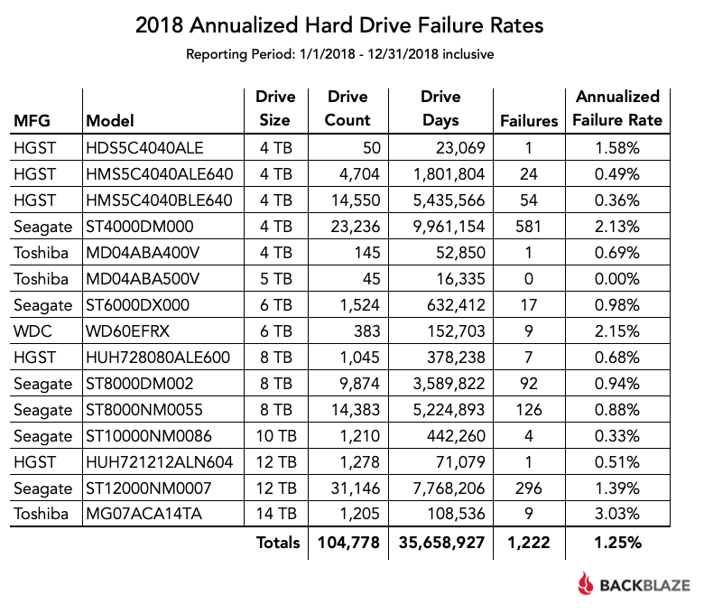

Pretty much every HDD these days is around the same reliability. I have used a combination of WD, HGST, Toshiba, and Seagate. I have used the most seagates since they have higher RPMs and thus more speed than WD NAS drives. Reliability has been excellent. 6TB is my smallest size drive, 8TB is what most are. I also have a pair of 10TB and 12TB seagates. Though I have had no problems with my HGST or Toshibas, they both run louder and hotter than my WD and Seagates do. COuld be a coincidence of the single model series they are but just wanted to point it out.
Currently 8TB is the sweet spot in price to capacity.
Seagate is releasing new 16 and 18TB drives this year too which will hopefully lower then 8-12TB capacities down $30-40.

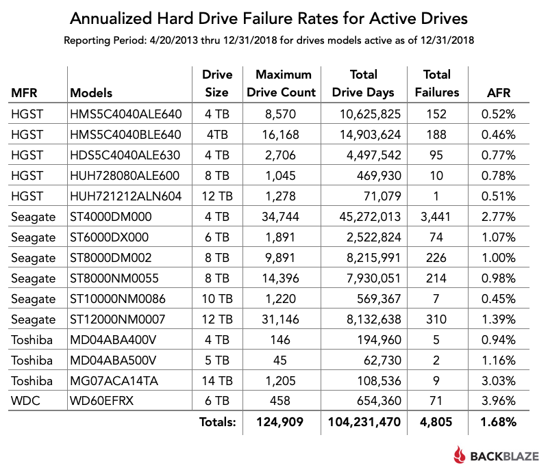

This is far from the truth.
https://www.backblaze.com/blog/hard-drive-stats-for-2018/
OP, stay far away from Seagate, when you see one, run, and don't walk. These stats are proof they are unreliable and I have seen it for myself in our own datacenter and enterprise environments that Seagate has and still is unreliable compared to HGST, WD, and other brands. I've learned after 25 years in IT to never buy a Seagate again, and I won't.
NIZMOZ You cant go by BackBlaze stats for home user use. They take consumer external drives, shuck them, set em up in big raid arrays and then hammer them like crazy 24/7 in an enterprise environment they were not designed for. That is nowhere even close to a scenario for home users.
Now when a home user does use a drive they buy, the quantity of drives is so small they really have equal chance from WD to Seagate to HGST to get a random failure, and those failure rates will be very different than what Backblaze gets.
And just FYI, its kinda dumb for you to say "stay away from seagate" when you are advocating BB stats and yet BB says Seagate is better than WD.

Like I said, all were compared, the same stress, and WD survived the best. I rather own the one that did even though its an overkill test. Our NAS at home runs 24x7 as well, so it is still working the drive pretty well as it never rests. How does BB say its better when the stats say otherwise. They didn't say what you made up anywhere in that article. lol
Also, you can't just say that Seagate is better than WD. These are the facts.
SEAGATE 4TB - 23,236 count of 4 tb 581 failures
HGST 4TB 14,550 54 failures
Seagate 4tb - 3441 failures
HGST 188 failures + 152 failures + 95.
Enough said.
Enough said.
Your reading and selective highlighting of numbers from the Backblaze reports is about as worthwhile as Barr's summary of the Mueller Report. Look at the percentages. Seagate isn't that far off from WD, particularly for more recent models.
Also, IIRC a lot of those 4-6 TB HDDs were purchased during the Thailand floods and the recovery thereafter. Quality across all brands dipped (probably glossing over QA in order to get units out the door), and it was exceedingly difficult to get drives in bulk. I seem to remember Blackblaze and other smaller companies actively shucking externals and offering bounties to users who were able to locate certain HDD models.
Enough said.
