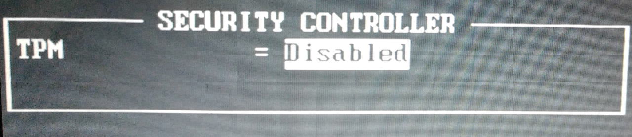

Later found out it was optional at the time, which was good. I can turn it off on the laptop in question which the course was for ;) just like when it used to be a socketed management engine in the early days. TPM is part of the Management engine and back then basically was the consumer name for the management engine in the early days, so turning this off is probably this is quite a rare functionality. Was on a laptop motherboard that was initially built for core duos, but could also run C2D (socketed) and still disable the TPM/ME as IIRC it is not supported on the CD.
Agreed for corporate it's fine. but for 98% of users... a deliberate backdoor for letter agencies and other traitorous groups to pwn you no matter what VPN, firewall or other bullshit you are using.

No, TPM is NOT the intel ME. It is disabling the TPM module, that's it.
