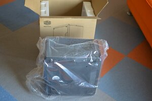

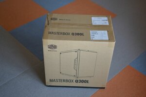

It might not be apparent on photo, but the box is huge for a microATX case.

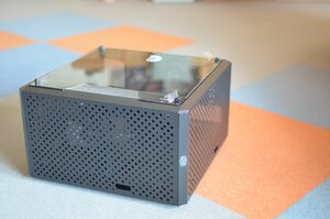

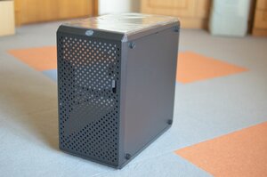

Without packaging.

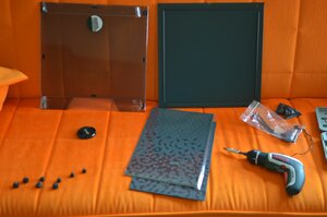

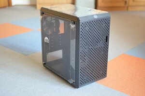

Yes it's ugly, because the cover is missing from the front, it actually comes with both covers fitted to the top. And they spared a few cents on packaging because the bottom one is not packaged just the one on top of it.

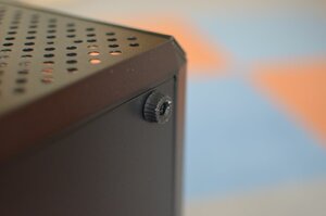

The screws on the right panel double as stands so the case can be used both vertically and horizontally.

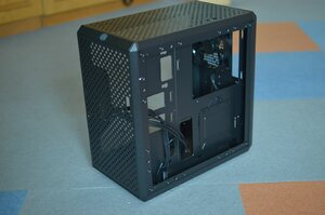

All the stuff removed.
