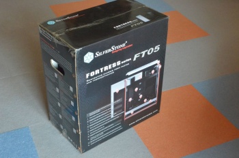

I got it delivered to me today. Unboxing tomorrow. Hope it isn't bricks in the box.
So here it is. As opposed to the common plain cardboard box this comes in a shiny box.

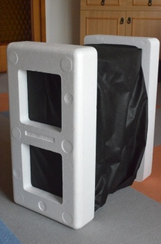

So it is a case in the box after all. Finally I can rest easy. It wasn't a scam after all. Less than half of MSRP with VAT?!

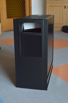

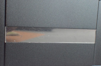

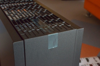

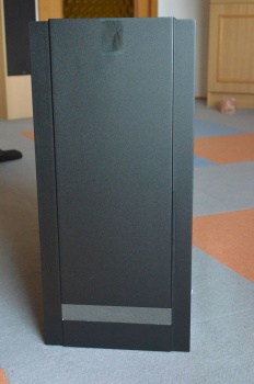

Barely visible logo on front, door taped for transport.

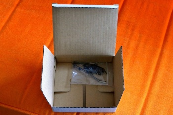

Removing the top reveals the "accessory box" Why even have a box for that tiny bag?

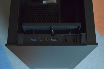

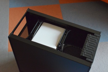

First look inside, everything seems to be in order. Unfortunately only two USB headers, at least this time they have an internal connector, not a simple extension cord to the IO panel.

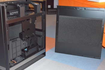

Removing the side panels was extremely difficult for the first time, I feared of breaking or bending something, but that's how you're supposed to remove it.

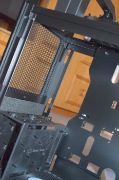

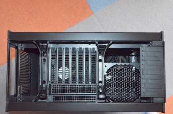

On the back side there are two places for 2.5 drives, and the tray for a slot-in optical drive. I've never even seen one of those, not that I used an optical drive in years.

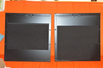

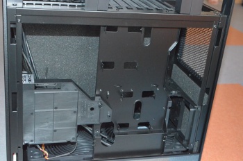

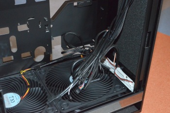

Sound dampening material on the inside, believe it or not this is the first case I own that has that.

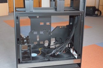

The other side is a jumble of cables, it will be nearly impossible to route those nicely I suspect.

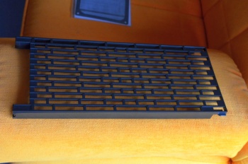

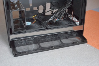

They took the effort to tape down the door on the top, however the bottom dust filter which is only held on by magnets, was flailing around freely during transport, it was already out of place.

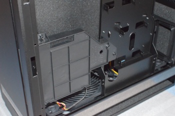

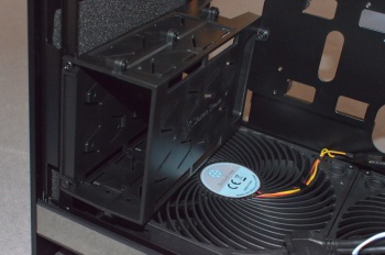

The two 180mm fans, familiar from the RV03, plus the 2x3.5 HDD cage. Of course 2x3.5 will not do. I'm not sure yet but somehow someway, I'll do some ghetto modding and add more 3.5 capacity.
If you have the HDD cage in there is limited clearance for the PSU, I'm not even sure mine will fit. Plus the Noctua NH-D15 might not fit in it either. I wasn't planning on using it, just noting this. The plan is to use AIO, and in the area where the air cooler would be put HDD cages.
View attachment 115661 View attachment 115662
View attachment 115663 View attachment 115664 View attachment 115665
View attachment 115666 View attachment 115667
View attachment 115669 View attachment 115670 View attachment 115671
View attachment 115672 View attachment 115673 View attachment 115674
View attachment 115675 View attachment 115676
