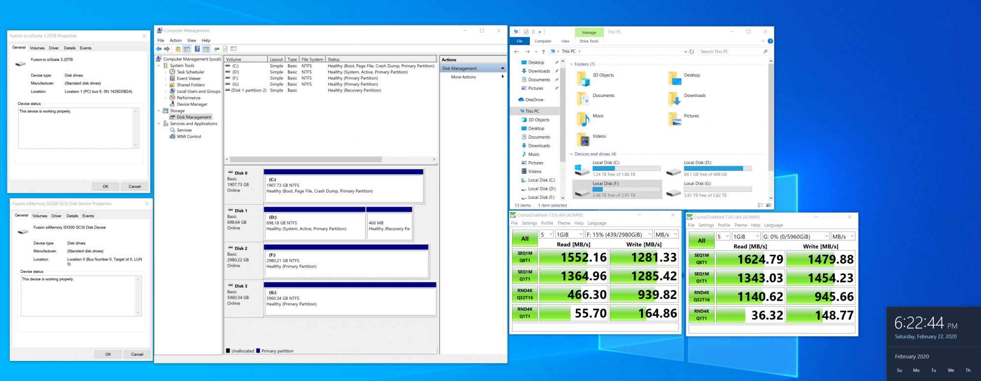

Thank you op. Bought a 3.2 gb one and it seems pretty good. 85% usage remaininng. Might buy a second one for my server.

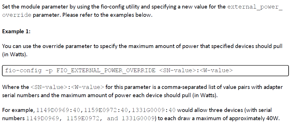

any idea on how much performance is gained by running @75 watts versus default 24 volts ?

It works just fine with pcie 4x link. I run mine in an x16 slot that's 4x electrically. It *might* need a full 8x slot to provide the higher 75watt mode (should you choose to use it)
What happens if you try to run the 6.4TB drive in four pci-e lanes? Will it work at reduced speeds or will it just not work?

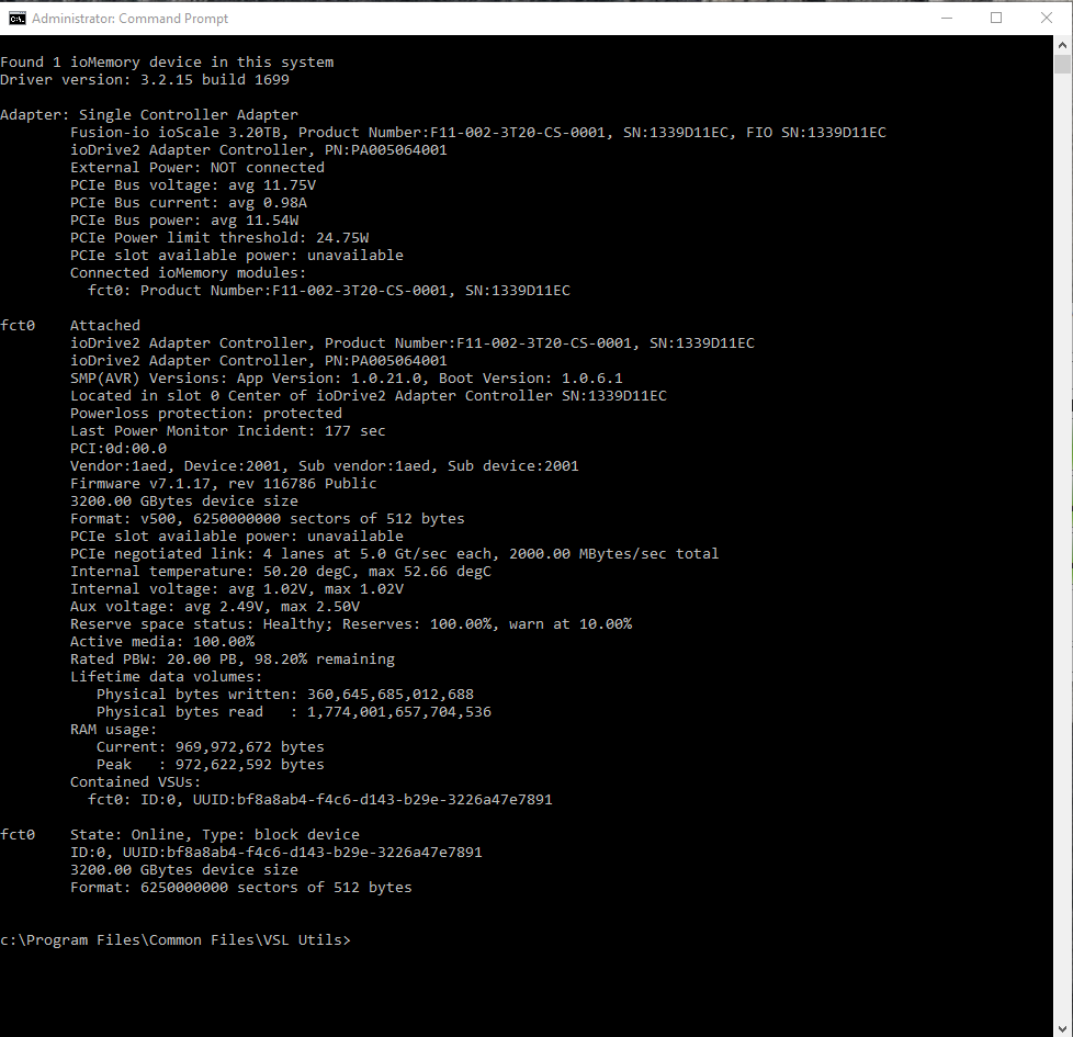

Finally got around to installing my 3.2 from the prior $200 offer. Looks like I did well on remaining life. Not sure I can get used to an SSD coil whining like a graphics card though, I'm basically on an open test bench so its quite audible.

can the command line used to set 75watts be returned to default 24volts if one desires , sure it may be a different command, but does anyone know it ?
Net Prowler
Mar 11, 2013
1,068
The manual is your friend :)
The proper command would be fio-config -p FIO_EXTERNAL_POWER_OVERRIDE <SERIAL_NUMBER_OF_YOUR_SSD>:25, where SERIAL_NUMBER_OF_YOUR_SSD is the value returned in the SN: field near the top of the output from the fio-status -a command.
thanks i haven't taken the time to read the manual just yet :)
