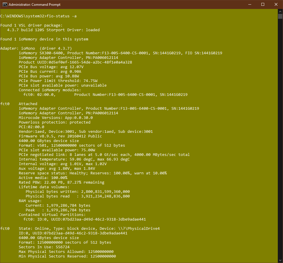

I just made an offer on the 6TB version. Would I follow the same directions as the 3TB version assuming he bites.
You'll need a ioMemory SX300 driver from Western Digital's website, the driver ought to be named Fusion_ioMemory_VSL_4.3.7.1205_x64_storport.exe the one I downloaded was dated Jan 30 2020. Latest firmware available seems to be v8.9.9 my drive shipped with v8.9.5
https://link.westerndigital.com/enterprisesupport/software-download.html
You have to sign up for an account to access the consumer area where the drivers are located. Note that when I accessed the site with Microsoft Edge, I could not get the driver selection page to work correctly, but Firefox worked fine, if you use Chrome it should also work. Since I only have one working x8 slot(Thanks ASUS) I pulled my vid card and used the Intel IGP for all this. Per the manual, x8 PCIe is required for this device, along with a minimum 16GB of RAM for 4k sector format usage, smaller sectors require at least 32GB RAM.
Alright time for the guud stuffs:
This device will have to wait for a new build where I have more functioning x8 PCIe slots :cry:.
View attachment 222895 View attachment 222899
