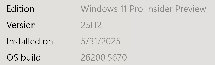

installed 2 min ago.
I wonder whether this update messes with WiFi adapters like the update to 24H2 did. I encountered the problem on a number of customer machines to varying degrees as well as my own laptop.
Judging by the current version of the knowledge base article for 24H2 it seems they are fewer game-related issues listed, so hopefully 25H2 doesn't bring any new issues.
