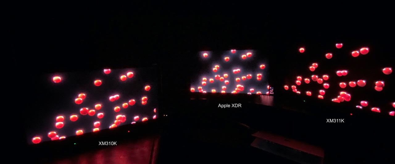

https://daejeonchronicles.com/2020/01/04/apple-pro-display-xdr-blooming/
– Okay now the concerning stuff. Halos. These are most noticeable when the display brightness is cranked way up and you have bright windows/shapes on a very dark background. This seems to come from the local dimming leds. I think this is the biggest deal breaker for HDR reference grading, but at 100 nits I don’t think this will be a deal breaker for rec 709 work. (my non-engineer opinion). Makes me fairly disappointed this isn’t an OLED panel to mitigate this issue completely.
– Because of the local dimming, blacks look great…except when there should be bright speculars in the blacks…they just get dimmed too. This makes me want local dimming to be just shut off completely. Just bring back the lifted shadows from the LCD backlight at that rate.

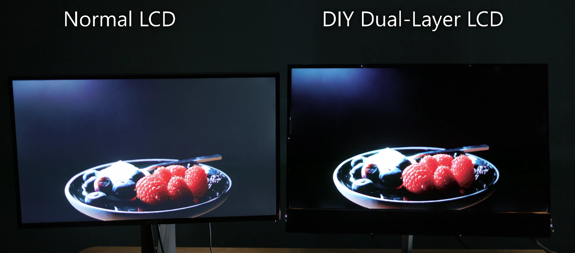

"A comparison between Apple’s 6K monitor, the FSI XM310K (zoned dimming) and XM311K (dual panel)."
The image he posted is likely exaggerating the effect due to camera bias and compression but he also gave his personal take on it.
If all three displays were in the same photo that's not the best way to show it either as the camera will bias the results since cameras capture things relatively.
https://fotoeng.wordpress.com/2020/09/10/no-hdr-fun-because-pc-monitors-are-trash-2/
For the record the Macbook Pro 16" M2 Max looks in worst case scenarios closer to the XM310K - slight blooming but nowhere near as bad as the XDR. In most footage it's not noticeable at all.

i also mentioned it a few pages back. looked good but chugged power.
Sorry must have missed it in the more stormy parts of the thread lol, or it didn't hit for some reason. Had time to check it out this morning. Thanks for sharing it.
edit:
I did see the images you posted but with no link I never followed up on what you were actually referencing by searching diyperks I guess.
diy perks on yt just built his own dual lcd and the leds to light it were 250w alone but it did look real nice.
