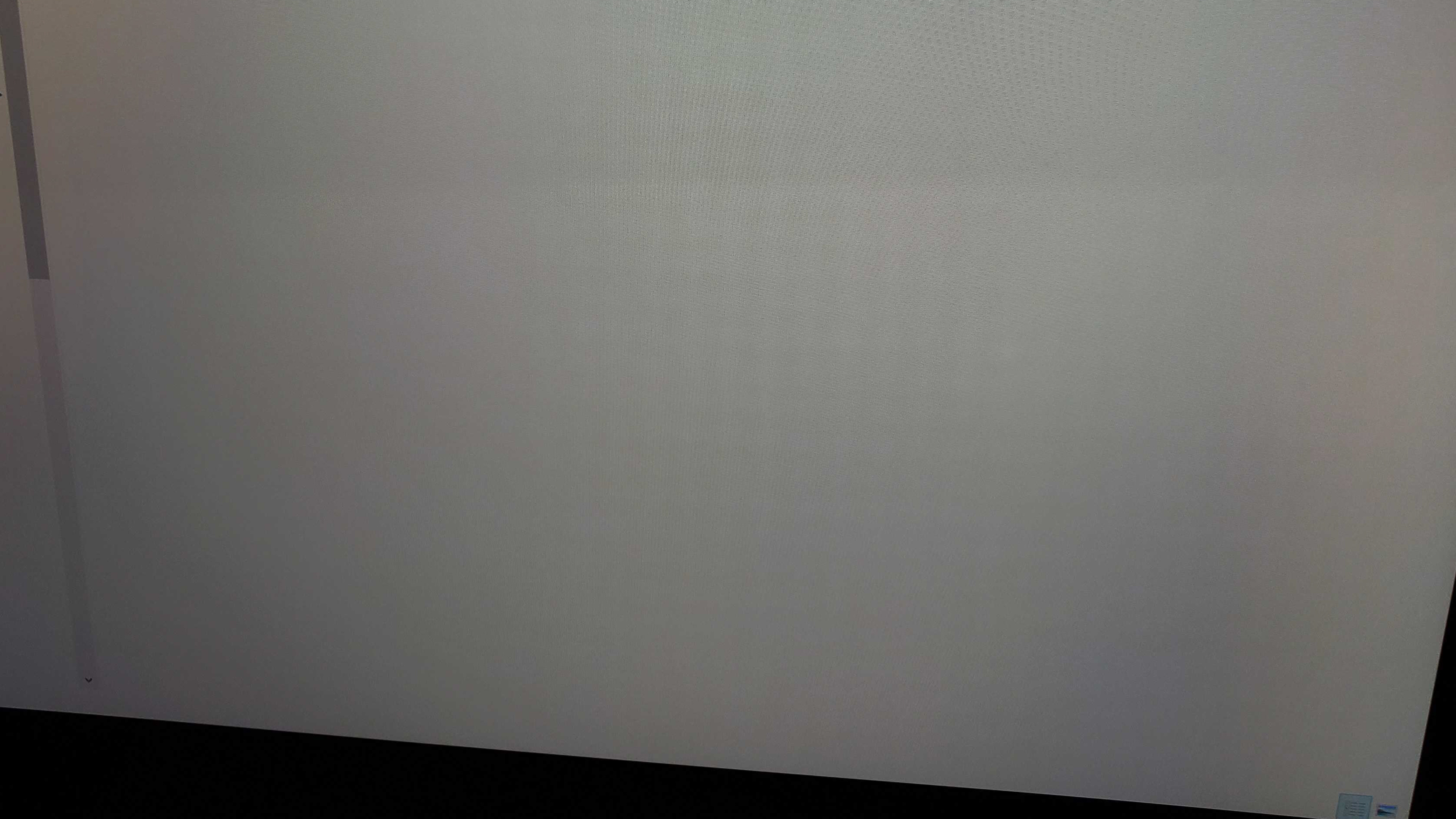

What kills OLED for me is potential burn in and reported less than stellar font rendering. At current prices they would need to last 10 years at least and I don't see any of them making it even half as long without burn in. I use my monitor at least 12 hours a day most of it being on static images. Unless they come down in price to be cheaper than a non FALD IPS screen or they manage to actually fix these issues it's a DOA technology for me for monitor use even though I was looking at it as the holy grail 10 years ago. It promised a lot and failed massively in the delivery department. FALD is much newer tech and seems to have solved most problems already so looks like a much more feasible approach that only needs to come down in price. Time will tell, until then I'll keep living with non FALD LCD shortcomings which for me personally aren't deal breakers, just annoying.
Reactions: Senn
- I'm concerned about burn-in, but I've read from multiple users OLED has come a long ways in this regard. This is a concern, but it's been so long since I've tried an OLED since that first TV burn-in experience, I wanted to give it another shot. I am taking some burn-in prevention measures, but none I find too inconvenient. It's no big deal to have the screen go off after 5 minutes or hide the taskbar/go full screen at times. I changed the desktop background anyways. Still getting used to not showing all desktop icons, but it was a small adjustment.
This might not be such a big issue on newer panels but it can still affects users. For example users who choose to deploy burn-in mitigation actions are affected by the mere fact they worry and have to make compromises.
Personally I would be more confident I can stop worrying if OLED burn-in tests showed no burn-in after two years.
- I'm not extremely well-versed in bit depth precision at lower brightness levels; that said, I haven't noticed anything specifically on dimmer images.
When using very low brightness levels gradation is not perfect. Not an issue at medium to high brightness, even in dark images.
Also not very big issue and then it could be easily resolved with dithering - though at the cost of having some dithering noise.
- I haven't really noticed any near black chrominance overshoot issues on my LG, and Vincent's recent review mentioned it being kept to a minimum, so I'm not sure how much of a problem this is on newer panels.
Still WOLED panels exhibit this issue and when brightness is low it can be spotted in certain situations.
