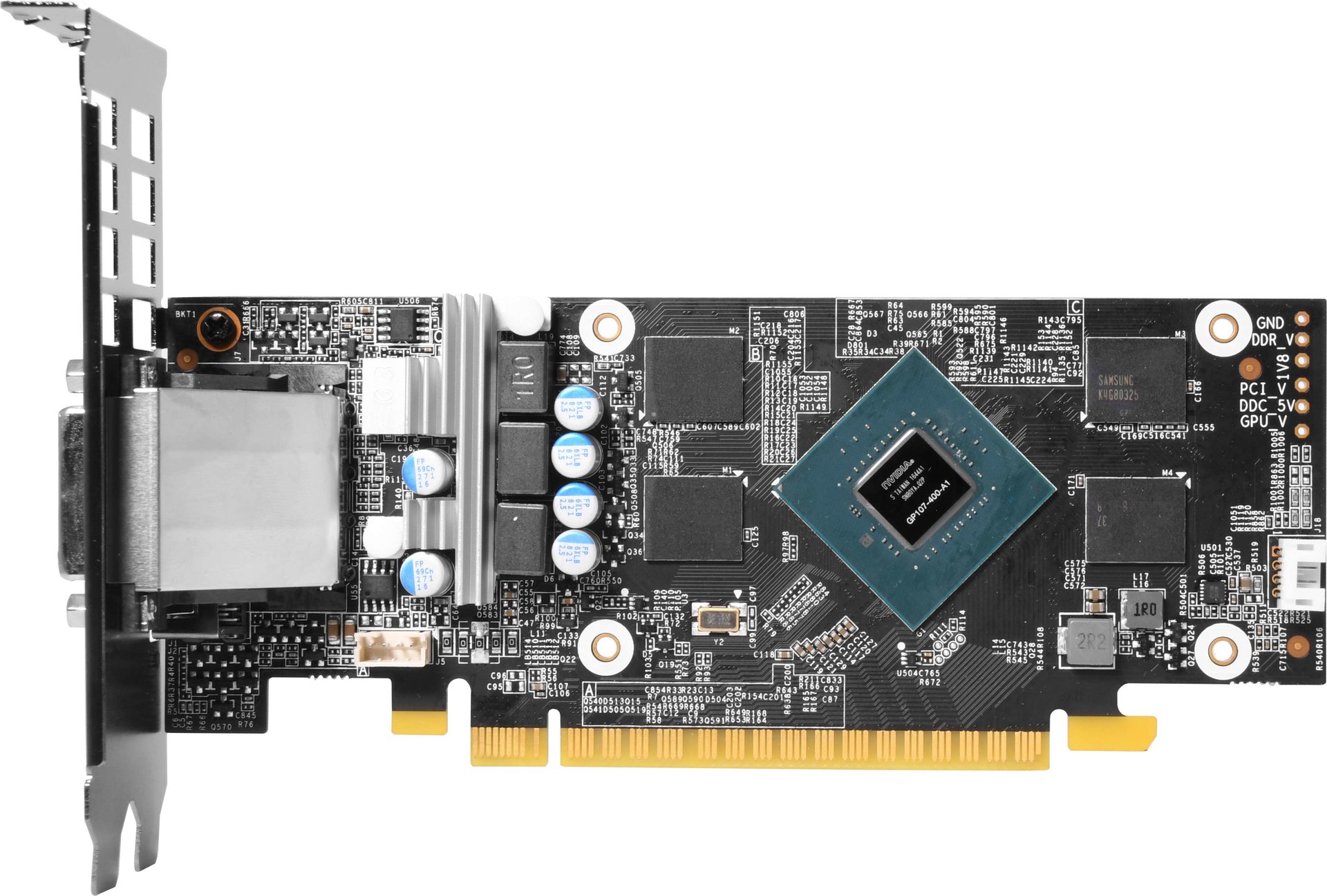

I think I could, with the right tools, but the low-profile cards typically have non-standard chip cooling solutions.
This is a GALAX model, but I think it's pretty common among low-profile cards:
The mounting points for the heatsink span the entire card. I think I could probably fabricate a simple plate bracket to secure a universal block to the GPU, but then mounting heatsinks to the RAM chips becomes a problem.
Hmm. Maybe some metal spacers could be attached to the RAM chips using double sided thermal tape, and then touching the block on the other side?

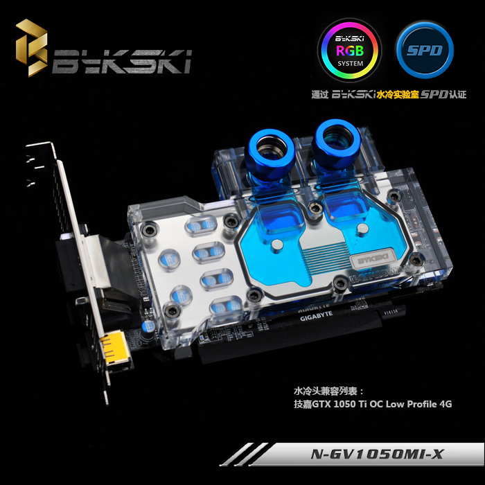

Leave it to the Chinese aftermarket!
Bykski-N-GV1050MI-X-GPU-Water-Cooling-Block-for-Gigabyte-GTX1050Ti-Low-Profile-4G.jpg
Now to decide if I try to exchange the MSI card for a Gigabyte one.
Anyone ever use any Bykski blocks? They look decent but I haven't seen any reviews on their stuff.
They Gaines notoriety as being one of the first to come out with a Threadripper block, but I had never heard of them before that.
I vaguely remember Kyle talking about getting one to test it for the TR. Do a quick search on the main news page. He might have actually done it. Can't remember.
