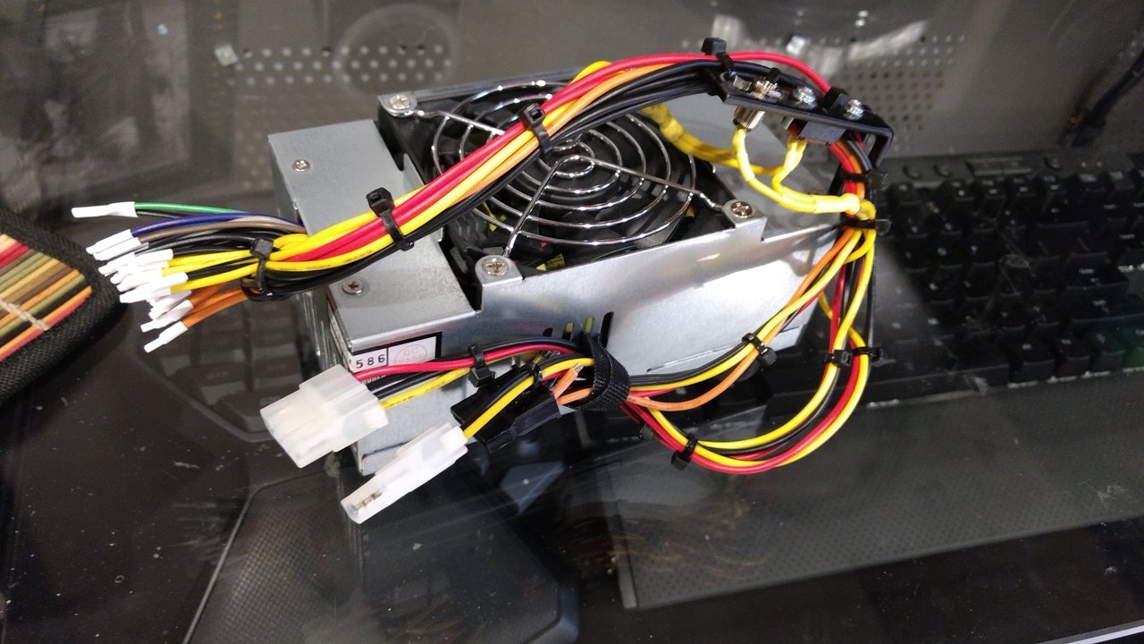

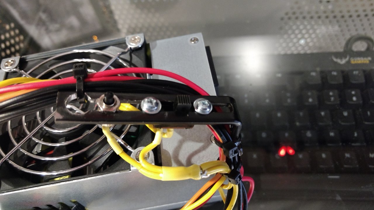

I had a small form factor power supply lying around with no destination, so I took the wire cutters and soldering iron to it! =)
The 12v wires traveling to the molex and SATA power plugs are paralleled through a SPST on-off switch and a SPST momentary pushbutton:
...for "pump jog" and "pump run" functionality. All those other pesky wires were chopped and capped, except of course the start button wires, which were soldered together.
Some felt feet on the bottom make this a cute, compact and handy little unit for loop flushes and refills. =)
Nice.
I also use disused sff power supplies that came with my Antec HTPC cases for water cooling flushes and fills.
I decided to use picopsu's with these buds instead so the PSU's that came with them were not being used.
I haven't modded them though. I just stick a paper clip in the motherboard connector to turn them on and off.
