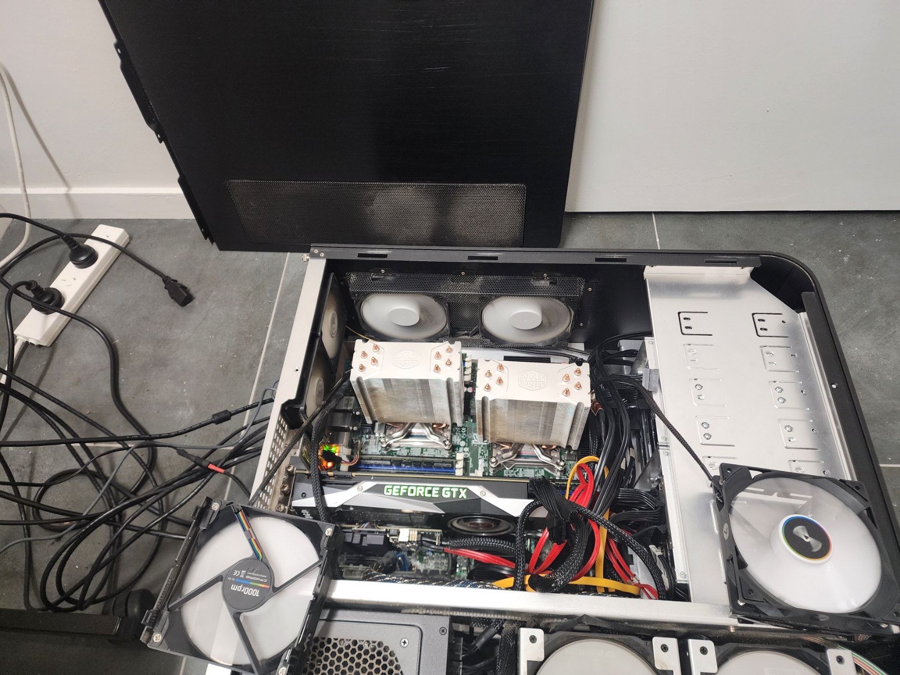

I decided to see what was available on ebay and found the best CPU this board will take for a pretty reasonable price; the E5-2697 which is 12 core 24T CPU @ 2.7Ghz, 3.5Ghz boost clock. The v2 also supports faster ram so I ordered a 256GB (16x16GB 1866MT) kit and finally an Intel X550 Dual 10GB Nic. I went for the x550 chipset instead of the cheaper x520 for 2.5Gb support. I'm not sure if I can source the Ubiquity 10Gb SFP+ modules right now as all the local suppliers are out of stock.
I will post pictures when I install everything.

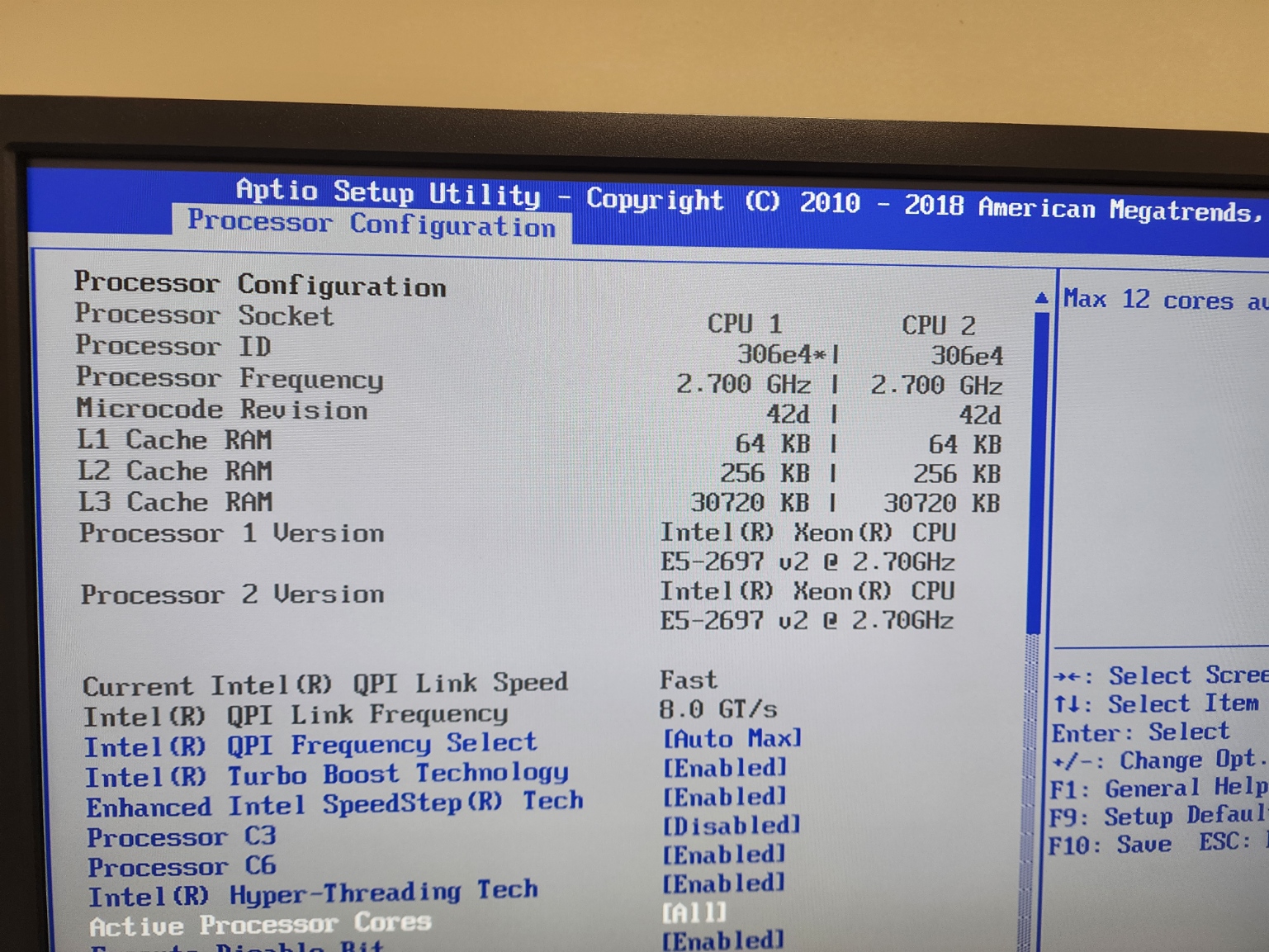

CPUs installed and running. Somehow it feels much snappier which I was not expecting. The new CPU's have 10MB of extra L3 cache as well as the extra 4 cores at 100mhz extra base clock.

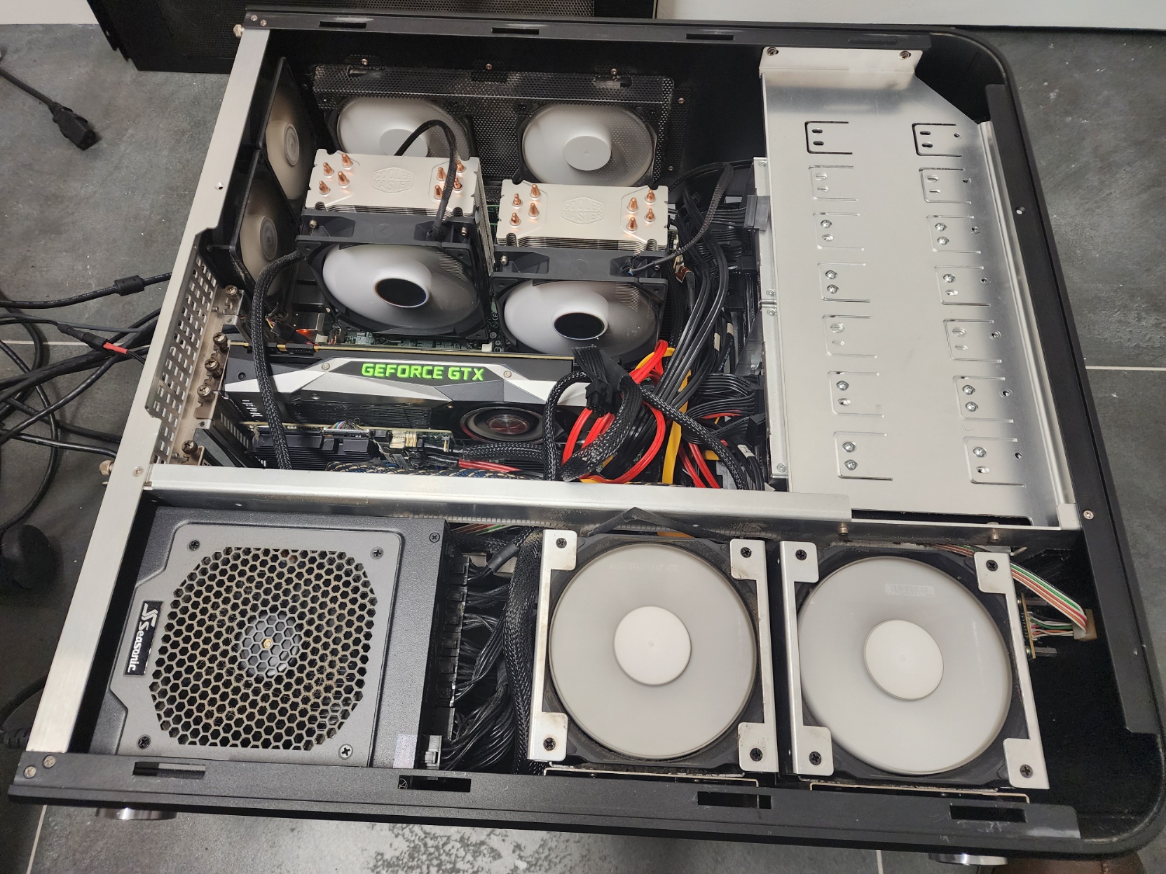

Feels roomy.

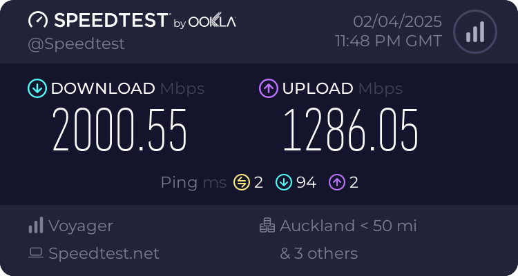

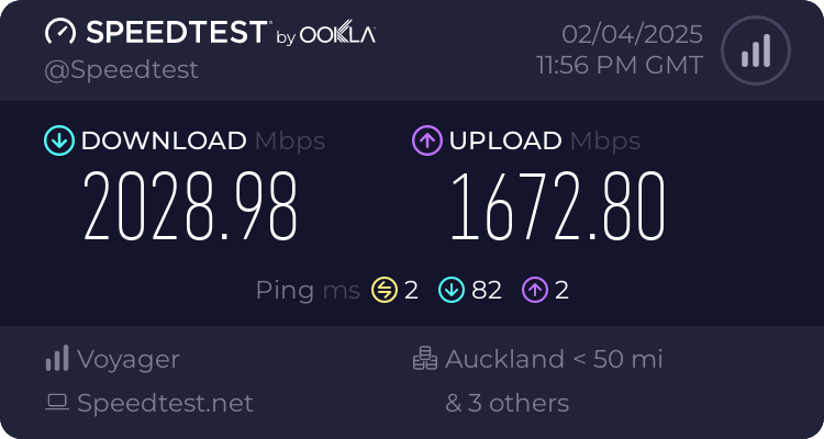

Edit: So it turns out disk speed is my major bottleneck for internet speeds. After upgrading to an NVMe drive I can now max out the upload.

This one is receive buffer related because the download ping is high and upload ping = idle ping.
If it was hard drive related up would be effected.

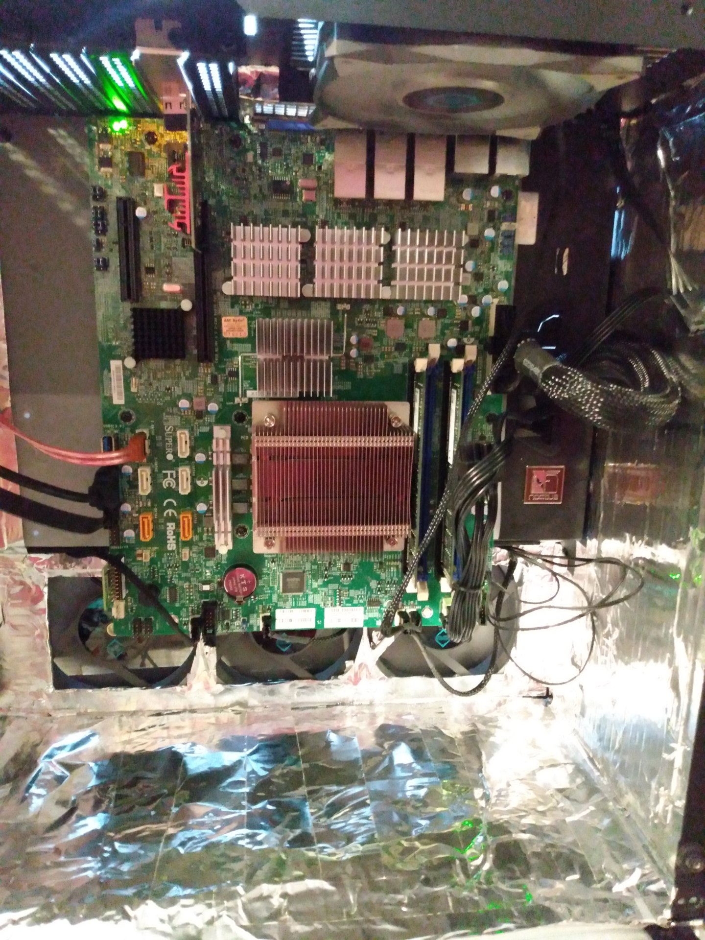

My central air with the shortest run of the upstairs hvac system blows cool air at the modules in the Spring, Summer, and most of the Fall. I turn the vent off in the Winter and run a fan.

What board is that? I thought I saw something similar on Ebay, but it only had an older Atom CPU (like old D2500 ones, not C3758 ones).
