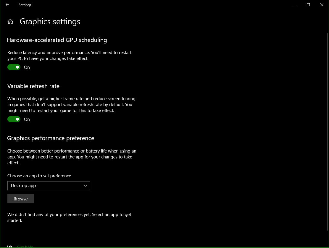

Maybe fiddle with these settings?

I have the scheluder off, default that is. Currently no VRR screen connected, just my 4K TV. But I'll try turning the scheluder on and see how it reacts.
