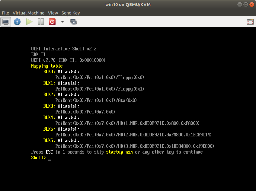

I have set up IOMMU and isolation of the 1070. Messed it up at first, but corrected it using the recovery shell. The game was getting started and so the TV kept stealing my focus. :)
Also created the virtual machine, several actually, but could not get it to boot. That's where I ended up with for now:
I might get a Win10 image to run bcdboot and... fix up booting. I have a relatively new image from a different language... it might work for bcdboot, I guess.

I forgot to mention that I used this guide when trying to get my VM to work: https://mathiashueber.com/windows-virtual-machine-gpu-passthrough-ubuntu/.
The fact that I couldn't get my P2V Win10 to boot doesn't mean anything. I found it informative, easy to understand and to be more up to date than anything else I could find.
I would only suggest a change to the way the PCI IDs are looked up. There's no need for a script or anything close to that. lspci -nn (or -nnv as proposed later) should give ample information to get the sought after PCI IDs, as it can be seen later on. But I guess I have the advantage there as my previous position at work required the hunting of PCI information for all kinds of hardware.
For the IOMMU information, the script is useful, but that information is not used later on in the guide, so it seems like overkill.

I had the same case as my Windows 10 and OpenSuse. To make Windows 10 VMDK I run Starwind V2V. Once I had OpenSuse installed and configured, I made an installation of VirtualBox over KVM as it just makes earlier to set up Bridged network connection (KVM is a server-grade hypervisor and lucks on WiFi support). And VMDK has fair support by VirtualBox. The set up works fine for almost a year (since Jun 2019).
