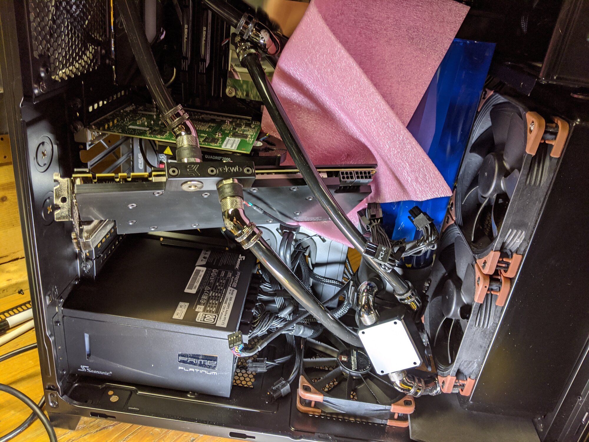

not really any quick easy way to pull the gpu out either? even though you already unplugged the power to it? really starting to look like a bad board at his point...suck to cause thats the most work to change out.....i find it very unlikely a bad cpu could have any effect like this...time to pick up another board it looks:(
Well, it isn't pretty, but just for a momentary test with another knowm working GPU it works.
I removed all my PCIe cards (Pascal Titan which is dangling, Sound Blaster X-Fi Titanium HD, Dual Intel x520 10Gig Ethernet, and old Intel 750 PCIe SSD.)
I disconnected power to everything except the 24 pin motherboard ATX connector and the two EPS connectors.
I temporarily installed an old Nvidia Quadro 2000 known to work from another system.
Plugged it in, and exact same thing as before. Motherboard LED briefly lights up. On board power button stays red until pressed when it goes out and nothing further happens.
The only thing I haven't been able to test is the RAM. This is the only DDR4 system I have accesss to right now, so I have nothing I can steal RAM from even for a short test.
I guess the next step is to disassemble everything out of the case and see if I can get the motherboard to respond out of the case, and if not, a motherboard RMA is in order.
