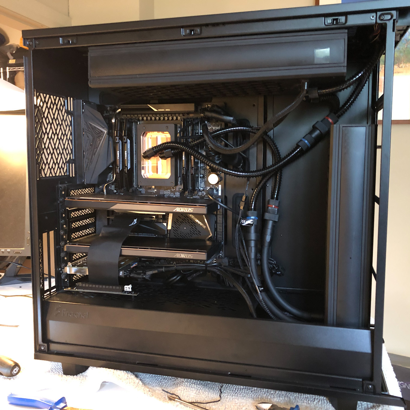

hi,
I have the same case for my SR-2, I looked at using it but I could not fit the two Alphacool extreme 280 I have.
I also have a smaller and newer Fractal Design Defime 7 XL, with some tweaking I managed to fit them in
note: new to water cooling, sorry for the mess

hi,

Hi tived,
Nice system you have there...and speaking of the "mess"....I will care less about fancy look...then important thing, to me, would be the overall efficiency of the system...so, if it work as it should, then its perfect !
I pay particular attention to avoid all the RGB/LED/etc.. kind of stuff....they would give zero increase in performance efficiency...and in the end I don't like them...it look like to be in a Discotheque kind of place...not for me ! :)
One question...how many drives you have installed in this PC ? Where ?
Thanks !
It currently has 6 NVME drives but room for twelve
4 on the motherboard
2x 4 on the AIC cards
