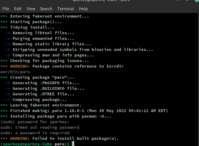

Thanks guys. Got it installed but it doesn't work. Cursor spins for a few seconds and then nothing. :dead:
I'm making the package. Looks like this is gonna take awhile.
:dead:
Hmmmm, I thought I did. Is that what fakeroot is all about?
At the very bottom it says you didn't put your password. Likely you just initiated the install and didn't pay attention. When it asks for the password for your account, add it in.
Nah, fakeroot doesn't give root privelidges, just allows making and manipulating files owned by root (without being root). This is used in package management to create archives with files which need to be owned by root and installed in root owned folders.
Makepkg is asking for your password after finishing the package build in order to install the built package (or before the build to install dependencies). The package manager (pacman) needs these privelidges to unpack the archive in the correct directories.
