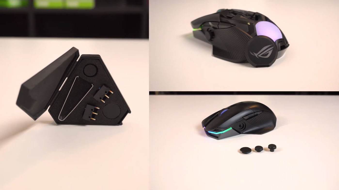

I saw this the other day, it has replaceable micro switches which is pretty cool so if you have that issue, you can pull out the switch and put another in.
it comes with a pair an extra pair, they are either softer or firmer than the ones installed.
It's a ROG mouse,
It's a ROG mouse,
