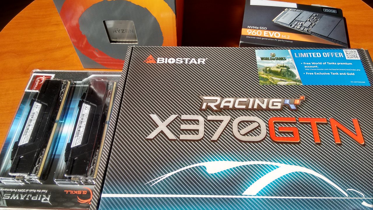

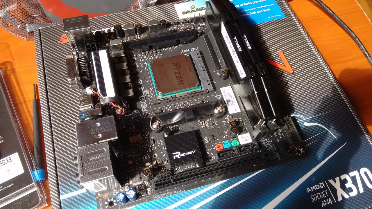

The X370GTN board is here :)
Quick check on RipJaws show that they indeed are fitting under the bracket, I'll make more photos later.
View attachment 25525 View attachment 25526 View attachment 25527

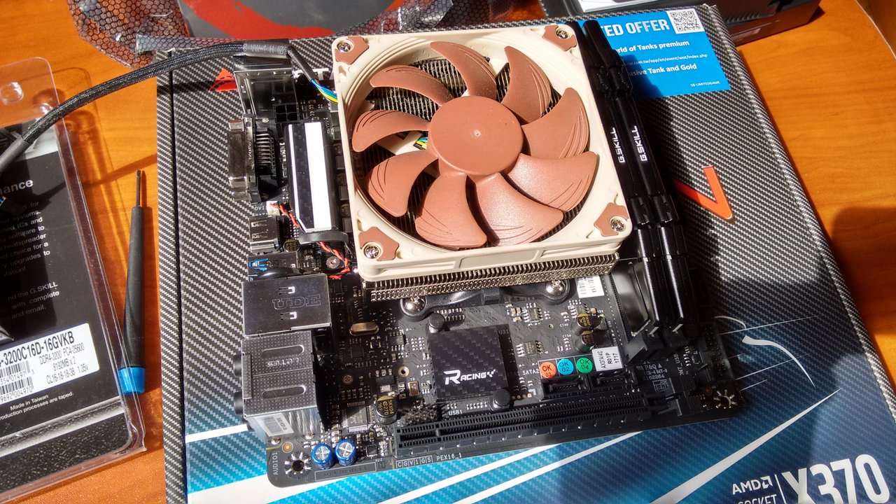

I did not install the cooling yet. I'll plan on using the noctua NH-L9i with custom designed bracket, before noctua's AM4 brackets are widely available.

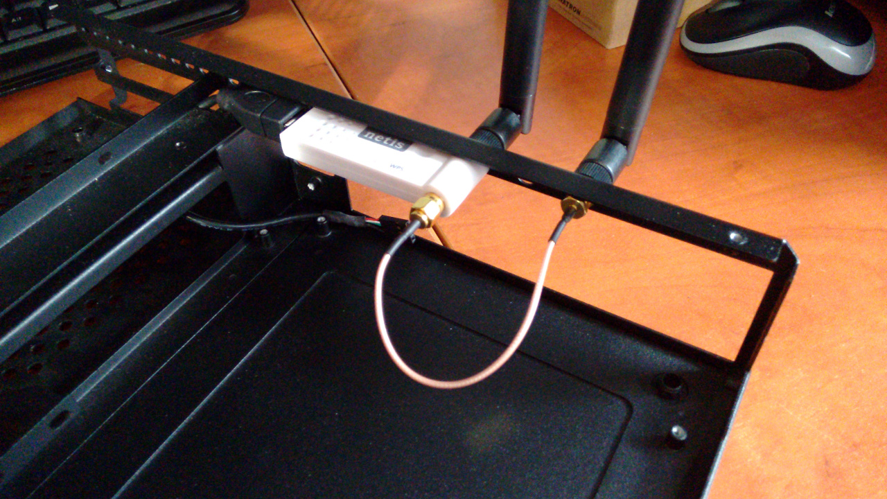

As for the wifi problem with X370GTN:
I think I'll figure something out :)

I've made a ghetto home made bracket (figured that noctua's bracket might come faster than I'd get my custom made ones) and finished the build:
IMG_20170524_124852979.jpg IMG_20170524_125815105_HDR.jpg IMG_20170524_125834013_HDR.jpg IMG_20170524_133501468.jpg IMG_20170524_133518478.jpg IMG_20170524_140130323_HDR.jpg IMG_20170524_140227796_HDR.jpg
Works so far, but I need to figure out 'how to Ryzen' because monitoring CPU temps through ryzen master app seams like a mess to me and at the same time I've got quite a lot of things to setup on new system.
I've done some quick tests for the rig after system was installed. few notes:
1) 40~42 degrees on silent idle on that noctua, 30~31 degrees when PWM is disabled (yeah, that's by default on X370GTN... )
2) quite stable 47~48 degrees on 1080p windowed Heaven with 1070 FE. barely 8% of load on CPU (just heaven), while solidworks was being installed in the background at the same time.
3) switching context, starting new app, some M$ background stuff when idle, all of those can shortly spike up the clocks and the temps will raise up to 50~54 degrees before the fan catches up and load is balanced
4) XMP 3200 on my RipJaws doesn't boot on X370GTN, hopefully yet...
