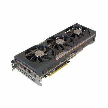

Anyone able to fit GPUs with 3 fans? What’s the biggest anyone has fitted into the sentry?
a guy got a 3 fan 1070 strix in a sentry, but he had to make some adjustments e.g. using lp power cables and clipping the ends off the sentry logo's screws
I had my Gigabyte Radeon R9-270X Windforce 3 inside Sentry and it was fine.
There are photos in our gallery with this GPU and tbh this card is quite big (but there is still place for something even bigger):
Gigabyte has still quite a lot of cards based on windforce 3X design. They just made different plastic shrouds on them for aesthetics. Those should fit, but check the dimensions. And AORUS cards will most likely NOT fit.

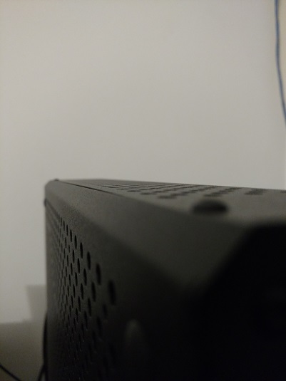

Another small issue I had was that I visually can notice that both my two Sentry’s are not standing straight in the vertical position. Probably this is a small bending offset because I checked my desk and it is 100% level and both my two Sentry’s have this issue. I solved this by putting under the two left side (seen from the front) rubber feet, an additional small 3mm thick rubber piece and this works fine for me.

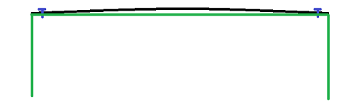

If there is a further revision, it'll be perfect if there's a third screw on the top / bottom panels.
As you can see there's curvature at the middle. Aesthetic nitpicking so no big deal at all though.
Just my two cents.;)
