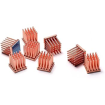

my Crucial MX300 1TB m.2 was around 63C on idle, so yesterday I added some cooling to it - three 15x15x1.5 mm copper shims attached with thermally resistive adhesive (so it has a bad heat transfer) and a thermal pad on top of it, to connect this to backplate of my case. Now my idle temps stay at 50C.

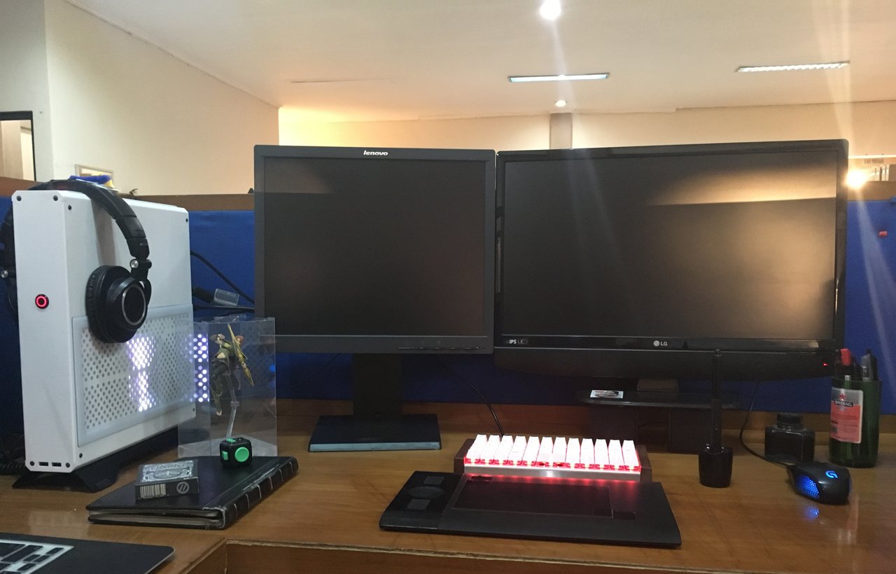

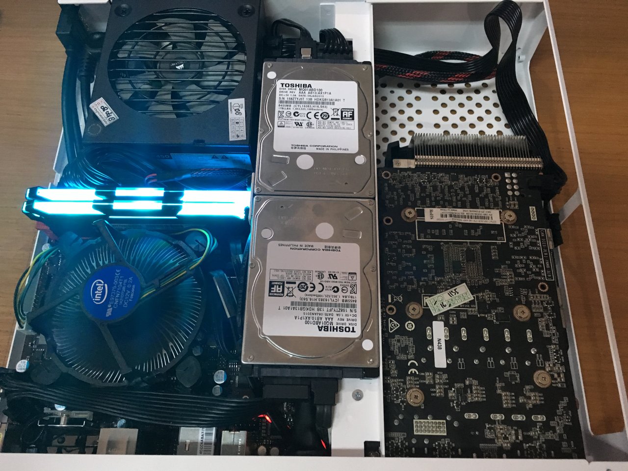

Finally my Sentry is built. Below are photos of the build and the specs:
Specs
CPU: Intel - Core i5 7500
Cooler: Intel Stock
Mobo: MSI - B250I Gaming Pro AC
Mem: Corsair DDR4 Vengeance RGB PC24000 16GB
GPU: Zotac GeForce GTX 1060 AMP Edition
PSU: Corsair - SF450
SSD: Samsung - SSD 850 Evo M.2 500GB
HDD: 2x 1 TB Toshiba
Photos

View attachment 32049 View attachment 32050
Is that an office or home?
