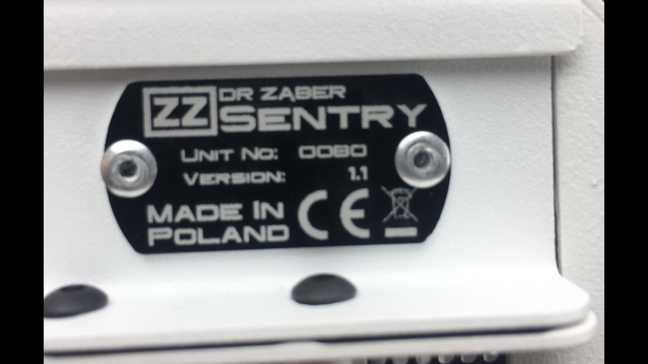

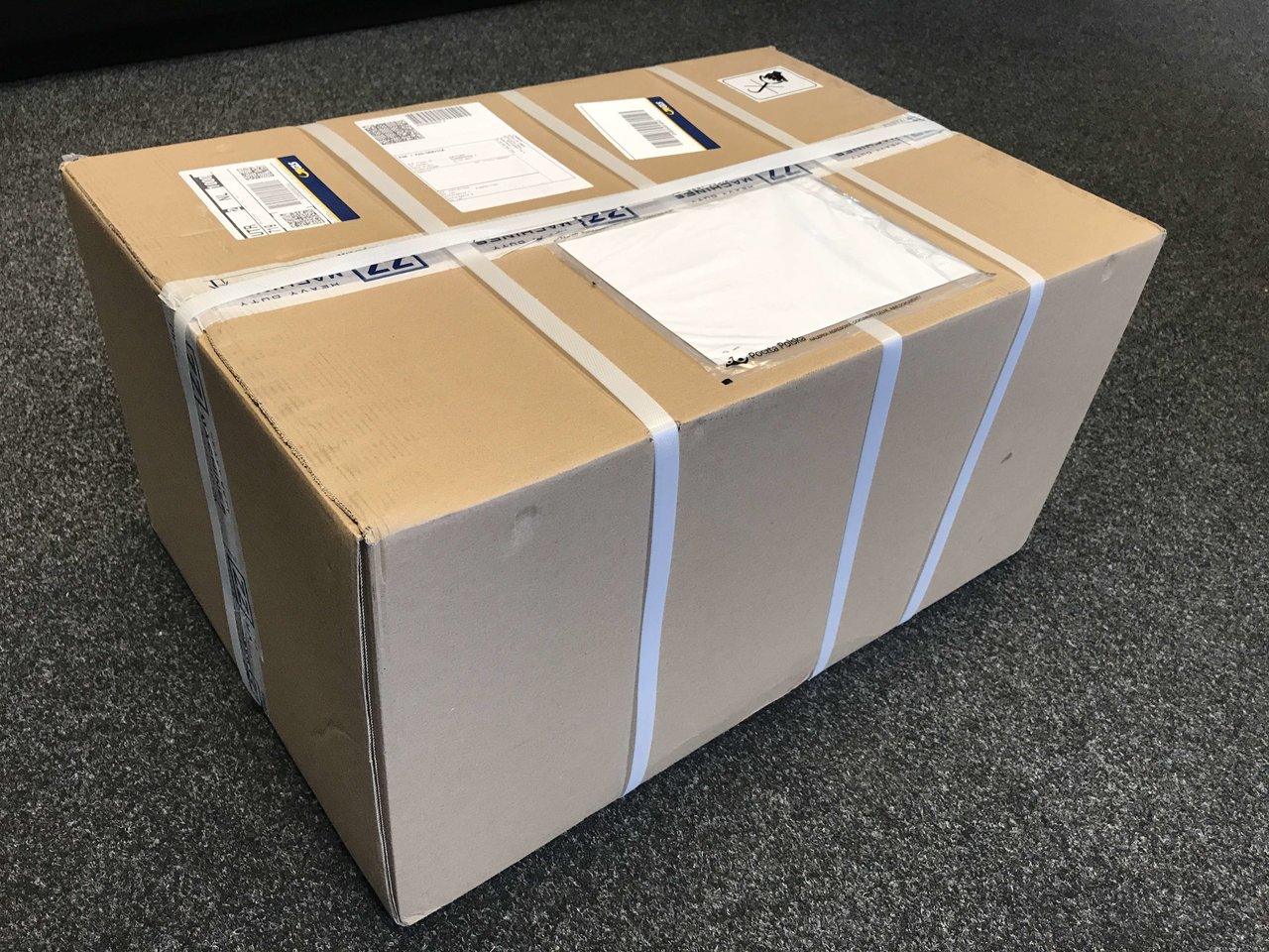

Received the track & trace mail on 20-07-2017 and received the shipment last Wednesday 26-07-2017 in The Netherlands (5th shipment, two black Sentry's Unit No. #0631 and #0677 with Order No. #862).
The package and content are in excellent condition, big thanks to the Sentry team!!
Soon I will order all the components, it’s definitely going to be a Ryzen 1700 setup :)
