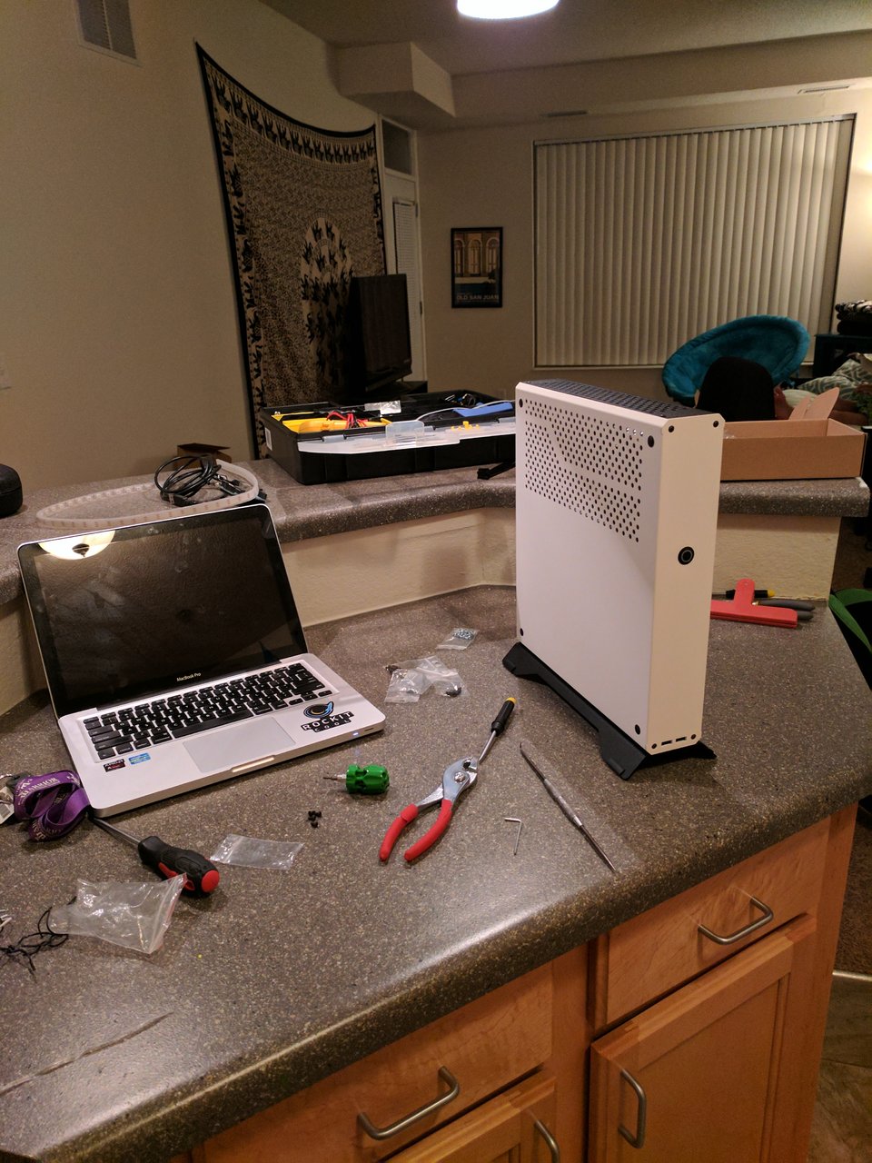

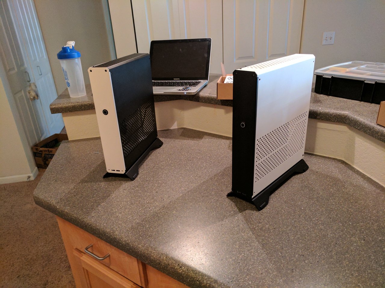

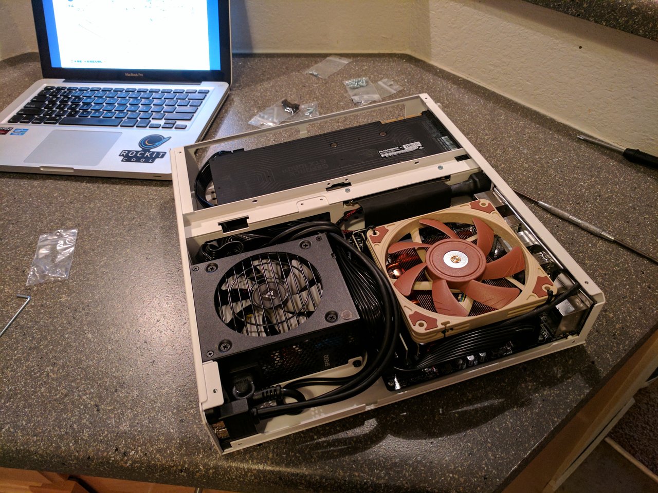

We made it w00t! The sentry is finally here and looking interesting I must say. Shipping box was in good condition, no broken parts. Friend of mine has yet to pick up his half (the other sentry case). Enjoy the photos of my build. Thanks again Dr. Zaber team, this case is amazing and you all were outstanding!!!
Specs -- maximum gaming performance crammed into the smallest possible case. w00t.
CPU: i7 7700k delided w/ thermal grizzly conductonaut
Cooler: Thermolab Cooltek LP53 w/ Noctua NF-A12x15 PWM (120mm slim fan held down with twist ties)
Paste: thermal grizzly kryonaut
Mobo: Asus z170i Pro Gaming - got it for $100 open box at microcenter, otherwise would have went z270
RAM: G.skill value 16GB (2x8GB) 2400mhz CL15
SSD: 1TB samsung 850 evo m.2 form factor
GPU: evga gtx 1080ti founders edition
PSU corsair sf600
Which combo do you guys like better??

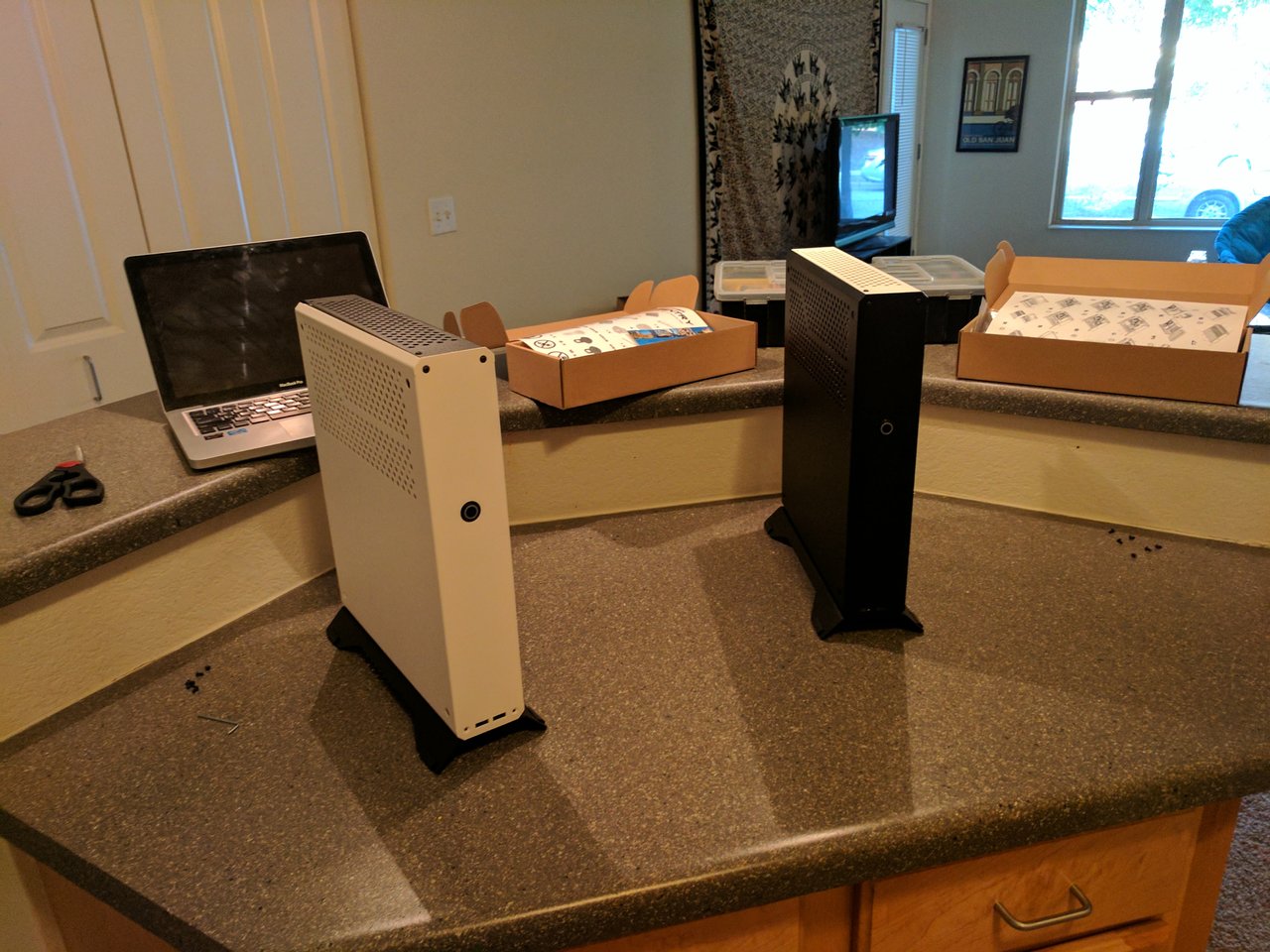

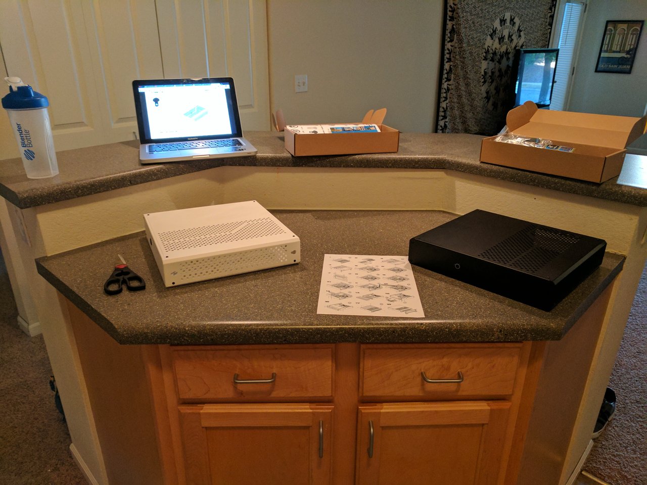

Oh the heresy! :D

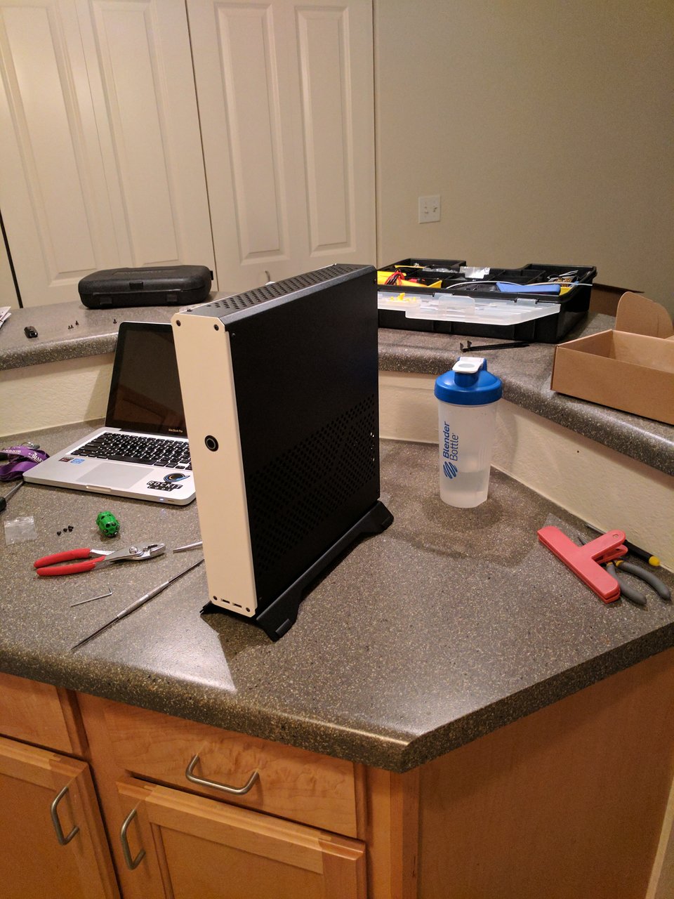

Did you really order two cases just to do that?

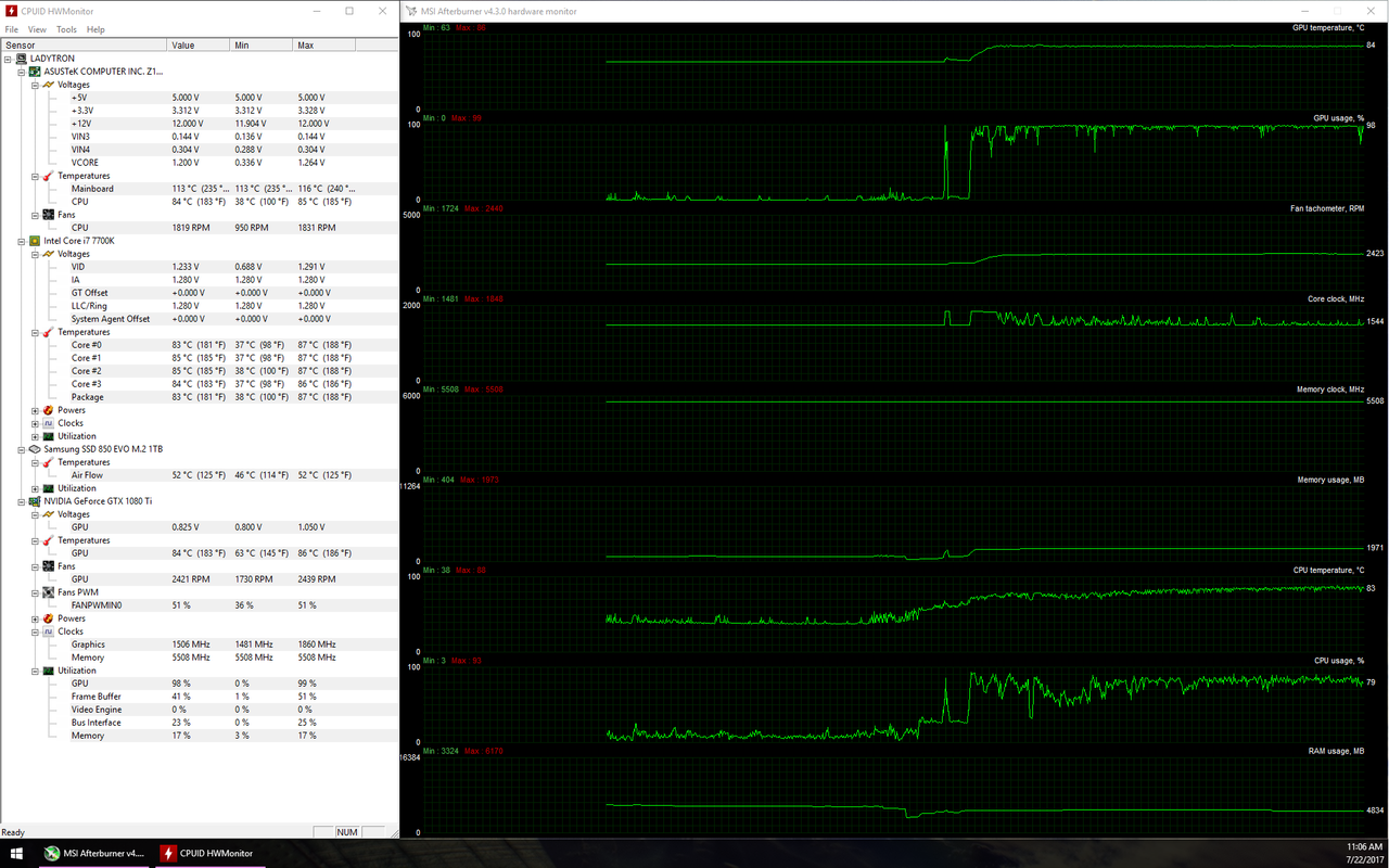

See attached screenshot during Crysis 3 "Welcome to the Jungle" grass level stress for ~8 minutes.

Correct, the 7700k is delided. However, this gaming test was during the Crysis 3 grass level torture test, this stresses the CPU a lot. Gaming in something like Overwatch or Doom holds the CPU temps at around 65-70C.
The 120mm fan is actually off center where the bottom of the fan meets up with the bottom of the fin-stack of the LP-53. Also! I do have an NF-A9x14. I will try that but it has significantly lower static pressure and airflow than the 120mm. Do you think something like a paper/plastic fan shroud would help temps eventhough the fan is quite close to the side of the case already?

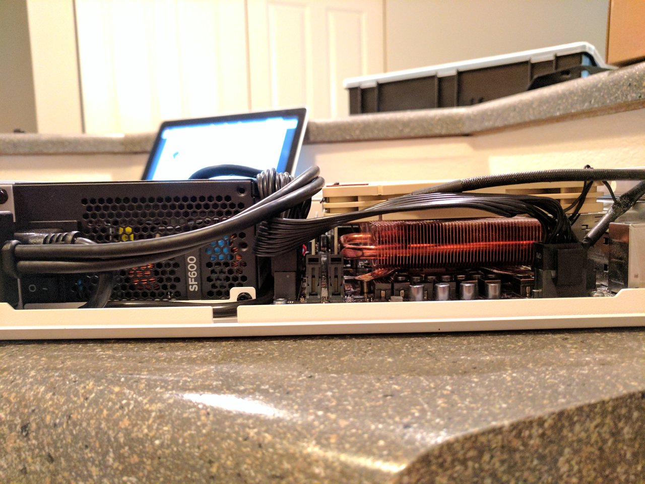

Got mine last Thursday. (2nd batch of Sentry's, 1st batch of white Sentry's. Sentry #88, Order #422.) I have all my parts in it, however I'm still waiting on CableMod PSU cables and my Noctua AM4 bracket. I will create a write up and have some pictures once I get everything in. I'm also waiting on the RGB button and my custom PCB to come in.
Packaging: http://imgur.com/a/k8tsh
PC Part Picker: https://pcpartpicker.com/user/StevenMattera/saved/H8PMpg
Specs:
AMD - Ryzen 1700 3.0GHz
Noctua - NH-L9i
ASRock - Fatal1ty Gaming x370 Gaming-ITX/ac
G.Skill - Flare X Series 16-GB running at DDR4-3200
Western Digital - Blue 1TB M.2
Samsung - 850 EVO 500GB (Mounted in front of the GPU)
Gigabyte - GeForce GTX 980 Reference Cooler (The idea is to upgrade this to a ASUS GeForce GTX 1080 Ti Turbo and give this to my wife and SLI her GTX 980.)
Corsair - SF 600W
