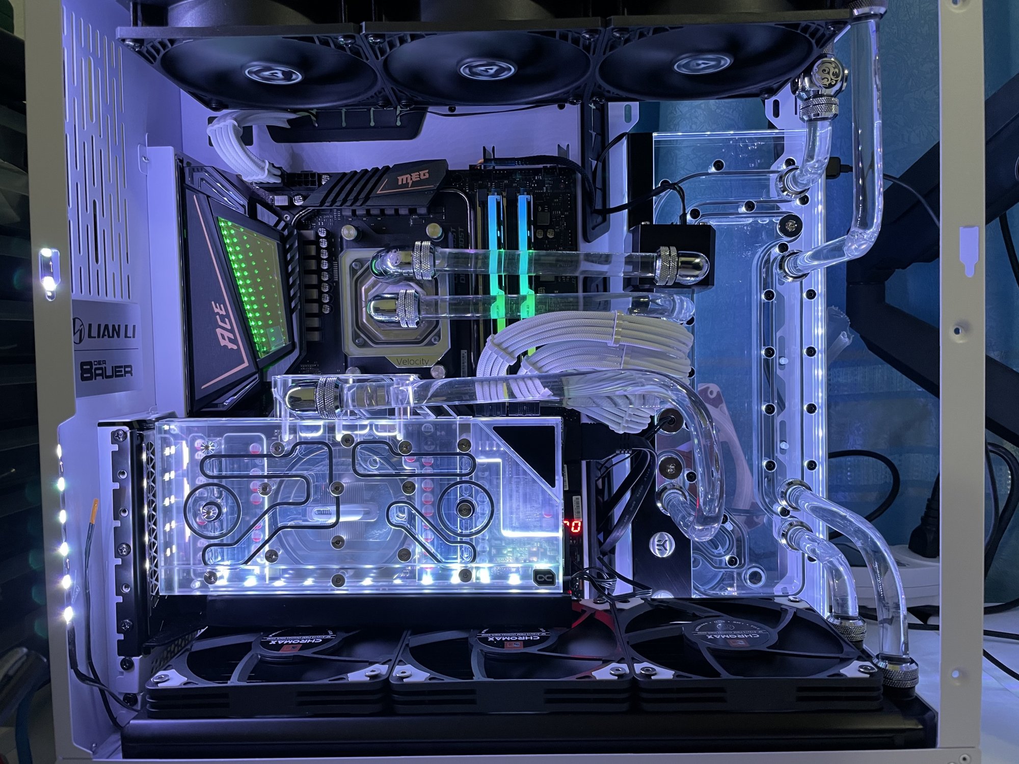

I was running and flushing my loop this week with distilled water to try to get the remains of the EK coolant out and I finally stripped everything down yesterday to finish cleaning the loop. The ek cpu waterblock has some discoloration and my alphacool rtx waterblock looks perfect. Wonder if this is normal?
I think I am finally done. I added in the Aquacomputer Flow sensor and a T on the top rad to help drain the loop.
I want to thank everyone for helping me out with this build. Its been a long long build (1 month+) and its been a lot of fun but a lot of headaches too.

I would say that cpu block looks just fine. It is nickel plated and there will be some wear/discoloration from any exposure to elements.

Hi!
I cant believe how lucky i am you made this post! Im gathering parts for custom loop, i have a 5900x (bykski block) 3080 (alphacool block) ,same mobo, same case (black), also some p12 fans and same distro and i ordered the same rads. And i was wondering the same thing. So do you have any issue with the 2x360 gts rads running on the g1's ddc 3.1 pump?
Also how did u manage to have the gpu block vertical? What fans and gpu bracket did y use?
Please help!!!!
///AMG
Sep 19, 2012
3,521
Hi!
Please help!!!!
I don't think there are any problems running the G1 ddc 3.1 pump other than maybe cooling it. I bought the metal heatsink cover for mine and I use a Noctua A12x15 behind it to cool it. I've seen some Flow rate goes from 30 l/h to about 70 l/h 50-100% pwm. I don't really know how its supposed to be since this if my first build ever with a flow meter. If you buy direct from EK it comes with the 3.2 pump, I didn't know this and bought from Microcenter.
For the Vertical bracket by far the best one is the EK Vertical Mount. I tried the Lian Li made for the O11, Cable Mod and Cooler master. The EK is by far the most well built and fits extremely well.
I used the Noctua A12x15 Chromax for the bottom rad (clearance is a few mm for the vertical mount, if you use 360GTS and 15mm fans you will have to buy countersunk screws because the screws that come with the rad wont fit they give you screws for 25mm fans), and P12 PWM PST for the top rad. I honestly think I should have went with a thicker rad on the top, honestly I might still do that.
Only thing I have a problem with really is draining the loop, I had to put a T fitting on the top rad so I can drain it faster. Performance wise my GPU stays around 50c max (3080 boosting to 2050-2100 mhz core and +800mhz on mem.) and CPU with CO around 80c max 5150mhz max single core clocks.
I got mine from a local retailer, ek wont have it in stock until april here in EU. I was thnking swapping pumps, but if it works im happy. I wont oc aboce 5ghz and i will have the same gpu clocks i assume.

What do you mean problem in draining.. i ordered a little valve to put in the back, isnt this enough? How is the t fitting gonna help?.. i will buy the metal cover for the pump then.. which one did u get?
Sorry for bombardment of questions
Yea the bottom port in the back only allows you to partially drain the loop. I found it mostly drains the middle of the plate and some of the GPU since the GPU is first in line and is directly connected to the pump so it can drain back to the middle of the plate. But the CPU and top rad if you use them will not drain into the middle of the plate without some help.
Problem is caused I think by the 2nd rad since the middle part of the rad you use a plug to open is not at the top of your loop. I put a T fitting on the top rad so I can drain the rad and use a pump to push it out. Also be careful with the ball valve to put in the back have to measure it carefully you might have to put that in by taking out the pump first but since you are swapping out the back cover for the metal heatsink you should do that while you are at it. I ended up putting a quick disconnect fitting on that back port instead it is IMO much cleaner that way.
I learned all this because of the constant draining and filling I had to do to clean out the EK Coolant that left a lot of gunk in my loop. Also if you don't have one already I highly recommend getting a leak tester. Helped me out a lot, I also use it to help drain the system.
EDIT: Also, I wanted to add another flow meter from aquacomputer so while I was at it I also ordered the 3.2 DDC pump. I will let you know the difference in flow when I swap it out if you want to know.

So I got the EK DDC 3.2 PWM Elite and swapped it in. I was wrong about the flow rate for the ddc 3.1 that came with the distro plate. I was actually getting about 43-46 l/h running it at 100%. The ddc 3.2 can get up to 62-63 l/h. Temp wise there is a improvement of a few degrees under load but the biggest difference seems to be after load and idle. Water temps drop a lot quicker than the ddc 3.1. Idle CPU temps dropped 10c (though I did also reapply the cheap corsair thermal paste for Kyronaut so I can't really attribute it all the the pump). So I guess its up to you if you want to spend the extra.
I've been logging data and it seems like the water temp going into the GPU and out has a delta of 1c and after it flows into the CPU and out there's a 2-3c delta. I've been contemplating getting a thicker rad on the top and see if that helps drop water temp under load. My water temps can get up to 45-46c when gaming.
