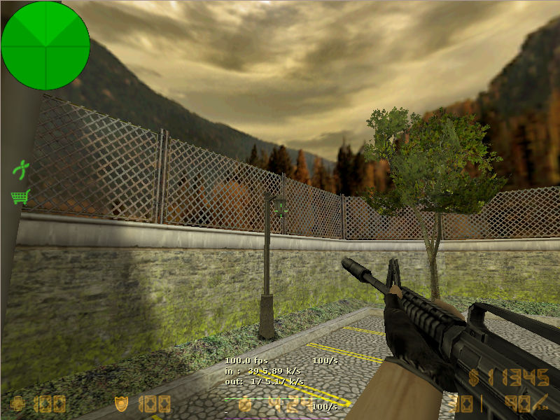

i tested the 2333t with some first-person-shooters yesterday
imo completely unplayable
not only because of the general blurring
fencing like in my picture is constantly flashing dark and bright while moving
http://f.666kb.com/i/brja9vw9dnc8w6h08.jpg
you better don't have epilepsy trying to play with the 2333t
its still great for surfing, watching movies, reading, programming
very pleasant picture
Your issue seems more like a driver or game issue.
no it looks perfect on my crt
2333t owners can open the image and move it around in their browser/image viewer to see what i'm talking about

taking that image with the fence and moving it around on my Dell vs this samsung, yeah the fence flickers on the samsung and the additional response time blur is evident. For gaming as a primary monitor, nobody has denied there are better choices though.
