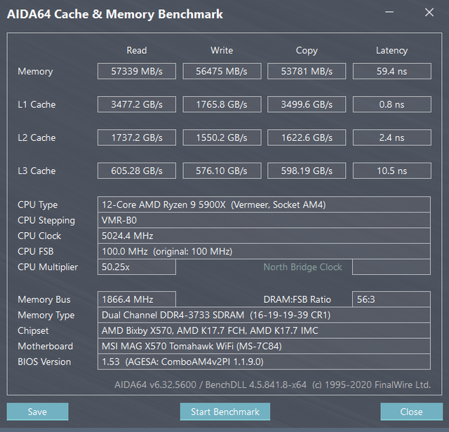

Slightly better results. Now testing -10 on first core and -25 on all other cores.
Also passed 10K in CPU Z MC. https://valid.x86.fr/h792y4
And slightly higher Geekbench score. Don't have AIDA since trial expired. https://browser.geekbench.com/v5/cpu/6318357

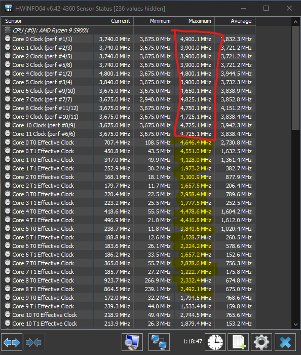

OK, question, in HWinfo, it shows Effective clock and (perf), which one shows actual clock speed?
Effective clock for me I think has never broken 5ghz, usually 4.8-4.9 is the highest It will go, where as PERF has hit 5.15 on my "best cores"
When running a 1-2 core workload, the effective clocks match what Ryzen master shows, and perf shows a higher number. I am confused :)
(red = perf)
(yellow = effective)
I don’t think effective clocks are correct representation of actually what the processor clocks are at a point in time. I just use the top one to monitor my processor clocks.
Alright, but just a warning, I have never seen Ryzen Master report the same clock as the Perf #s in HWinfo
(red = perf)
Ive heard that you have to look at effective , perf is only when you proc hits for a sec , but i think it doesn't work correctly
