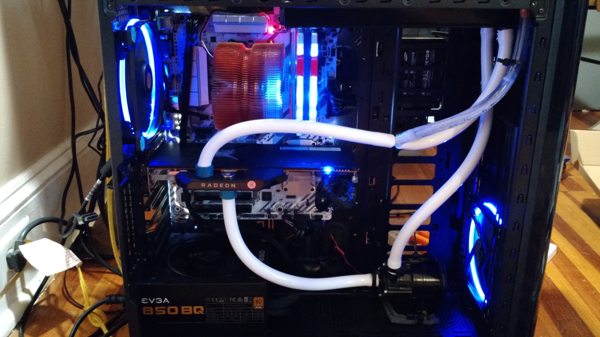

got back from spain at 2am last night....and this morning this happened
Was super cautious mounting block, I don't think I've ever handled a card that I was so scared to mount a cooler/block on...the whole hbm thing makes it feel super fragile.
Die has epoxy. Does not undervolt as well as my first card, crashes under 1150 whereas previous card was content with 1050. HBM seems to do 1050 without issues. have not pushed core farther than stock. Loading around 45c or so, silence is bliss.
