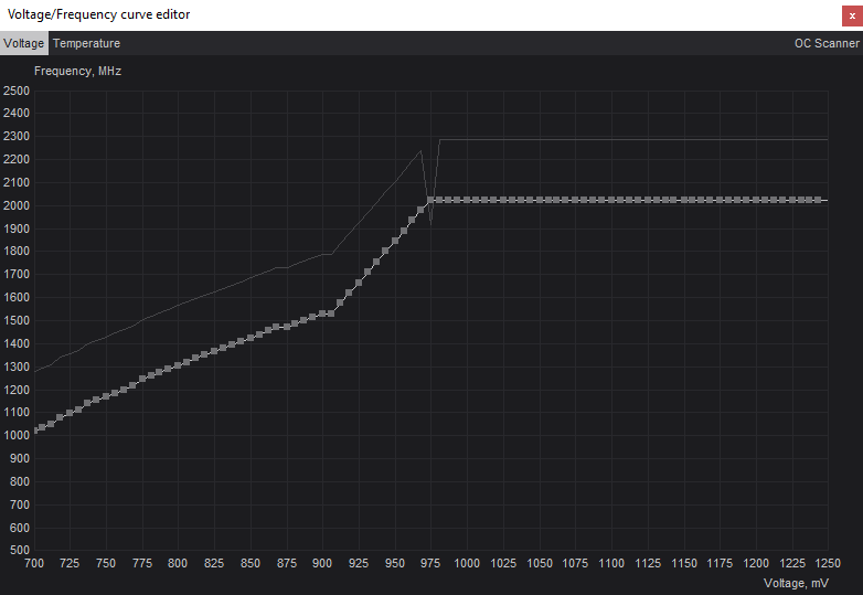

Hi,
i've just tried this curve on my Strix 3090,
https://zupimages.net/viewer.php?id=20/46/0edp.png
https://www.3dmark.com/compare/spy/15304171/spy/15274495
The score is not that much better than with 0.900 @ 1965hz and i got some perfcap reason pwr + pwr therm in gpu z even with maxed power limit
https://zupimages.net/viewer.php?id=20/46/qg3e.png
What does it mean for my card and overclock?
means you are power limited, and your card is getting hot. That curve you set is an extreme slope. Look at the first post step 6, a stepped curve should net better results.
The card wasn't that hot, 71c max
For the curve you mean it should be more regular? I have to set it manually? For the power limit is the limit coming from the gpu itself? Is there a way to max it? I see in gpuz that it hits 478 W so yeah I guess it's the reason but isn"t it very high for that kind of OC?

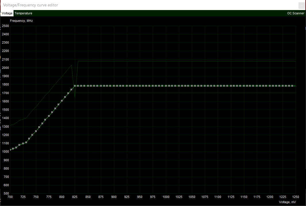

Here's what I did with my 3080 FE. I got crappy old 1080p monitors at 60hz, so 60fps is all I need. Does it in every game I've played at 4k DSR resolution. Main thing though is I have a Bitfinix Prodigy case and the 3080 gets hot unless I undervolt it. At stock it goes to 80c quick and throttles. I figure I didn't need those extra frames anyway since I got it vsync'ed to 60fps. Now the 3080 does 65 to 70 c and uses about 250 watts. I'm pretty happy with it. Now if only I can figure out a way to stick the 3080 in a NZXT H1 case and keep the temps down.

The question "what are we exactly doing" is quite open to interpretation, or maybe preference. Mine was to find a good mix of performance and power while being stable. Slightly lower average clocks than stock, massively less power.
Seems to me that under-volting, whether using the OPs guide or another, is just a way to find a balance between performance, power, and temps. For my 3080, the balance point is an 1845mhz shelf @ .85v. It's stable, and keeps the power much lower than stock. With benchmarks, the under-volt is about 97% the performance of stock, and 95% the performance of the max mostly-stable over-clock I could get, while using 92 fewer watts. Stock on the 3080 seems to be a factory over-clock. Not going to get much more out of it without a bios that provides more power and some water cooling, but even then, I can't imagine it being worth much in actual games.
Regardless of methodology used, a power limit curve will always beat the flat curve in overall efficiency unless you are running the flat curve at 700mV then at best it can tie.
I think this point is difficult to see and explain. I know we discussed it in depth. Simply, a curve set like in the OP that tops out at the factory boost clock will perform better in many cases with a power limit cap vs a flat curve, even at the same power draw. This is because you are not always power limited, some game engines are more or less efficient, level of detail, resolution, all factor into how much power the card will draw. So in cases where you aren't power limited on a flat curve, the method in the OP will allow you to boost higher while still remaining within the constraints of the power limit of your choosing.

are you ever changing any settings in afterburner such as power limit, fan curve, etc? Any time you make a change and apply it in afterburner, the curve gets reapplied, and as I said in the first post of this thread, the curve is not based on absolute frequency, but rather OFFSET. Therefore, if your profile is saved with +180MHz offset at 900Mv which nets 1965MHz, and the card was warmer when you made that profile, reapplying it or making any other changes in afterburner and clicking apply will reapply your curve, but being cooler, the card may have a higher baseline, so 180MHz offset is a boost bin higher because the baseline curve was a boost bin higher because of lower temperature.
Yeah, it looks like it was a matter of the boost bin being a step higher. I changed the offset and now get the maximum frequency to land where I want it. Thanks.
I'm noticing that the curve I set gets reset after a while, though. As in, it goes back to the stock curve instead of the specific frequency/voltage offsets I put in. I'm usually folding when not gaming (which has helped identify good long term stability incidentally) but when I come back, inevitably the curve is back to normal. Looking at the frequency editor shows nothing has changed. I am using Afterburner 4.6.3 beta 3. Anybody else seen something similar?
I haven't noticed going back to the stock curve, and I have done a mix of gaming, deep learning, and compute. Latest non beta.
