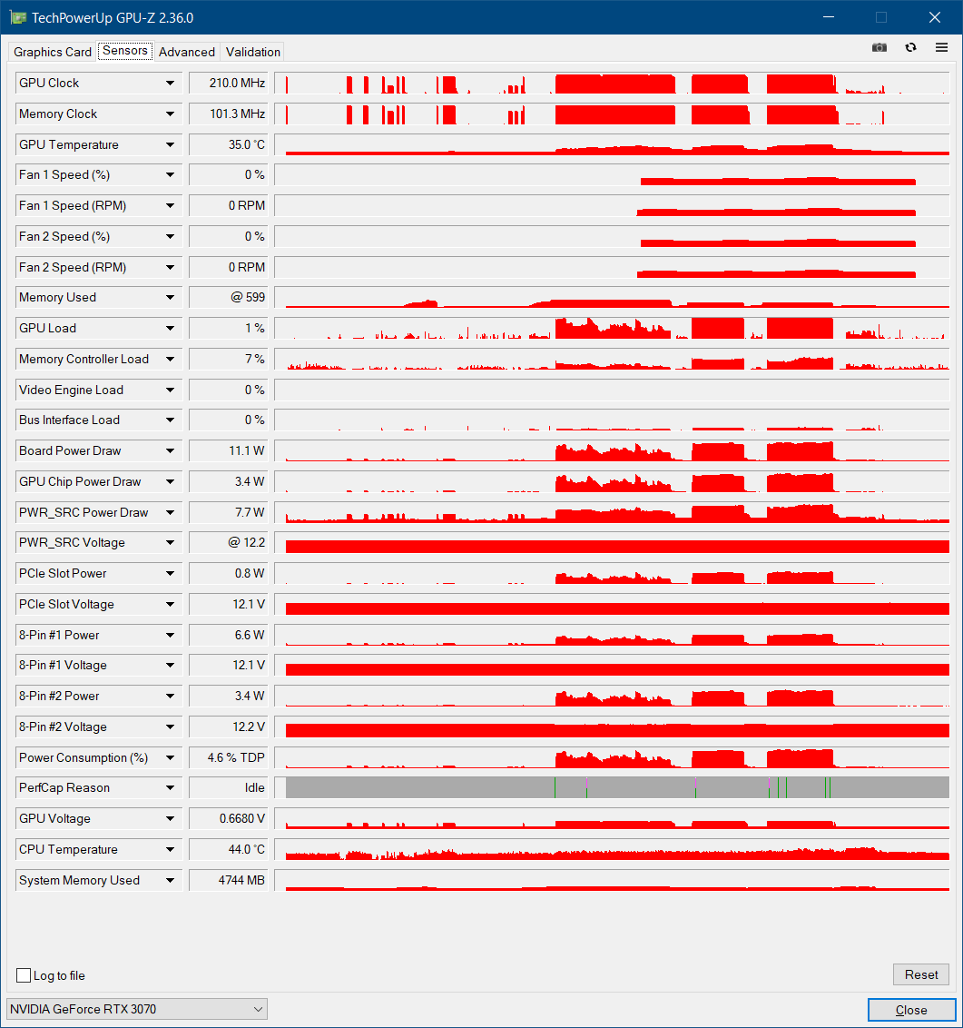

This is my GPU after running TimeSpy:

I still find that odd. His comment above the screen shot says it's after running the benchmark, not during. I can't imagine it says it's idle when the benchmark is running. What's it say during the benchmark?
I'm pretty sure thats normal. The gray perfcap is idle which you can see is while the GPU is under load.
