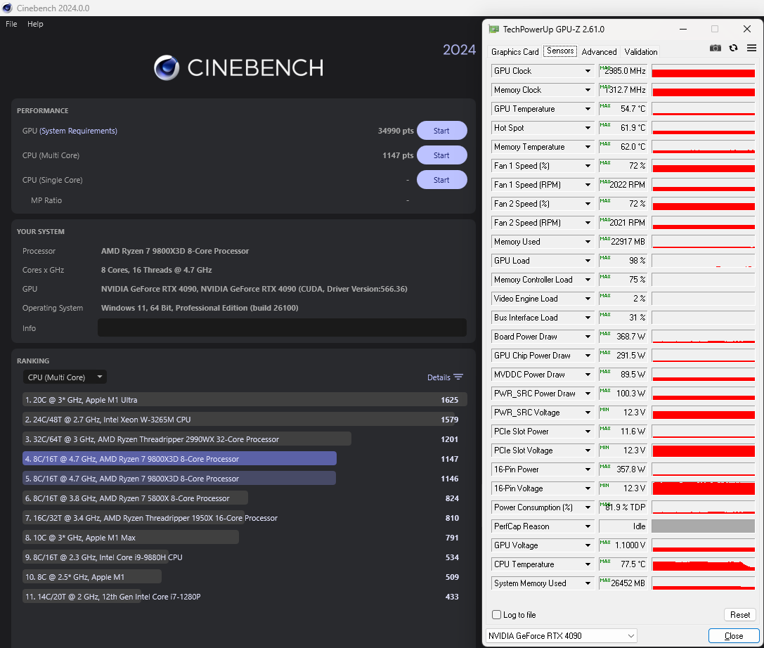

So I’m at 1383 in Cinebench multicore, every core pegged at 5,418MHz (5.4 GHz), max temp 84, max voltage 1.256. DDR5 6000 CL28.
I’m using Scalar 10X and a custom optimizer curve. -20 optimizer but i think i add another 10 to only mid and higher frequencies.
Am I on the right track and what is the best way to stress test it?
shouldnt multi be like 23k?
This is my first time using Cinebench, and I downloaded the 24 version which, based on my brief research just now, scores differently and lower.
ah. idk that one, yet. whats r23 say?
google says 1300+ is normal. so youre probably gtg.
He's using Cinebench 2024. Totally different point scale.

Using a Noctua D15S with 2 fans, My CPU temp stabilizes at about 71C in Cinebench 2024 multicore in a room that's 68F. So probably about 75C in a 72F room. You're a little hot, which could be either the cooler you are using, or the motherboard's default voltage settings.
Make sure you are on the latest BIOS.
Check the MB default VSOC voltage in HWINFO. When the Cinebench run is going VSOC is 1.212. If your board is pushing it to 1.25 or higher under load, try taking 50mv out. My board was overdoing it.
Also disable the iGPU in bios. No reason for it to be on.
