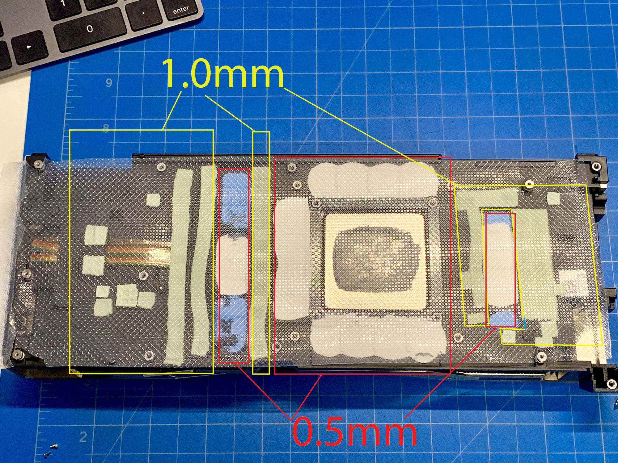

I'm hoping to put the stock air coolers back onto a couple of 2080Ti FEs. Is there a good source for replacement thermal pads for these?

I measured the pads from my new Titans. The thicknesses and layout should be identical to the 2080ti. Here it what I got:
Blue: 0.5mm
White: 0.5mm
Green Thin: 1.0mm
Green Thick: 1.5mm
You can get thermal pad material from Amazon for about $15 a sheet. Different cards will require different thicknesses, but the normal ones are 1.0 or 1.5mm.

The 2080 Ti uses three different materials for this. It has the normal gel pads for the backcover, a white material for the memory, and a blue material for the power. The gel is pretty straightforward to replace, but I have no idea what the white and blue are.

Hey I know this is a pretty old post now but man you're the only one who's ever provided measurements on these pads! So thank you for that! Did you also use 0.5 mm where there was that blue thermal putty? Thank you!
Yeah, went with 0.5mm there as well. I don't know why Nvidia uses blue & white materials there when the components (and therefore heights/gaps) are the same under both.
Hey yeah, thanks for the reply! I've heard that blue thermal spray is pretty cheap stuff.. so perhaps a bit of penny pinching here from Nvidia?... who knows. I have to put a second hand cooler on a Titan RTX and was just concerned about this bit. Thanks again!

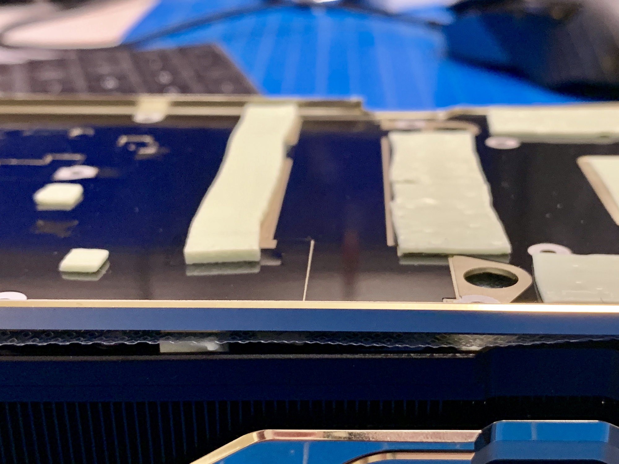

Just wanted to clarify thermal pad thickness for anyone trying to repaste/pad your 2080Ti FE, I used 0.5mm in the spots indicated above in the thread, and they barely make any contact. Had to use 1.0 on the memory to see any real imprint for the module, and for the inductors 0.5 had zero imprint at all. 1.0 has some imprint, but still pretty light. Would advise just using putty here as I think 1.5 would be too thick still?
For the other areas in the photo marked 1.0, those were accurate.
