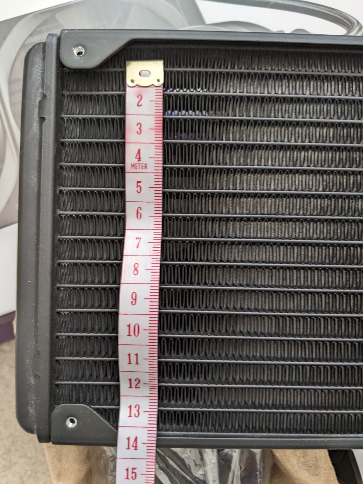

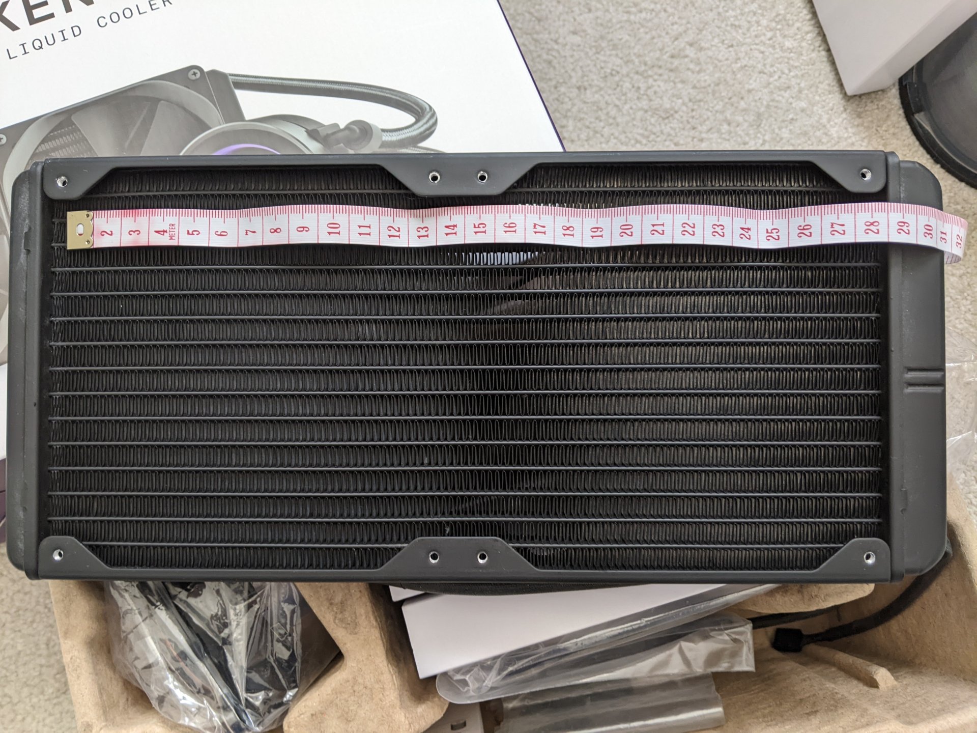

Each fan/mounting hole is spaced 130x130mm. There is a 10mm spacing between each fan, so 270mm x 130mm at the corners.
For those not in-the-know, a 280mm radiator is 90% the surface area of a 360mm radiator. It also uses 2x 140mm fans (as opposed to 3x 120mm) which tend to move more air at lower RPMs. Also, depending on the AIO you need to take into consideration the ends that extend well past the mounting holes. Some AIOs are longer than others in that regard. Typically, the end with the tubing is the longer end.
General rule of thumb is if you can mount two 140mm fans side by side with a little room left over at one end, you can probably get a 280mm AIO to work.
