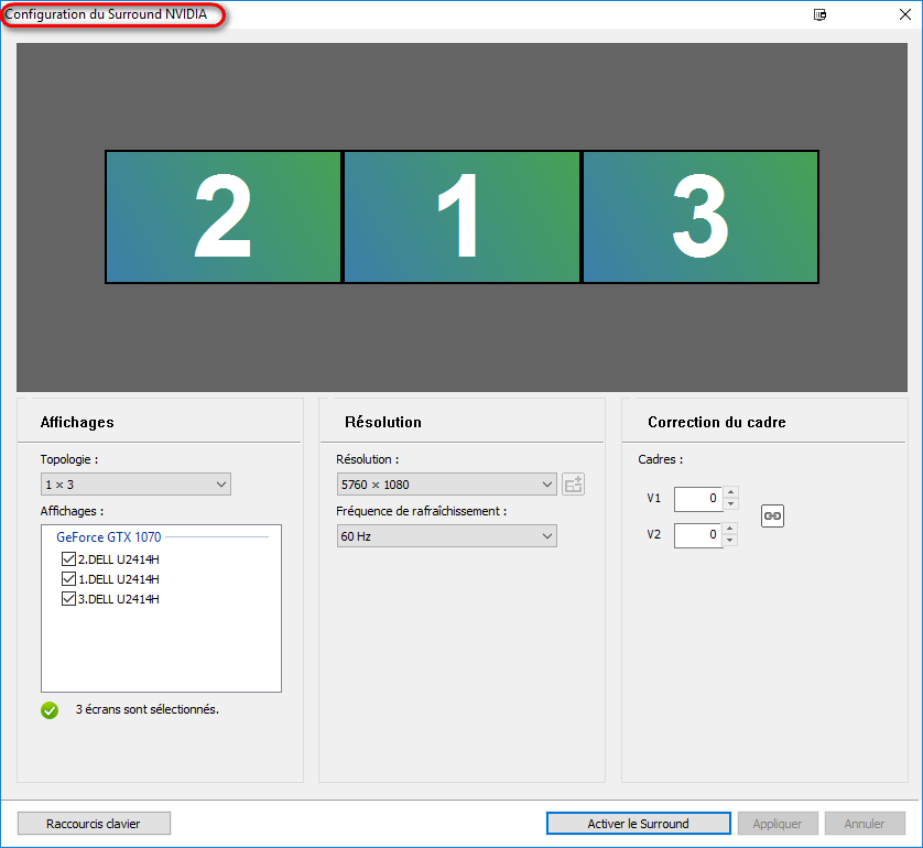

Hi I am trying to run this v11 tool on my GTX970 but it fails with CODE 401
What I see is that it opens the control panel for NVIDIA settings but then loads until the error appears on screen.
I changed the Topology=2 wich for me is 1x3
Any hints?

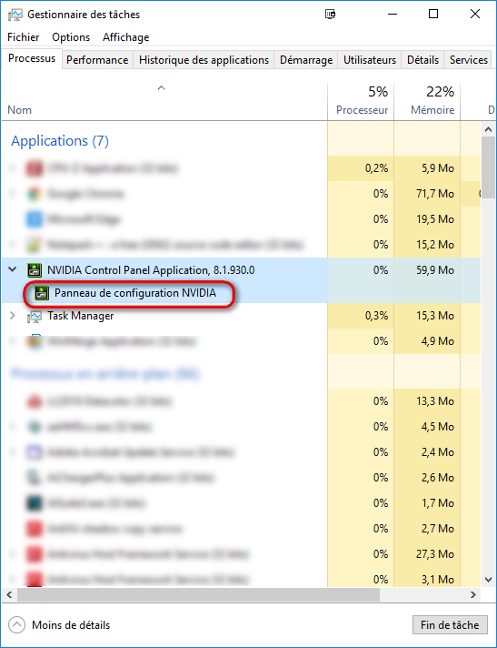

Like most of us all i had problems making this script to work as i got the exit code 401 with no response from NVIDIA Control Panel.
I got that The NVCP had to be in english to have it working.
So i ended up by editing the ahk script.
So first of all, you have to launch the NVIDIA Control Panel.
After that, Open the task manager and Locate the NVIDIA process. Expand it and write down the the NVIDIA window title as shown below.
This will be string #1
Then, Locate in the NVIDIA control panel the following window.
The string red highlighted will be string #2
The string red highlighted will be string #3

Search and replace in the script the string "NVIDIA Control Panel" with string #1 previously memorised.

Search and replace in the script the string "NVIDIA Set Up Surround" with string #3 previously memorised.

    WinSet, Transparent, 1, Configuration du Surround NVIDIA
Return

I have to mention that all my tests have been done with Windows 10.
I have no idea if the process should be the same with a prior version.
Credits goes to unknown for his hard work to make it possible.

Hey I followed your tutorial but I have now the erreor "Timed out while waiting for the NVIDIA Control Panel. (Code 602).
Do you have an idea what the problem is? I can't find anything :/

I use yor script slightly modified for a long time now and will say THANK YOU for this great script.
I searched for hours then until i found your script, it dont work on german system so i modified it.
I have get it to work, bot not perfect. Sometimes it works, sometimes not.
I have a german system, but have "set" my nvidia drivers to english and translate some windows names to german, then it works mostly.
It would be great if you can add full german support, I'll be glad to help you.
