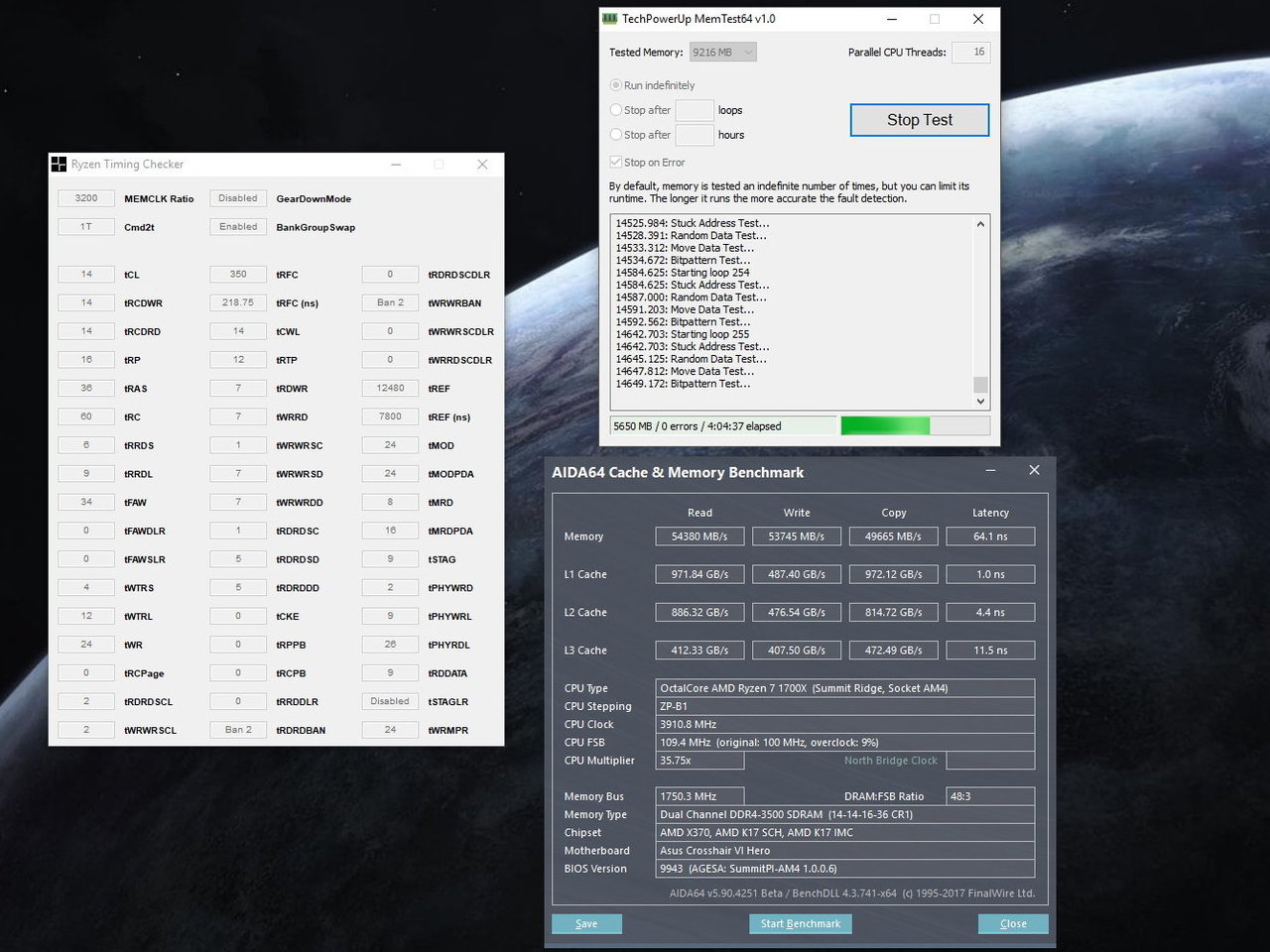

Been tinkering with some settings. I feel pretty good about this. However, I'd like to get the latency down. Any suggestions?
Not sure If Im doing this right but here goes
IF you're interested... The one we're using, is in "Tools" menu > "Cache and Memory Benchmark".
Click on "Start Benchmark", wait a minute or two, click "Save" to create an image, and voila! :D
Reason I am using the BCLK vice just 3466 is I get better results but more importantly it is stable. Messing around with CPU_SOC to move the memory hole to use 3333 was tedious to say the least, results were not good. 3466 results are similar to 3500, maybe a little bit slower but stability sucks, boot up issues etc. BCLK so far as given me a stable configuration. Now if I go above 110mhz on the BCLK my NVMe M.2 drive will not boot windows so I am limited to that. I wanted to use the 3333 strap and get to 3600 maybe but 3600 has been elusive to achieve and in the scheme of things is more just a number then anything meaningful.
I've done a clean install of Windows Creators Edition, fresh from Microsoft and going with what I've found as stable. Next is to install my custom water loop etc. and go for CPU speed which from 3.9ghz would probably not be much more and more wasting of time. But I will do that anyways :D.
I am using the most recent Aida64 Beta which gives more information on the bios and AGESA on the Mem and Cache tests.
Even when inputting all the same timings/subtimings from your 3200@3500 into the 3466, it still isn't stable or as fast? Tis indeed curious, if that's the case. However, we do know that there are some peculiarities with >3333 since most are having issues running that. Which, there are no doubt plenty of inaccessible timings that could very well be changing substantially and causing that, too.
Also, when you said "tCWL auto was 24 but was not stable going any lower so left that alone" what all had you tried? I suspect that the CHVI might be one of the boards Stilt was referring to about being 'broken', but in my own testings I found that, say a setting of 13 would run at 14. So my thinking is that if all you tried was a setting of 23, that may be a cause, as your RTC screeshot shows it at 14 and I'm wondering if it's not set at +10 in the BIOS which leads to values input not being translated as 'whole numbers'.
*cough* That, or it was just a typo and you meant to put 14... LOL Which, if that's the case, then nevermind! :p
While I doubt this is the cause, but I'm running on the Anniversary build of 10 (Ver 1607, build 14393.447), so perhaps somehow that could be influencing the memory/cache results on your system?
For what it's worth, I took a moment to compare our RTCs and noticed a couple huge differences between our configs (though, one can't ignore that you're running 167MHz faster than I am). These are MY settings with Yours written (shoddily) in red. The one with the exclamation point I had found interesting. (I didn't mark any of the others because they're the TurnAround timings and are on Auto, the rest I don't have access TO change them)
Worth noting I think that might help your speeds: tWTRL and tWR being lowered if you can. The GearDownMode, if it helped with your stability then fair enough; however, from my reading of the AMD blog it sounds like it might be better to leave it Enabled. Lastly, just a theory, perhaps your tWRRD (exclamation point) being so low is not providing enough time for other latencies to finish their tasks? After all, you CAN tighten certain ones too much and cause performance to drop.
Lastly, I did notice your overall AIDA version. I doubt that's the cause of the performance difference though, as in my testing of using the really old version's BenchDLL files in the new one, the results were the same as using the old EXE version. I will agree that having the AGESA readout there is nice, but on my board the string still reads 1.0.0.4a so... would be a bit misleading. (MSI did release a new Beta last night, and visually I saw no changes, so I assume it's all under-the-hood stuff... maybe like AGESA string being updated heh)

Frankly? Your timings are 'fine', as in normal and expected, from my experience. The only thing I can suggest for lowering them, which would only result in 1ns or maybe 2ns, is overclocking the CPU. Otherwise, your latencies are what I was getting before I did the SCL @ 2T (which you've done).
Awesome, a lot of those settings are what ASUS XMP which they call D.O.C.P (may have that wrong) set at standard. The variance is huge but I am not sure how significant that is. I guess the best way is to backup windows, create restore point and try some of those numbers you have. ASUS maybe way out to lunch on some of the settings or they have to for whatever reason set some of those values there. I don't know.
Maybe take them one at a time and run down the results but to ensure each one is stable I can only do a short test and once everything configure the long 12+ stability test. Then again how much real difference would all of this make in anything other than some benchmark numbers? I really don't think that would be much but my curiosity is getting the best of me.

Something Chew* had told me though, is that with memory timings, different models of board will differ a lot on what they'll be able to accomplish. Some of it I understand the reasoning behind, as traces no doubt make a world of difference. However, he was also saying that timings associated with them (I assume that we can't see/adjust) are also affected a lot differently between vendors. Where one might have a lot more relaxed than the other, which in turn will let you tighten up certain timings way more than what the others are capable.
Regardless, I still believe in sharing settings since it at least gives people like us something to TRY, even if it doesn't work. It also still can provide a learning experience, not just about DRAM, but also about what our boards and components are capable of.
I'd love to test out what impact there is on games, but I'm in a slightly unique situation with internet where I can't download anything I want, it's on a 'need' basis. The games I do have, will require me to do some registry editing in order to get Steam to think I've re-downloaded and installed them lol (It's all legal, don't worry. They're my games from my own library, I just don't have the luxury of re-downloading them, so I have to copy them from system to system and import registry dumps)
Still, there's a few GB/s between our configurations on the RAM side, and a heck of a lot more than Cache side, both of which I can only imagine would benefit SOME games in terms of performance :D

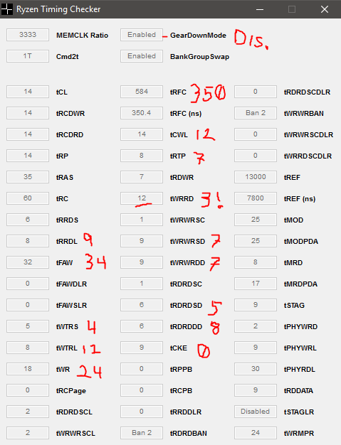

Formula 350:
Have duplicated your settings (the ones that can be adjusted) except remaining at 3500mhz using 3200 strap and BCLK. So far so good. Some improvement with speeds but no where near what you show. I was amazed that at 3500 I can have 14-14-14-14-36 with tCWL at 14. Maybe MSI or you figure out a good combo. Anyways stress testing now.

Formula 350:

Formula 350:

Except your bios settings work, since I have a few days off I will dive back in to see how far they can go. They are sufficiently different then ASUS settings to be rather interesting.
Edit:
Your settings worked for about 96min with MemTest64 while playing music, playing videos/web browsing computer screen went black and then blue screen. Tried a few modifications but they failed even faster.
Went back to mine and modified a few settings particulary tWRRD and it lasted 4 hours of MemTest64 and other stuff and gave good numbers in Mem&Cache benchmark. Could not post an image here not sure why. These are just numbers unless the better numbers reflect anything substantial in other programs, we maybe just chasing after the wind, so to speak.

Sure they work, mostly I think. :p I've yet to truly vet my system with any semblance of stress testing besides a few minutes with AIDA's Stress Test. However, I'm encountering many instances of it being "pretty stable", but seemingly not enough where and when it really counts.
For example, the system seems to be pretty stable at 3.8GHz with auto volts (and, just to be clear, I always try to state CPU speed in GHz, and RAM in in MHz), but then yesterday it just randomly crapped out, as well as SOMEtimes will flake out when resuming from Sleep. Also I set CPU to 3.9GHz and still on the 1.35V, which ran for over an hour on AIDA's CPU stress test, pulling 145W package (125W 'actual' according to HWiNFO readings of Volts x Amps = Watts) but only putting out 60C (40C on Tdie). Then ~5mins after turning on the FPU Stress test (while things were still running on CPU Stress), it failed. Interestingly the package consumption had dropped to 133W (I think 'actual' remained the same) and the TEMP rose to 83C (63C Tdie), so who knows if that's the reason or not... I still don't trust these temps being at all accurate as I know my Water2.0 PRO is more than up to the challenge since it's the double-thick radiator.
Either way, in embarrassing honesty, I'm not being a thorough overclocker and making sure things are stable first. :oops: I let the 'uber-but-false' scores with the increased CPU multi in Windows distract me from my RAM work, so really I need to get back to that before I even start trying to increase CPU and find stability with it.
As for mine not working for you, as I had mentioned that Chew said, the board designs will result in different timings being possible, as well as the BIOS configuration for hidden values we can't access. One can still use them as a reference, though, for certain. Problem though, becomes a matter of "which timings end up having a relation to each other and should get adjusted at the same time" or if not a matter of being changed at the same time, perhaps one of "which timings should always be within XX ticks from each other".
In other words, you 'adjusting' mine and things failing faster may be a result of you adjusting Timing X, but should've been adjusting Timing X and Y.
I'm going to see if maybe Chew will be willing to divulge whether or not there are certain ones like that.

Managed to accidentally(!) boot at 3200cl14-15-15-15...was dialing in procodt at 2933 with tight timings, changed multi but forgot timings. Unfortunately memtest unstable (lots of errors), but fun none-the-less. Loosening secondary timings doesn't help, so must be just a bit too tight for these chips.
Fwiw, procodt is good between 48-80 Ohms on one stick and 48-68.8 Ohms on the other (both set to 60 as that's close as possible to middle on this board). Both Hynix single-rank from a dual-channel kit.
I wouldn't recommend using the PSU switch, as that bypasses any firmware control and may leave you in a bad state (though a cmos reset may help recover in that case). Just hold the power button for 3-5 seconds. ;)
Having said that, that is really weird.
So I actually ended up doing just that - holding down the power button for 3-5 seconds before booting up again. Since this new 1401 beta wasI applied, I get prompted to enter the BIOS with a message indicating that I shut the machine off via the power button and would need to check settings (something of the like). It's at this stage when I'm in the BIOS to check if my setting stuck, and that's where I come across seeing it reset back to 'Auto' for some reason.
