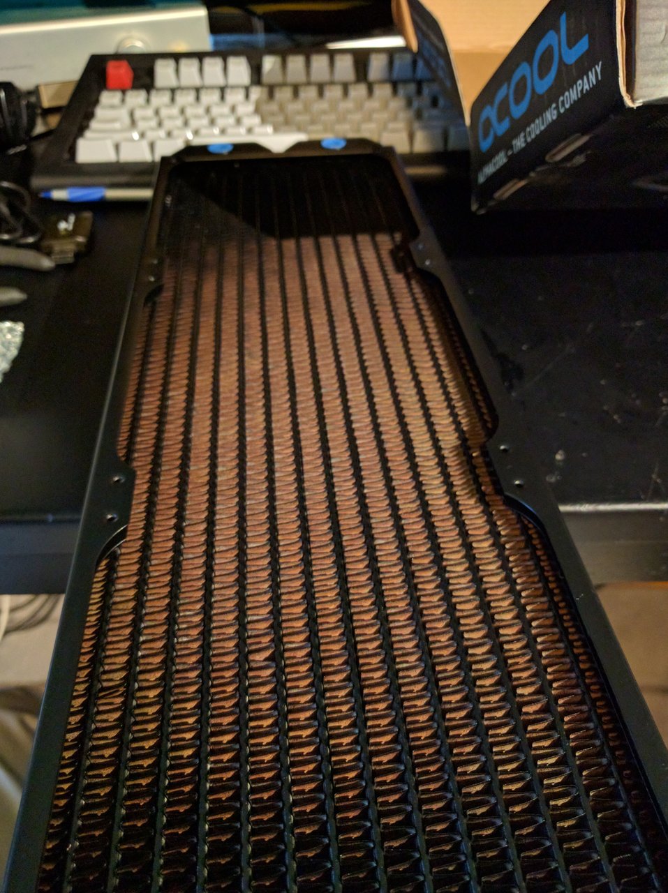

Every radiator I've bought had been painted on the outside, but the fins are bare copper.
I mistook it for rust when I first got them:
That's the opposite of the rads I have owned. I have 3x 360mm rads now - one an XSPC EX360, The next a Hardware Labs Nemesis 360 and the third a Chinese no-name copper rad. All of them have painted cores and there are literally dozens of reviews out there for the first two that show they have really decent performance. So honestly I am not all that sure if the paint takes performance way. I haven't ever had any problems with painted core fins.
