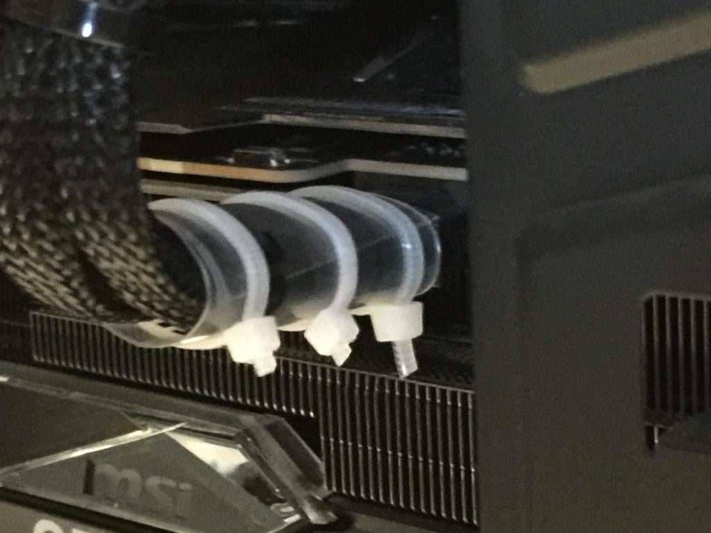

Same, made sure connector was clicked and tight as possible. Just checked MSI 4090 Suprim X (Air version), looks fine as well after a week of use. Though I have a frame limiter of 117fps for G-sync so maybe see 70% power draw (around 330w) most of the time. Pretty stoked with it so far, going from 3080TI to 4090 and overall case temp and noise has gone down considerably. Some games had to bring alot of settings down to get 80-90ish FPS with 3080ti (Forza Horizon 5, Halo Infinite), now with 4090 just put everything at max and pretty much at 117 limiter all the time.
Specifically picked this model as one of the few that height was around 137mm (FE) to 142mm allowing around 30mm clearance for O11D Evo mounted horizontally. Helped the connector is recessed a bit.
