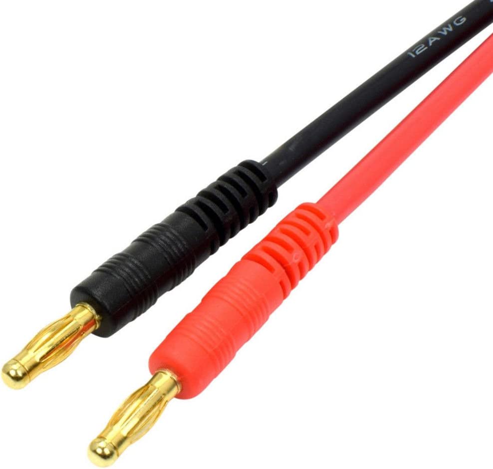

Unless the PCBs inside that thing are encased in resin or some other water impermeable barrier, and the connectors don't see any liquid, I call complete BS. There's absolutely no way you're pushing thousands of watts though a motor or PCB that's had liquid ingress, especially salty liquid. That thing will corrode in a matter of seconds.
I've worked in the AV world, and film projection world. We have cables carrying low voltage high amperage DC. Xenon arc lamps are DC devices that operate in the thousands of watts envelope, and I've seen those have spectacular failures with very beefy connectors because of the issues I cited earlier.
I'm sure the loads you work with are more constant than what happens in the RC world. They also don't move.
I have a 1/10 3s buggy myself and can attest to the hundreds of amps and harsh environments these connectors can handle and also haven't had one fail or deteriorate to warrant replacing.
Also what was missed is that also comes with amazing airflow over everything, considering these RC cars are moving in excess of 55 MPH so not super comparable to stationary things other than these connectors can take insane abuse.
And then there are RC boats...

If all of the 12v pins are connected together anyway, then what is the point of using 12 pins (not counting the 4 sense pins)? Why not just two large robust connectors, one positive and one negative? That's basically how every other 12v device in the world works. Something like this:
Brings to mind the old saying: "Keep it simple, stupid"
They have to work with regular ATX power supplies, so at some point, you'd still have to adapt the 8 pin power cables to the single terminal style. Seems to me that the answer is to get your hands one of the proper cables from your power supply manufacturer, or to upgrade to an ATX 3.0 power supply, which I gather is supposed to just come with one.
Not everything uses the two fat wire solution, though. It's pretty common for aerial surveying equipment (camera systems, lidar, etc) to have three positive (+28VDC) and three negative wires that add up to a nominal 50A capacity. I don't think it's a standard, but there is one particular Amphenol bulkhead connector that gets used pretty commonly, and I've seen it in more than half of the survey aircraft I've installed in.
Got a 6S kraton and the motor can peak ~3KW. Soldering connectors for that isnt fun haha. Think they should just hang a XT90 connector off the new rtx cards.
