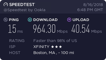

Saw a couple reviews where gigabit for internet was around 550.. multiple reviews saying this? Just want to make sure I got the right stuff.. currently Im only doing about 250 down.

AFAIK the ER-X is good well past 250 Mb/s provided features that disable hardware offload are not being used (e.g., netflow, port bridging/bonding, the full list varies by model)

You really do only want to use an ER-X for basic firewalling, routing, and DHCP. And it is limited WAN to LAN and back to ~500Mbps by the connection between the CPU, which does the routing, and the switch chip, which runs the ethernet interfaces.
