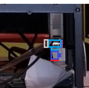

This is what I would do.
Between Rad and T (PURPLE)
https://www.amazon.com/XSPC-Male-Fitting-Black-Chrome/dp/B00V174E1W
T (your link above) (LIGHT BLUE)
https://www.amazon.com/dp/B00CSTLCVW/ref=cm_sw_r_cp_apa_ta25BbZ2XGPHH?tag=hardfocom-20
Tube fitting, which you don't need to buy. You are just moving where it threads into. (your link above)
https://www.amazon.com/dp/B077GY6CBN/ref=cm_sw_r_cp_apa_D925Bb367CAB4?tag=hardfocom-20
Ball valve off bottom of T (your link above) (DARK BLUE)
https://www.amazon.com/dp/B01H4EIS4O/ref=cm_sw_r_cp_apa_3925BbGW69NVR?tag=hardfocom-20
Plug for insurance on the ball valve (RED)
https://www.amazon.com/XSPC-Plug-Black-Chrome-4-pack/dp/B01H0KWWS0
Fitting you already had in the radiator. (GREY)
Links aren't necessarily what to buy or if you even have to buy.

I don't know if it's the picture angle but I would still be concerned about that left gpu connection. It looks like it's coming into the connector at a 45. With the loop, I personally wouldn't want all the fittings pulling on compression fittings. To me, not worth the risk. If you are able to secure the drain to the mid-panel, you may be able to do it without draining the loop by pinching the tubing closed on either end. I would still move the pump if that tube is actually coming into the GPU on a 45 though.
It looks like I might need two male to male fittings, the first link, to connect the t fitting and ballvalve, ,because the value and t fitting and both female to female. Am I seeing that correct?
you should only need to connect three normal fittings to the t , then a short run to your ball valve then a single fitting to the ballvalve, then cap off the other end. i used some old 1/2x3/4in barb fittings i had lying around for the t and ball valve. they are cheap and with a worm drive clamp they will never come loose. argh, i tried to take a pic but my crappy phone wont work right. ill post a pic if i can get it to work.
