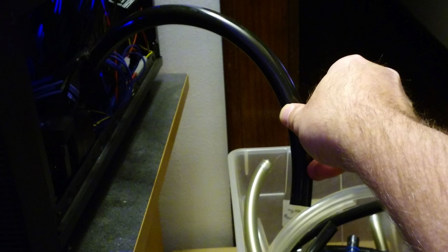

or put your rig on the edge of your desk. run the drain and t down into the psu shroud. with the drain pointed towards the side of the case. connect a extra piece of tubing. open the valve and hold the bucket :D done, i may have to tilt the case forward once or twice but it will usually drain completely this way. heres a rough pic of what i mean. 20181113_120240.jpg
or put your rig on the edge of your desk. run the drain and t down into the psu shroud. with the drain pointed towards the side of the case. connect a extra piece of tubing. open the valve and hold the bucket :D done, i may have to tilt the case forward once or twice but it will usually drain completely this way. heres a rough pic of what i mean.View attachment 119777
