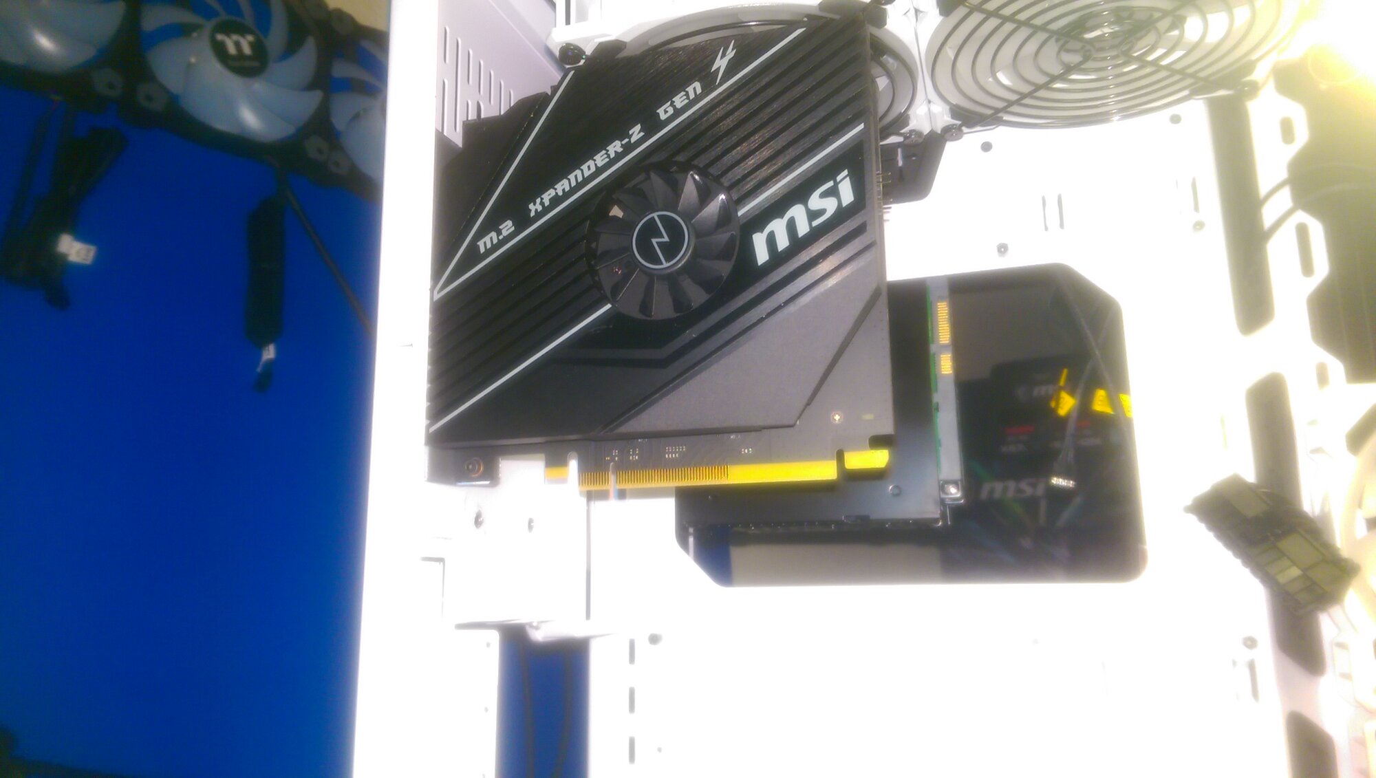

Small Update:
M.2 Expander card installed in the space above the Video Card. Had to remove the slot cover mount from the card and 3D Print a replacement which has no 90° bend so it can be mounted directly to the slots on the back of the case.

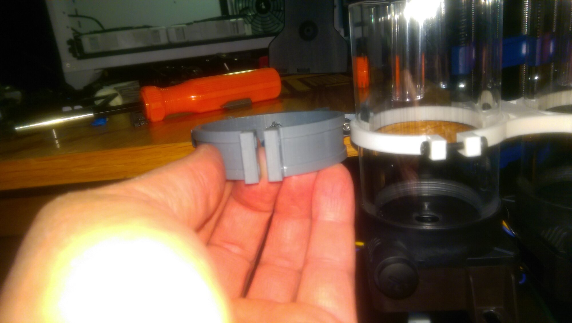

Here's the single pump mount compared to the re-designed dualk pump mount. The new mount is done in ABS and is less than half the size of the original mount
It works fine so far and I've slapped around the reservoirs/pumps to see if the mount would fail but it's fine. The new version's mounting method is a bit different...more on that later
Small Update:

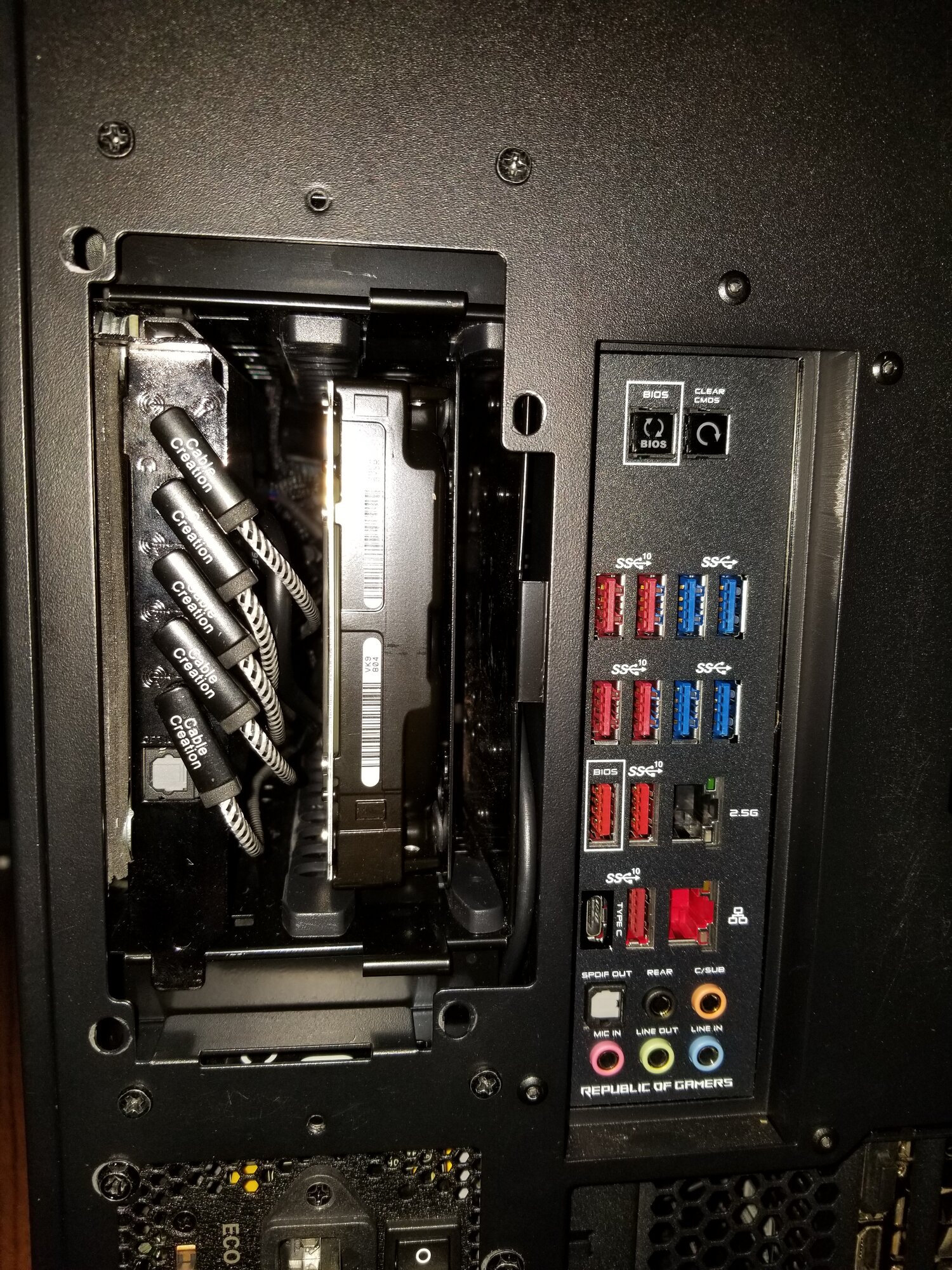

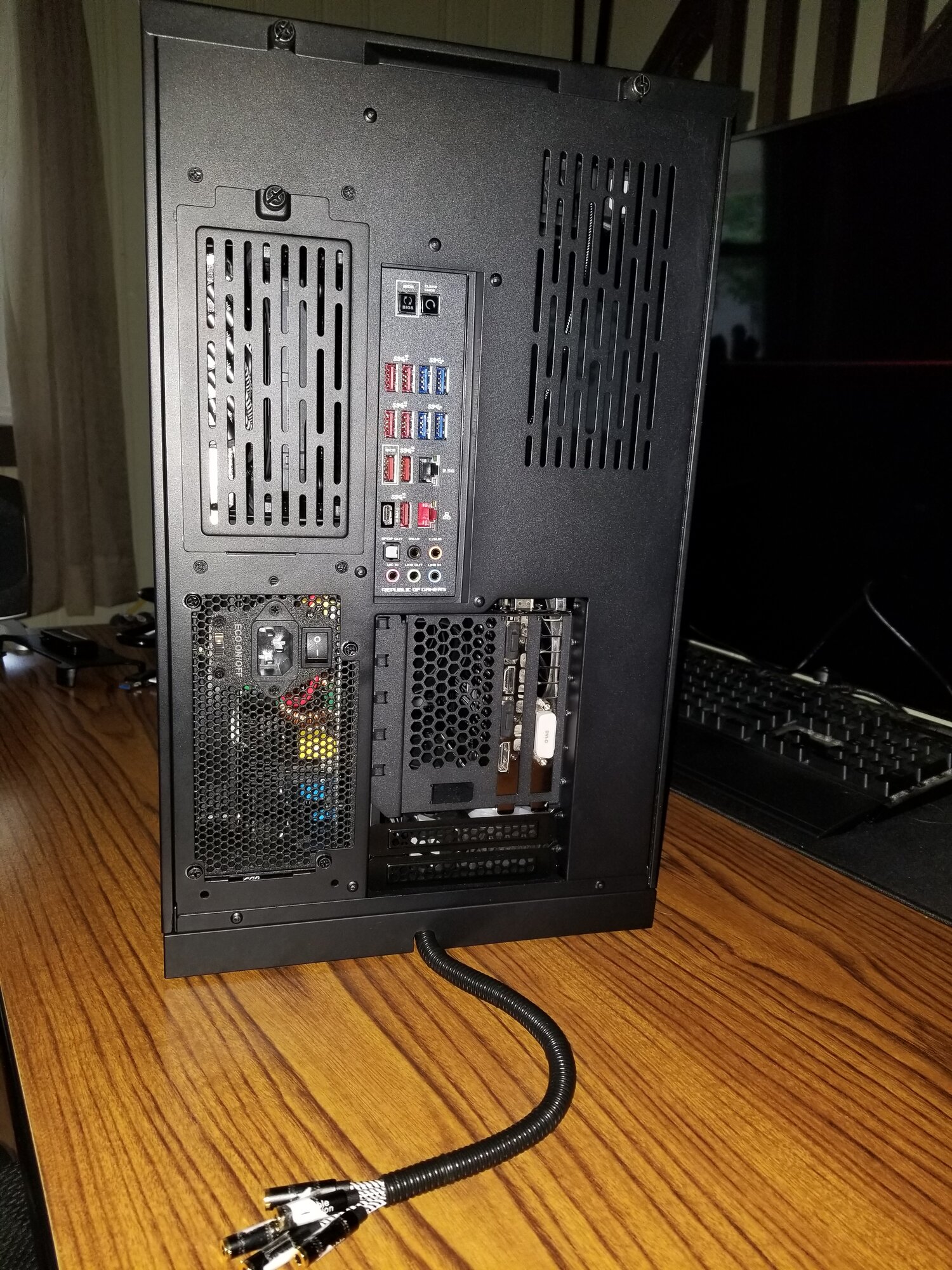

I'm finishing a new build and have run into a few snags.
The 1st being that the HDD that I'm trying to install behind the back panel on the vertical brace/case support/wiring hider doesn't fit. It probably has to do with the PSU that I chose but I wanted to pass this along to others. I'm using a 1,000watt psu so it's a little longer than normal and when installing the hdd the sata power plug bumps into the psu and prevents the mount form being attached to the case. I tried every orientation that the predrilled holes allowed with no success. I think I'm going to have to mount the HDD to the top of the case (drilling required). I removed the HDD cage that comes installed as I needed the space for all of the Corsair fan and rgb controllers and room for PSU cables and extensions. Resolved - I ended up being able to install the drive in the drive cage after all so this initial problem was negated.
The 2nd issue that I encountered is that I can barely get the glass side panel closed as it's pushing against the power cables for the graphics card. I am using an evga 1080Ti FTW3 so it is somewhat of a taller card. I think I could leave it this way but I don't like the idea of it putting stress on the connectors. I ordered the evga powerlink to see if that will resolve the issue by moving the plug location to the side of the card, hopefully it's not too tall with the powerlink attached. - Resolved (post #18) - Powerlink with the card was too tall, ended up going vertical mount.
The 3rd item that needs addressing is I'd like to install a sound card but don't have room due to the vertical gpu mount so I'm looking at other mounting possibilities. - Resolved (post#46) - Installed the sound card in the HDD cage.
That's all but I figured I'd share a few experiences for anyone looking to build with this case. I love the looks and build quality of it and I'm quite sure I can remedy the problems I've encountered but I wanted to pass them along.

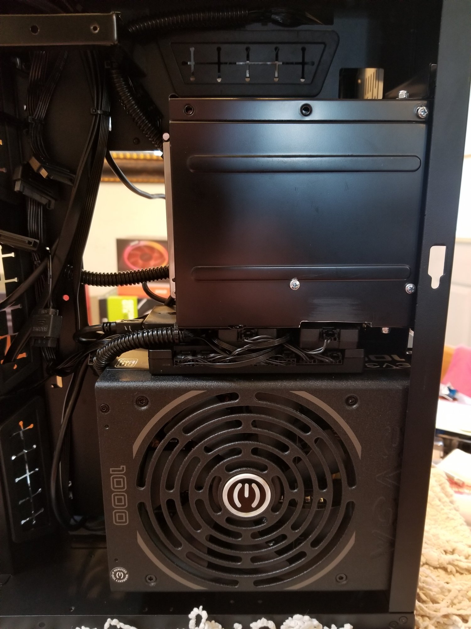

Could you please explain to me how you installed your power supply in the case.
I'm starting to wonder if I got a counterfeit case because the top doesn't come off.
I have a 1000 W E VGA power supply and I can't get it in for nothing
I'll do what I can but I had no issues at all installing mine :confused:

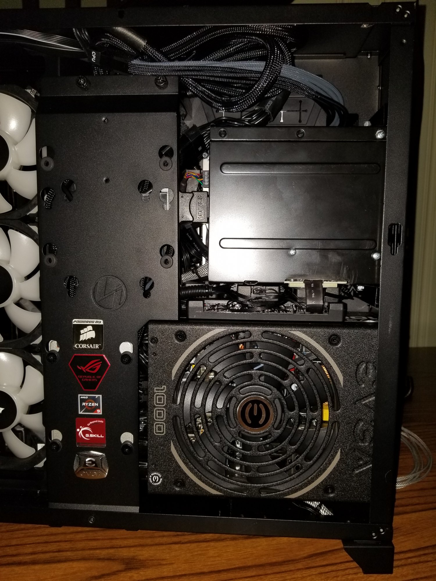

Here are a couple pics of mine and a youtube vid showing exactly how I installed my psu.

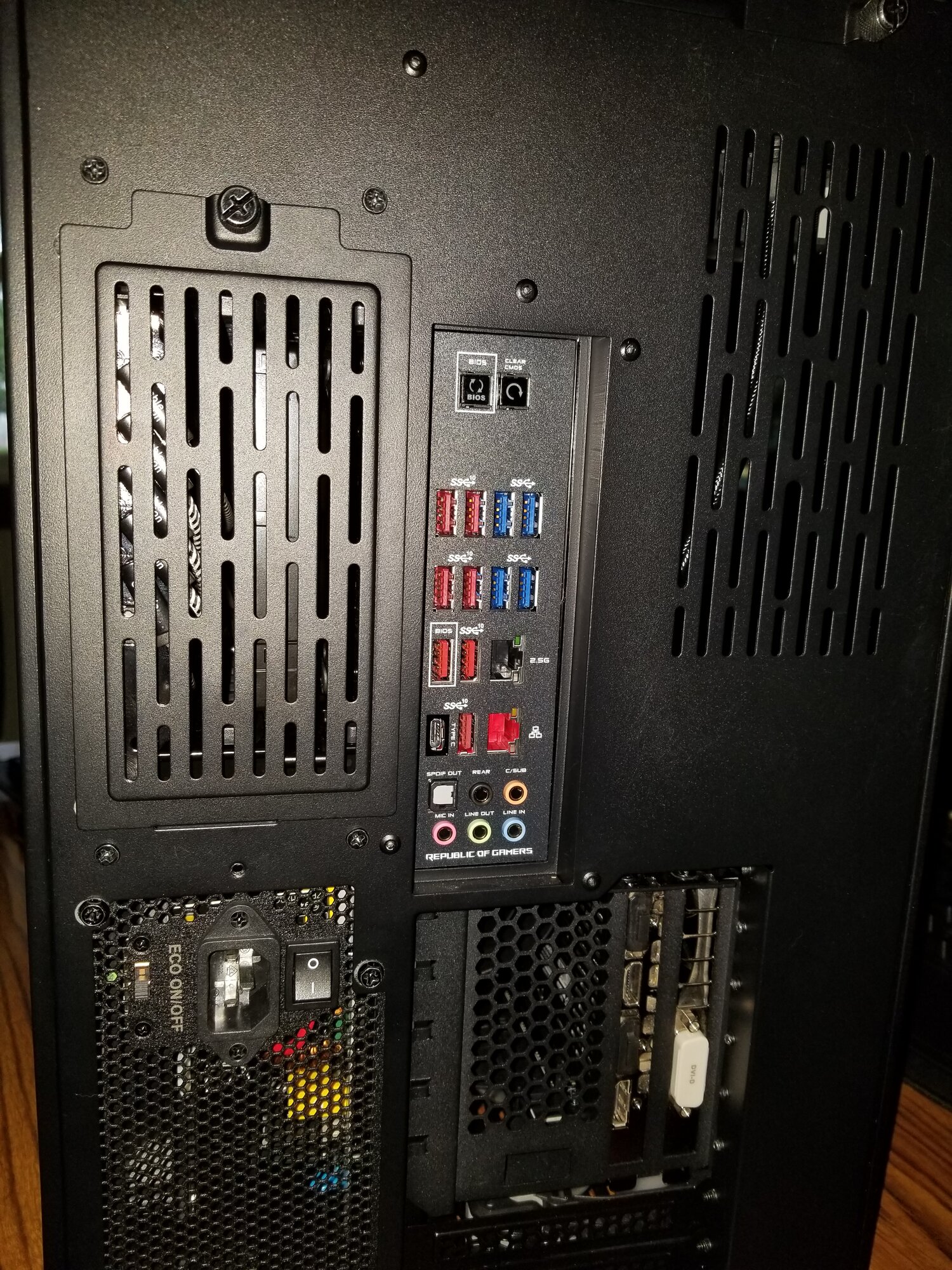

Top panel doesnt appear to come off. Its riveted. There is a metal panel that wont come out . There are tabs that sink into the bottom and if the top would come off i could remove the panel and install the power supply.

It looks like you got one of the Lian Li PC-O11 variants, maybe? There are several O11 variants... There is the O11 (no removable top, I think), the O11 Dynamic (which Daphatgrant and I have), O11 Dynamic Razor (which has integrated lighting), the O11 Dynamic XL (a bigger version of the O11 Dynamic with some integrated ASUS ROG branding and lighting), and the O11 WGX (also a larger case).
The point is, check your box and see which exact model you got.

Top cover should slide off towards the back after you pull BOTH side panels off. The side panels lock the top plate on, which is a thin, metal cover that sits over the fans.
Well I guess we figured out why the case is different, lol. Don't be distressed though the XL is a great case, just has more room.
In regards to the PSU, the vertical panel in front of the PSU should be able to be unscrewed and removed.

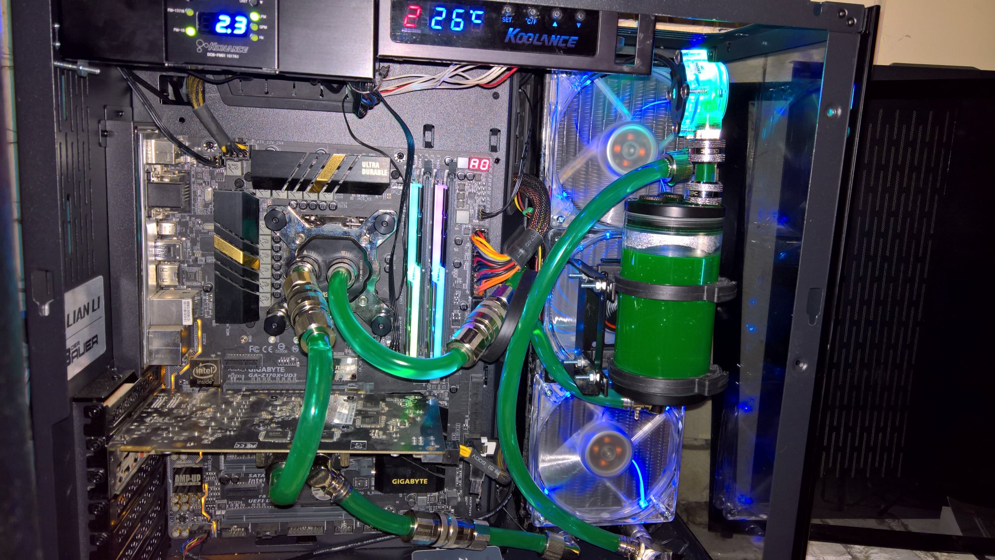

In my O11, that bracket is where my Koolance electronics are mounted. I had a Koolance RP-1000 5.25" bay pump/reservoir where the reservoir had cracked. Rather than replace the reservoir for ~$40, I gutted the electronics and the pump and connected them to a $25 stand-alone reservoir instead. Worked great until the PMP-400 (Koolance's name for the DDC pump) died a year later. I replaced it with a D5 and it's still chugging along. I was sad the original pump die, but in fairness, I got over 10 years of near-continuous service out of it.
Here is a picture of the system as originally built, with the Koolance displays front and center - the pump and control electronics are in the other compartment on that bracket, and with the glass on (and without flash photography lighting it up), you can't see the wires running back there at all.
